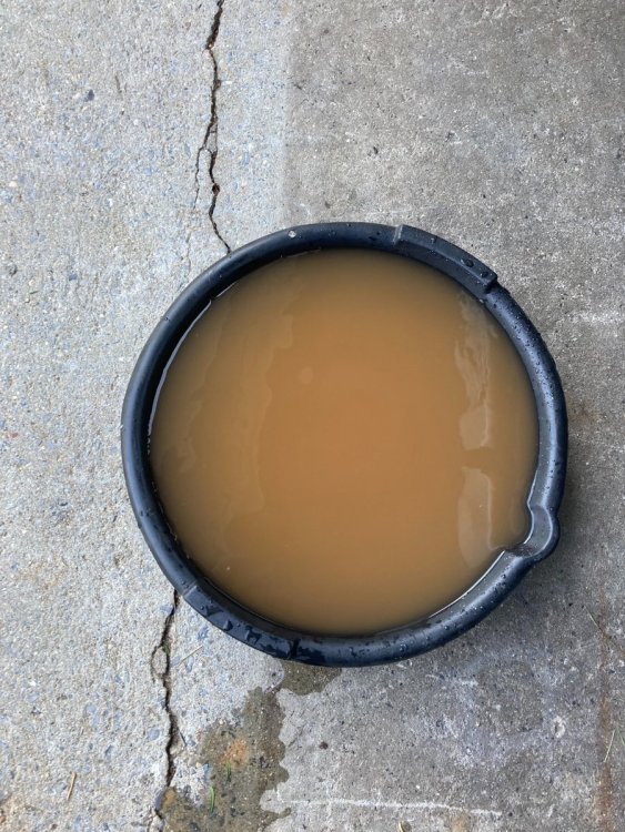

Current dump

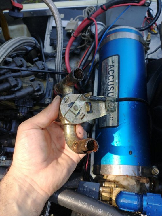

Heater valve is shot

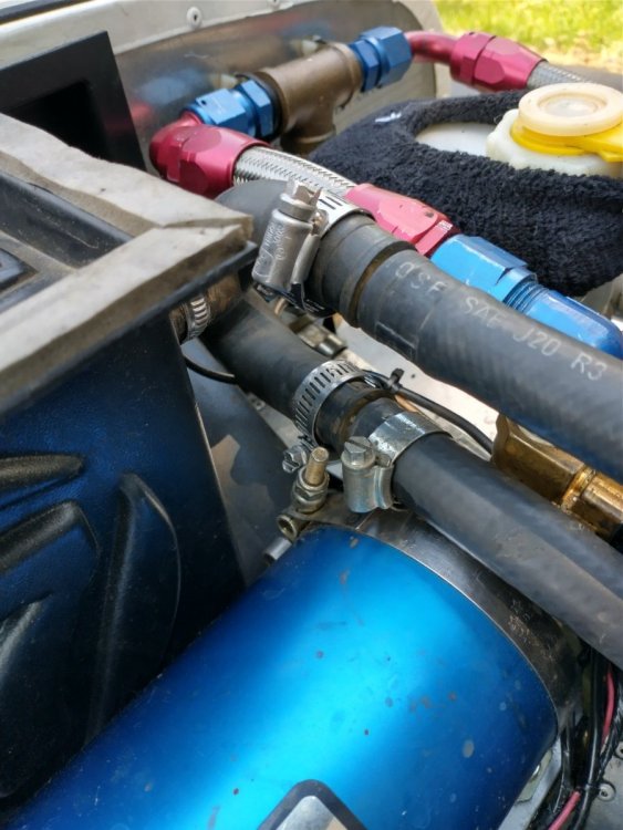

Replaced heater valve with hard unions for now

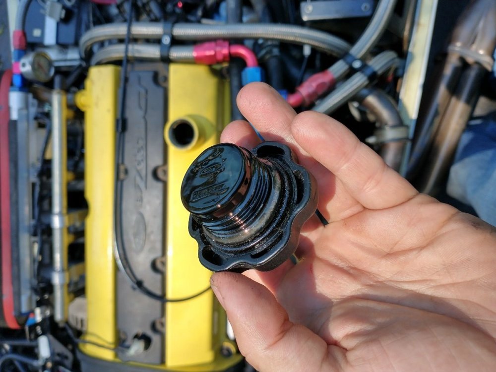

Oil cap. No obvious residues
That brown at the bottom is more dirt than anything

Hose flush
Nothing really happens until 6:15. Volume expands a lot while we are still below 80 degrees. This is typical for me every time I've been doing this. Not certain if this is normal.

16 minutes ago, Vovchandr said:
2) Corrosion found in Heater valve. Completely removed and hard connected right now to partition it out. New one is on order.
3) Everything is flushed with hose until clear.
Results:
1) Ran it until hot with extra tall funnel without pressure. Things stayed relatively clear and then started to expand greatly towards 80 degrees and overflowed again. Likely a normal result. Shut it down and closed cap off (topped to the max)
2) Drove it to work just a few miles. Seemed to run alright. Went to restart in the parking lot and was struggling to start. Pulled around the building and temp climbed past 80 into hot territory and spilled out passed cap when shut down. Likely overfilled and also expected?
Pending:
More driving to see get the air to collect in expansion tank and see if color of water changes.
I think this is encouraging.  Given you had so much sediment the other day in the video, I suspect you have corrosion elsewhere - block and water pump.  That fact you got the liquid clear is an achievement.  Lets see what happens after some running as to whether it stays clear.  If not then more work to come.
You may have overfilled it.  It could also still have air in the system needing bleeding.   More testing to know.

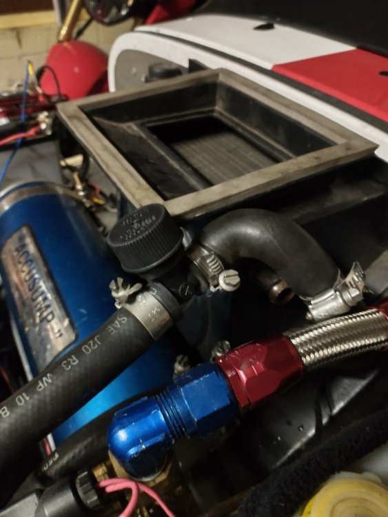

1) installed the heater T bleeder fitting and bypassed the heater. I'll play with the loop to get it to sit lower.

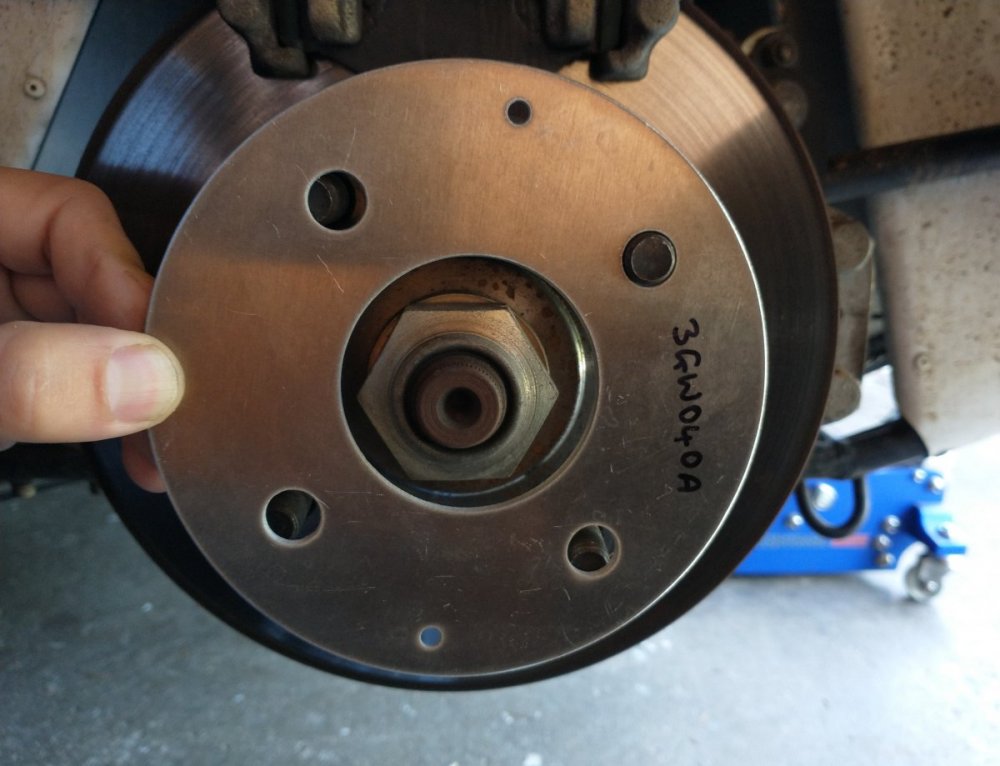

It appears 160 wheels have a different lug pattern. For those wondering about CC spacers
I'm look more into TStats for Zetecs in meantime.
