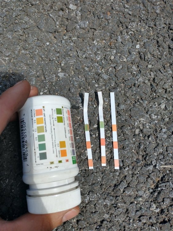

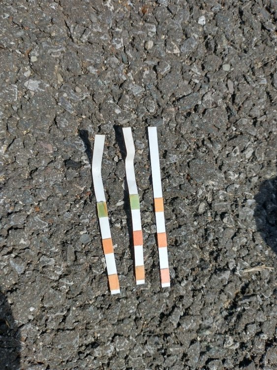

I did two tests back to back. The third strip on right is control untouched.
Only pH seemed to have changed to green. Making it high pH

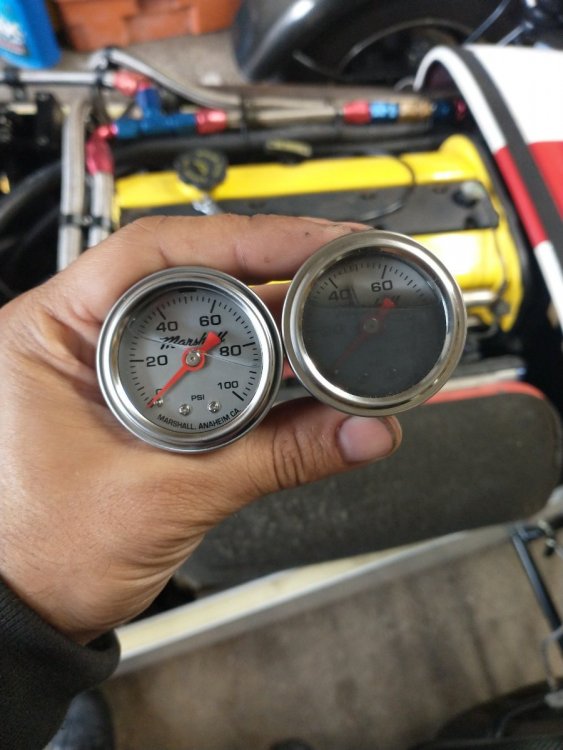

Got my new fuel pressure gauge in.

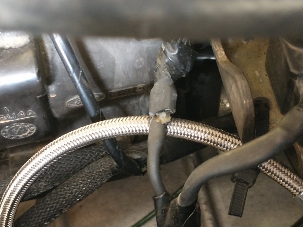

Was going to take the car to the shop today, got all strapped in go to start it and it cranks, and cranks and cranks. Turn it off, turn the key and I hear the fuel pump. Sounds good. Go to start and more cranking and cranking and cranking. Think back to driving it back yesterday for total of 60 miles and starting it late at night to pull it into garage, all was well. Frustrated took another car to the shop (had other business there). Thought to myself maybe the head gasket actually went completely and won't compress on Cyl1 or along those lines.
Went back home and retraced my steps. Last thing I did was unplug the wideband from the spare fuse to troubleshoot erratic jumping rev counter. Lo and behold, blown fuse. Put a new fuse in, go to crank and I see sparks in the engine bay. Peculiar. Take a look to find that my ignition coil wire was rubbing up against my slave cylinder remote bleeder braided hose and making contact/shorting. Separated the two, wrapped new electrical tape and hopefully problem will be fixed (it's raining can't go out for a spin right now). Car starts fine! Small win, I'll take it. It was very frustrating to drive with and until figured out could have been a symptom of a bigger issue.
Erratic RPM's shown below

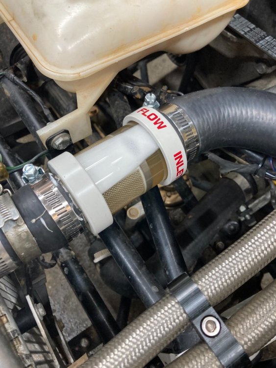

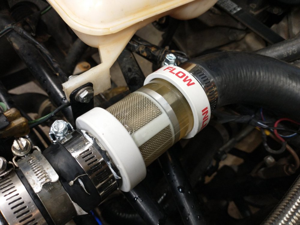

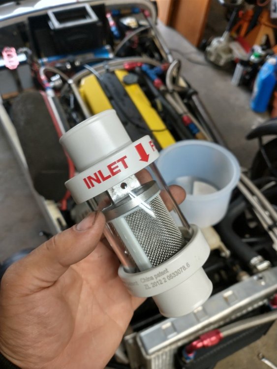

Also my coolant filter came in. Interesting unit. Looking forward to testing it. Bled the coolant again to install. Some minor browning visible. I know I still have a source with my coolant rail inside being rusty, possibly flaky. I don't have any good replacement sources right now, but I'm sure I could source something if needed.
Installed the unit and did another round of pressure testing. Everything good.

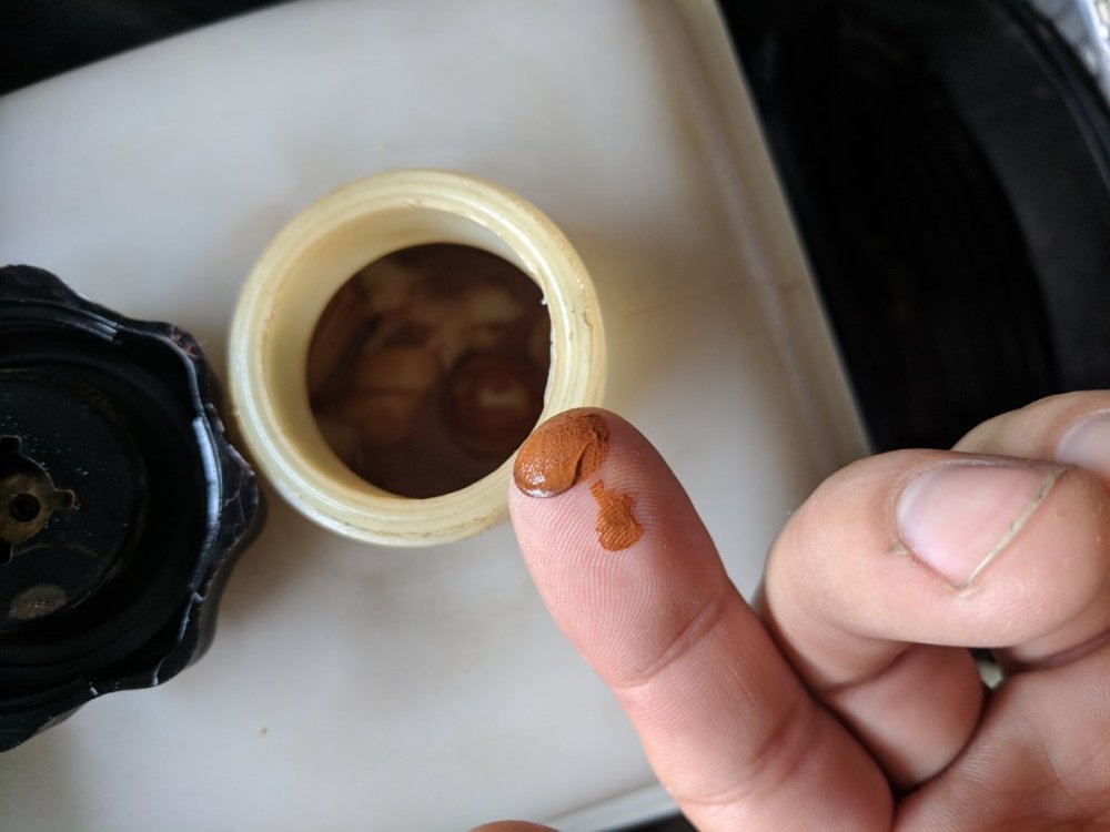

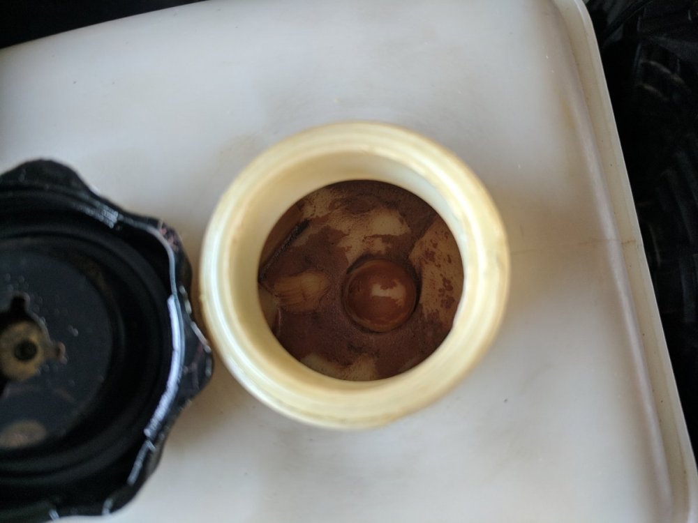

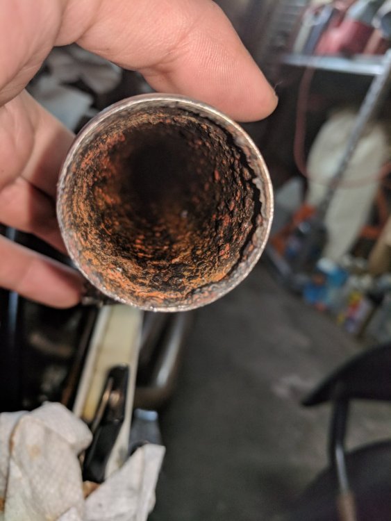

@VovchandrI don't think you have ever told us how you know your coolant rail is rusty?  Coolant rails normally don't go rusty or flaky on 20 year old cars.   I have cars of all makes up to 55 years old, some truly basket cases, and have never experienced a rusty coolant rail.  Is this somehow simulating a head gasket fail from a blockage?
Link to post
Share on other sites
Found these pictures I took in 2018 when I first bought the car
Coolant rail
Edited by Vovchandr

3 hours ago, Vovchandr said:
Coolant rail
That should be thrown away immediately.   What type of metal is that to get such corrosion in a 2001 Caterham?
Link to post
I feel like I've just been caught with my pants down and getting a stern talking to
It's ferrous, so steel?
After you replace your sparking coil wire- take some rubber brake or fuel line, slit it down the middle, wrap it around the wire and hold it in place with some small tie wraps.  That stainless line is like a file and it’ll protect it where it rubs.
Jim
Link to post
Jim
I moved the line further away for now but might do that too.
