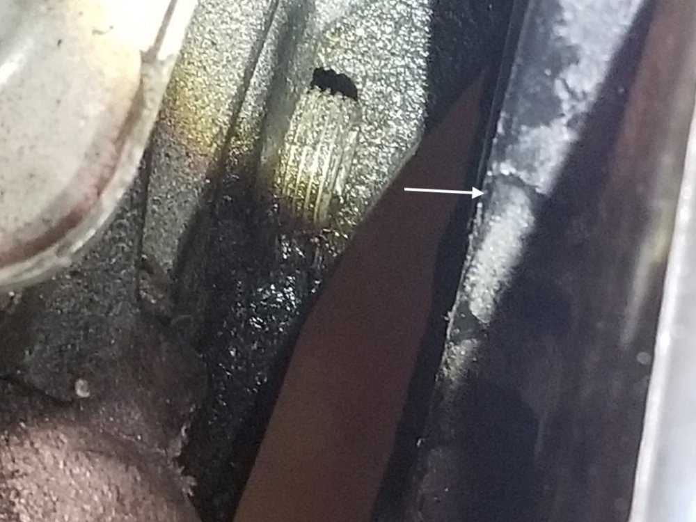

Well after looking a little closer and 2 hours of frustration I realize I need a square drive the 12MM hex did not work too big the 10mm hex are to small or a hex will not work with a square hole anyway?
I am just stumpt at how to get to this plug out I have less then a 1/2" gap between the plug a a body structural rail situated directly over the plug.
I found these an Amazon but I don't know if the 10mm in a square socket will work and as I have to butcher the socket to see if it will even fit I would preferer to get the correct size to begin with.
https://www.amazon.com/CTA-Tools-2049-Square-Sockets/dp/B008TOHAVG/ref=asc_df_B008TOHAVG/?tag=hyprod-20&linkCode=df0&hvadid=312540934012&hvpos=&hvnetw=g&hvrand=3825463004270120153&hvpone=&hvptwo=&hvqmt=&hvdev=c&hvdvcmdl=&hvlocint=&hvlocphy=9011978&hvtargid=pla-641879711752&psc=1
Any pointers would be greatly appreciated.

That would work perfectly if I had enough room to fit the socket wrench (assuming the 3/8" would work) between the plug and the body but as I pointed out I have less than 1/2" to play with.
I think cutting square rod to fit the plug opening and then an open ended spanner to turn the rod seems like the only way left to try, or just leave it be and assume that I don't really need to do this :classic_unsure:

It's hard to state if this would work from the picture, but if I was committed to removing the plug with the transmission still in the car, I'd be tempted to do the following:
  • Cut access hole, sized to accept an off-the-shelf plastic or rubber plug, as close as possible to the frame tube
  • Get square stock the appropriate size, then using a grinder, create a ball end that will allow you to insert it into the plug at an angle.  Something like this hex key
J47701-4B_Enlarge.jpg&maxx=750&maxy=0
Assuming that works, you may still struggle to remove the plug in the available space.  I don't recall the length of the plug, but even if it is shorter than the gap, it may need to be loose enough at some point that you can unscrew the last bit with your fingers grasping the exposed threads.

Just had another thought.  It's not clear from the photo how the frame tube is positioned over the plug in the vertical plane.  Is it possible to disconnect the engine and transmission mounts and lower or raise the engine trans assembly just a bit so that the tube is no longer directly over the plug?

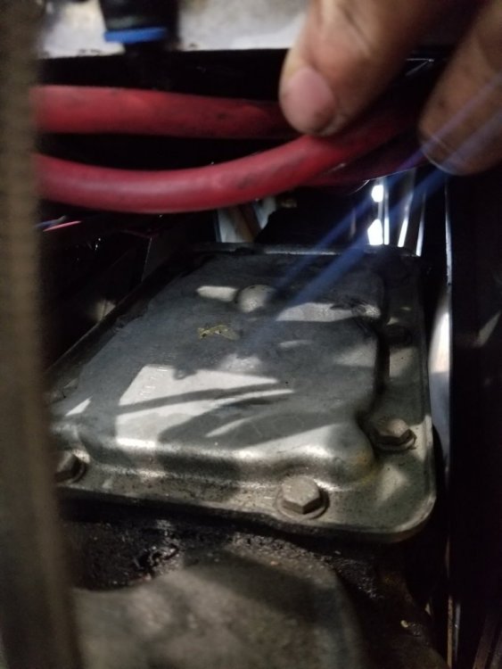

KK thank for all the advice will let you guys know how it turns out once the second ltr of oil turns up (Saturday)
The gasket is another story, looks like my best option is to fabricate one as I cant find just the lid gasket
Lastly is this screw securing the lid (there is only one)
I have not seen this style before  if it does need to be removed what tool do I need
