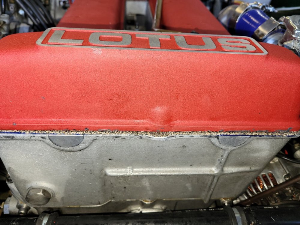

The story I was told decades ago was that they came with the area around "COSWORTH" painted. However, the paint used didn't hold up and would blister and flake off. So many 2nd, 3rd and so on owners never knew this. (See photos). Your car, your choice.

If you are going to blast the valve cover, make sure the interior is sealed with plywood or something. The media, especially glass or sand, can embed in the aluminum and later be released from heat and oil. Nasty stuff you don't want circulating in your engine.
I took this information. Years ago when rebuilding old Triumph motorcycle engines.  I have a system now.
First of all I use the largest glass beads I can get.  They leave a nice closed satin finish and tend not to get imbedded in the material.  Low pressure seems to work but requires some patience.  The parts are then given a run in the ultrasonic cleaner.  The theory being the vibrations dislodge any beads that may be remaining.  So far I’ve seen no signs of any glass beads in the filters at first oil change, although I’m not sure if you would.
Ian

Walnut shells are a safe alternative to glass beads and leave aluminum with a satin finish.
