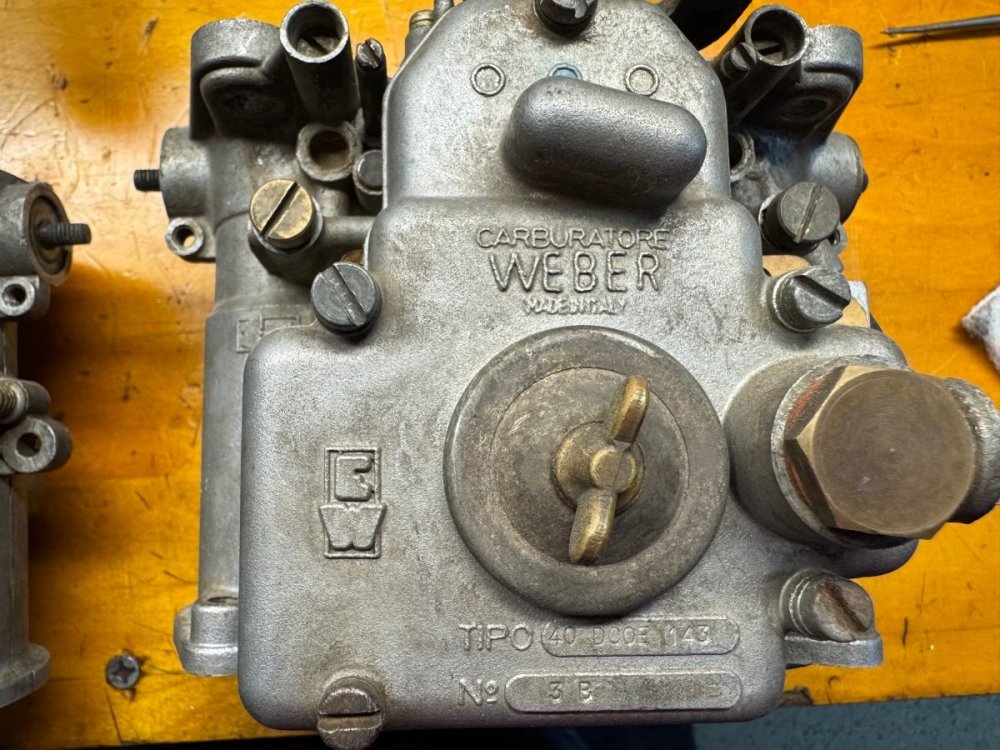

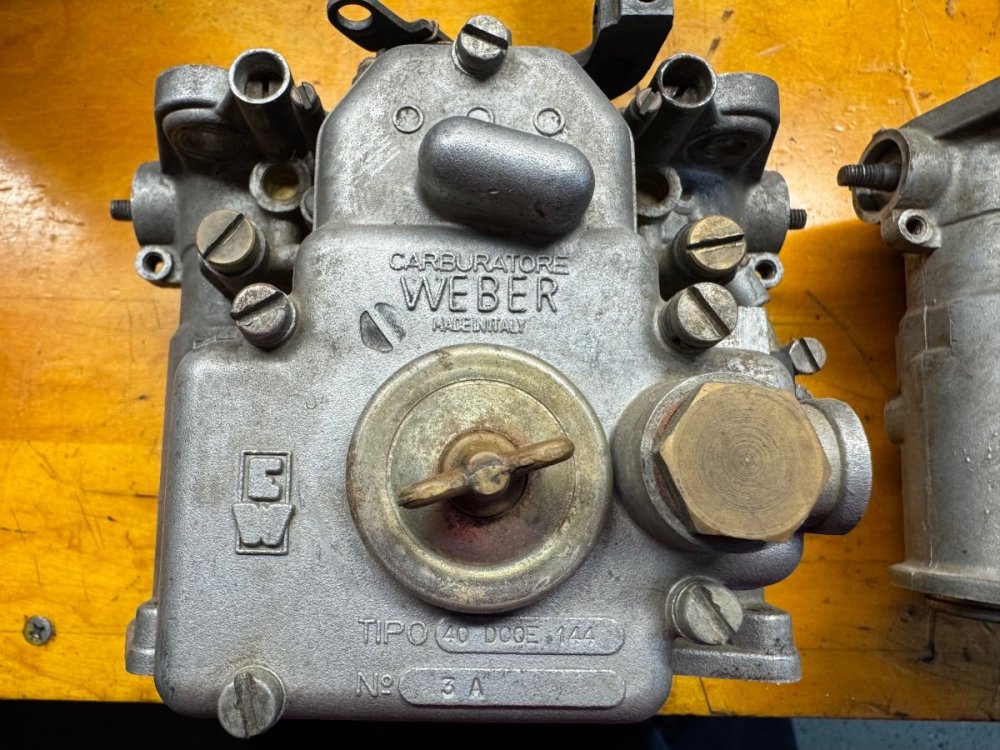

	Here’s another question for the collective wisdom. My 7 was shipped from the factory in 1961 with an ‘A’ series engine. Sometime around ‘64 & ‘65 the engine was changed to a Ford 105 E. The car was disassembled in 1969 and stored until I bought it in 2023. The engine as I received it had been fitted with a different crank and rods to give 1340cc, ported, had aluminum spacers on the rocker shaft, maybe an cam, and had twin 40 DCOE 2’s fitted, so sometime between ‘64 and ‘69 these various mods had been done. Does anyone know if the 40 DCOE 2 was a ‘64-‘69 period carb? I have a set of 151’s in addition to the 2’s and I’m trying to figure out which are more period correct and which might be good choice for a 120E (1500cc) with an A2 or A3 cam, mild porting on standard valves. I’m thinking 151’s, but I’ll be interested to hear other thoughts. Thanks, Ian

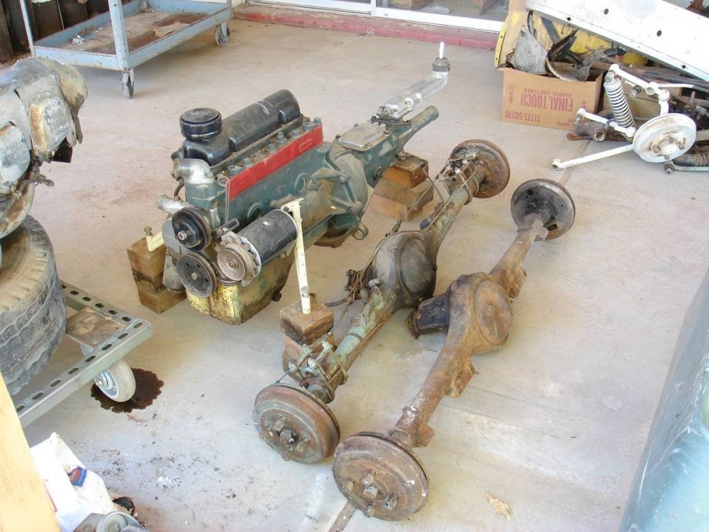

	Hi Joe, Thanks for the references. I’ve never seen this car with the engine in so this was a big question. I have the frame drawings and was looking for some reference to engine position, but there are none. It’ll be while before this goes back together, but this info will be a good check. I will try to find the other engine mounts, there’s also a fixture to make more, and see if there are differences. My guess is this was an autocross car or similar, but some very low level as the standard of workmanship of the welded-in roll hoop was very, very poor. It would not pass tech inspection, not even close, these days! My thought is that moving the CG rearwards may have improved turn in response. Ian
	It’s going to take some study for sure. I’m surprised to hear that you’re at 50% with no drive or spare when the engine is well forward. I think some the secondary difficulties may sway me against. No available exhaust, gearbox mount to name just two. Hmmmmm . . . Ian

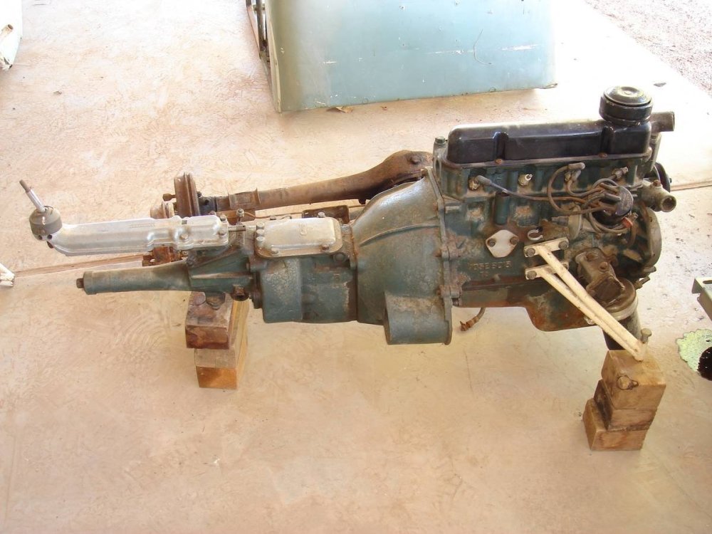

	My car seems to have had engine mounts made that move the engine back by maybe as much as maybe 6” (see attached). This car has a history of some form of competition, auto cross or similar, back in the mid to late ‘60’s so I wonder if shifting the engine was a thing back then. I’ve heard, and it would seem logical, that it balances the F/R weight distribution to close to 50/50. Is this a mod worth keeping, understanding that it is not original, but is an in-period modification? I believe the original mounts are in the pile of part somewhere. Ian

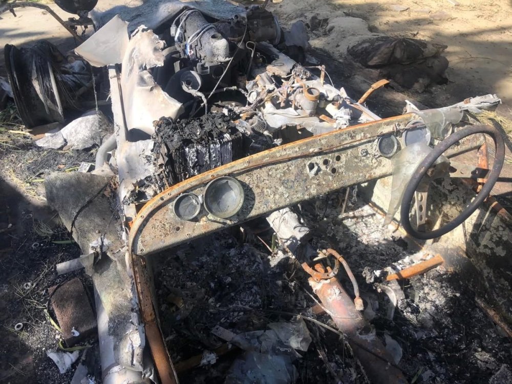

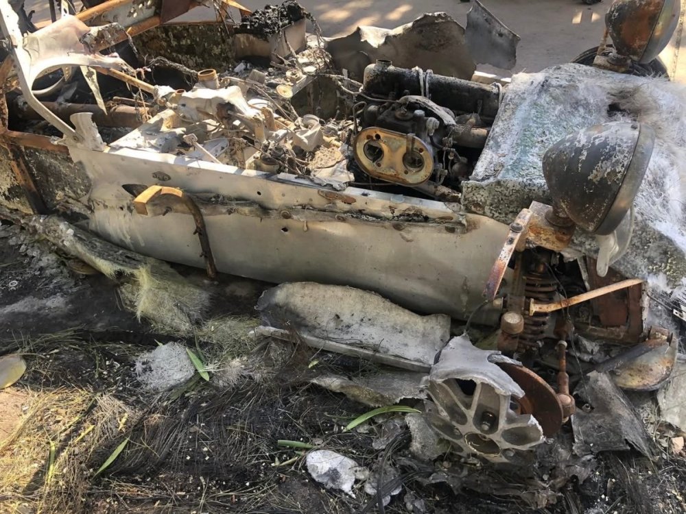

	****** SOLD ****** The recent California fires took a fellow 7 owners home and car. He recently posted the following: “Like many I lost my home and stuff in Topanga to the fire on 1/7 Offering this to my VARA family, hopefully this is worth something to someone It was a 1962 Lotus 7 series 2, # 1636 1600 ford motor .040 over, lightened and balanced with an Ivy head Never installed correct series 2 rear fenders and clamshell fronts. Original side curtains Please make me an offer and it haul away“ If interested, please contact Marshall Kahn via Facebook of via me.
