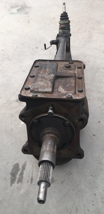

Very good used Ford Type E ("Rocket box") from a Birken Lotus 7 replica that had a "Kent" 1600 cross-flow engine in it. I pulled the top cover and looked inside, no chipped or broken gears. These are full synchro so no first/reverse issues as are common to transmissions without first gear synchro. Iron case top loader, 'Web information says good for 175-200 HP so much stronger than the earlier Type 3. Only selling as I am putting a T9 in its place. These are very hard to find in the USA. Modified gear lever is included but the bell housing is not. There are several direct fit bell housings available depending on your use. Any bell housing that will fit a T9 should bolt up to the Type E but you have to remember the input shaft length varies. This is from a four cylinder engine so has the "Short" input shaft and "Lower" gears. Gear ratios: 1=3.65:1, 2=1.97:1, 3=1.37:1, 4=1:1 Listing as local pickup only as I cannot estimate shipping to an unknown address and do not have it crated. I am near Reno/Lake Tahoe, you wanted to visit the area anyway. YRC Freight went broke, Fastenal is a good alternative for Western US.
A step forward, a step back. It seems the T9 I ordered via feeBay has gone "Missing in transit", AKA STOLEN! Seems to be the new normal, and a T9 is not the Hope Diamond, so just thuggery at play. Cannot order another until I get my refund, and of course prices are still going up. So for now I only have the "Type E" 4-speed to work with. Not certain how much has to be changed between them when I finally do have a T9.
