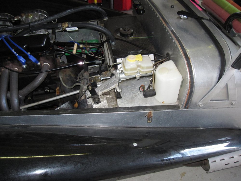

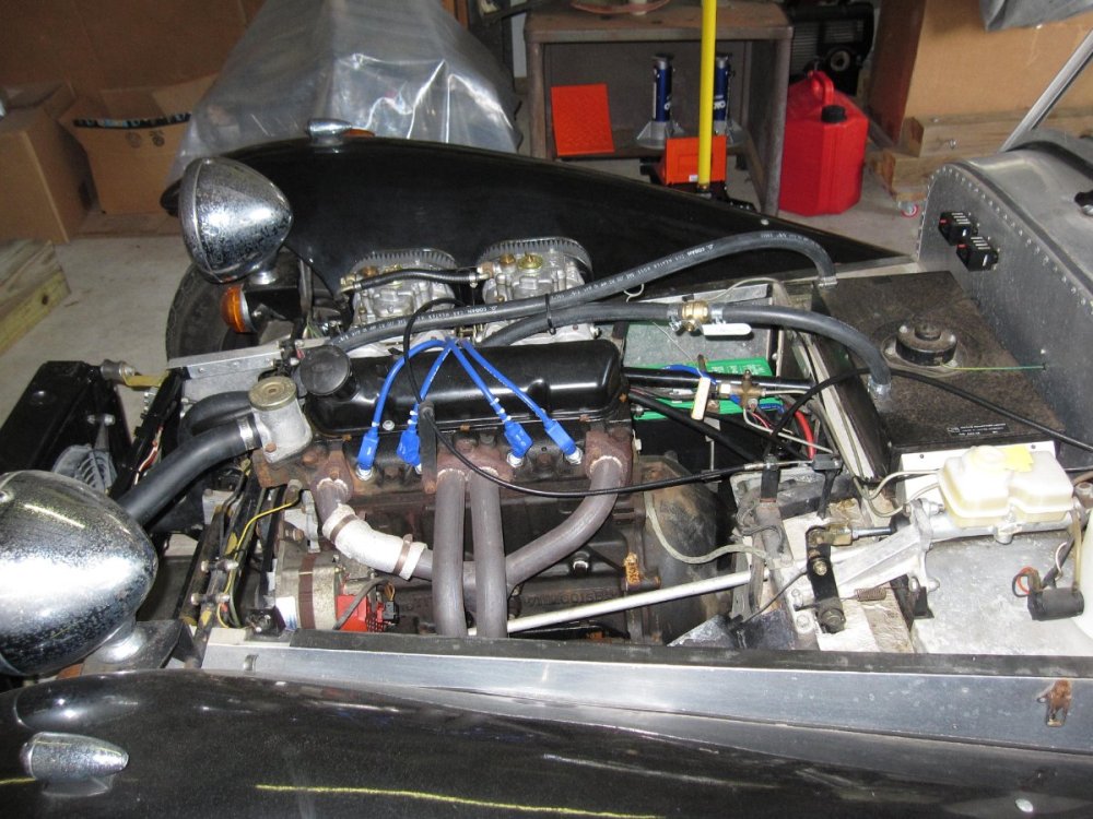

Your brake master cylinder is the original for your year model and many others. Chris switched mine out recently for a new one. Yes, Chris grew up working on "Sevens and Elans". Unfortunately, the new master cylinder only comes equipped with two ports, not three as in the original. After all, this car is 40 years old, however, I am aware of a company that restores old classic brake master cylinders and warrants them for life; White Post Restorations in White Post, VA. As of now, one port/line goes to my two front disc brakes and the other line goes to the rear brakes. When I have my master cylinder rebuilt, I will use your diagram to reinstall mine correctly as intended. So, thanks very much for posting your photo. It is exactly what I was hoping to locate. Now, if someone can tell me how to save these photos to my computer, I will indeed be a happy camper. Copy and paste doesn't seem to work for me. Thank you again, Jon, for posting these photos. R. -

MV8, Sorry I thought this was private messaging, but I stand to be corrected. When a private message string is initiated through the picture, will the subsequent messages be private or does any reply each time need to be re-initiated through the picture? Or, how do you know when it is not a PM? Thank you for the details on the brake situation. At this point, I do not have a brake light switch attached to a line tee like I have noticed on others. I've been looking for the switch the past couple of days haven't located it. I thought it might be attached to the brake pedal arm, but haven't found it there either. Obviously, there is an electrical switch at the top of the master cylinder so I am looking into that as well. The brake master cylinder was a Lockheed replacement unit from Caterham. My previous three port Lockheed master cylinder was apparently discontinued. Still working on this issue. And, I will make all attempts to stay within the rules, going forward. R. -

Hey Jon, Thanks for reaching back out to me. Yes, your Seven resembles mine in many ways and not many ways. My Seven is LHD and is powered by the Sprint version of the Cross Flow 1600, unlike your twin cam. I took my Seven to a shop here fairly locally, and they removed the brake master cylinder and installed the current UK replacement, which unfortunately, was equipped with only two brake line ports. As a result, They had to fabricate a different brake line set up to me to the front calipers. I kept the old brake master cylinder as they can be rebuilt here in the US. There is a specialty shop, White Post Restorations, located in White Post, VA. However, in the mean time I have very little braking ability in my system. My brake master cylinder was exactly like yours, but now different. It is possible for you could follow your brake line individual routing to each caliper/drum, and tell me where each one terminates and from which brake master cylinder port While I have the door open, do you run 13 inch tires or otherwise. I'm having some real difficulty finding quality 13 inch tires for my car; not racing tires as I do not race this ride. It appears Avon tires, when available are good for the racers. I was looking at the BF Goodrich TA line and they do have a lower profile tire that might work lowering the car about 1/2 inch when space on this ride is at a premium. My original tires are 185/70/13. Is your car set up with Girling calipers in front and Ital or Ford drum brakes in the rear? How long have you owned your Seven? Where do you source your wearable parts; brake pads, shoes, other parts? And, do you have legacy part numbers for the parts? My seven is a long cockpit version, which came with the Morris Marina/Ital live rear axle. Although, I should know, as a previous multiple British car owner in the past, I do not know where the front calipers were sourced; which car, which model years? I have owned my Seven for almost 40 years. It is close to being road worthy again, excepting the brakes and tires. Hope to solve that as soon as I can. It has been sitting in my hanger for about 5-6 years. Still needs much TLC in the form of wash, wax, and some re-chroming but it will work for me until I can get that done. Just itching to get back out on the road. I'm located in North Florida; what about you? Are you a member of the Caterham/Lotus 7 Club in the UK? I was for about 10 years, then life got in the way, and I simply dropped my membership. Plan to open it back up again. He, Jon, thanks again for reaching out. If you shoot me your phone number and give me a time, we can talk more about this on the phone. I'll be glad to make the call. Cheers. Ron. Thanks for your -
