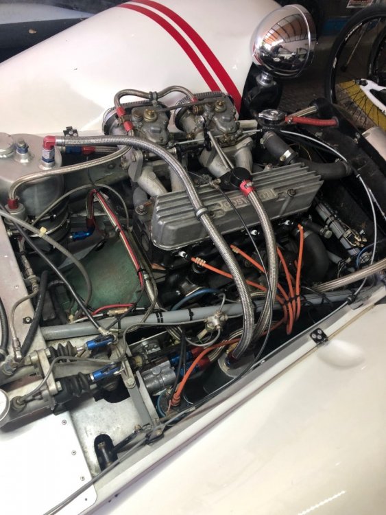

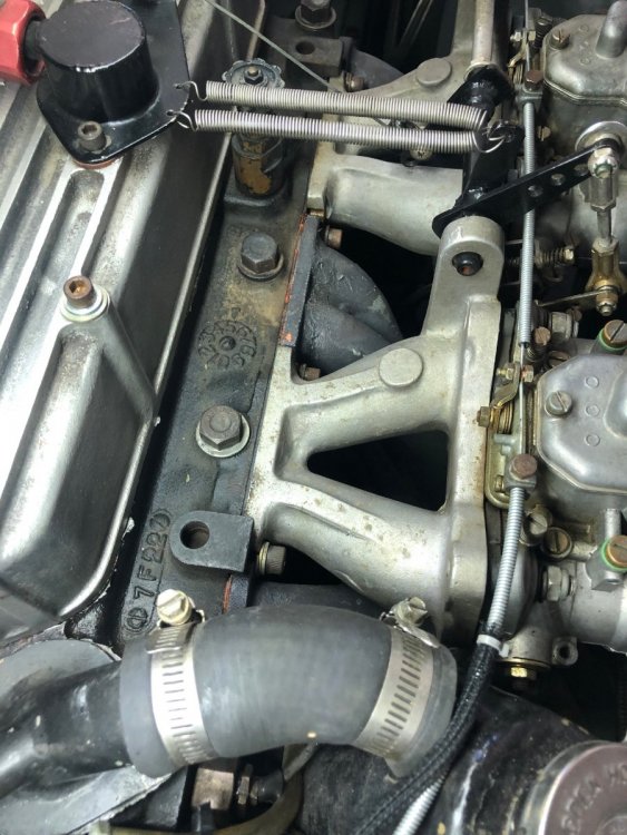

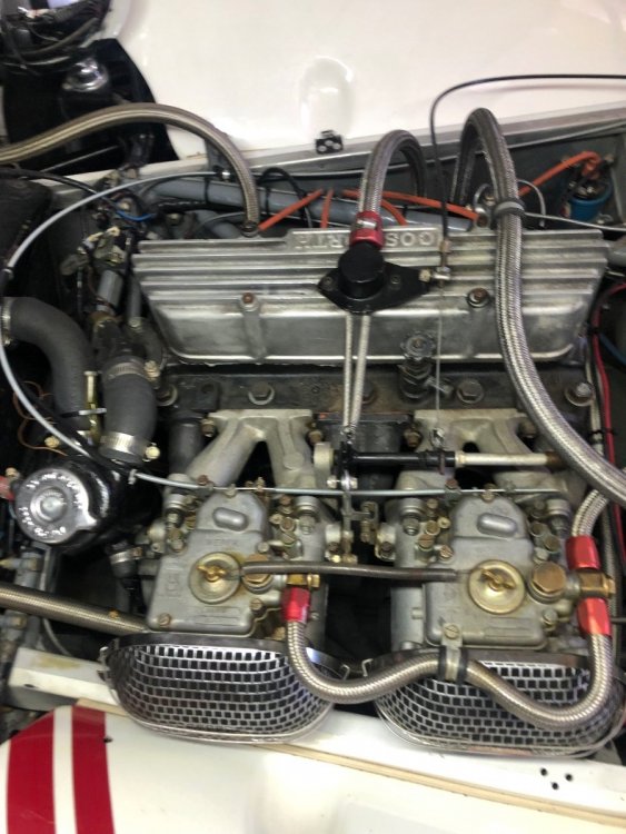

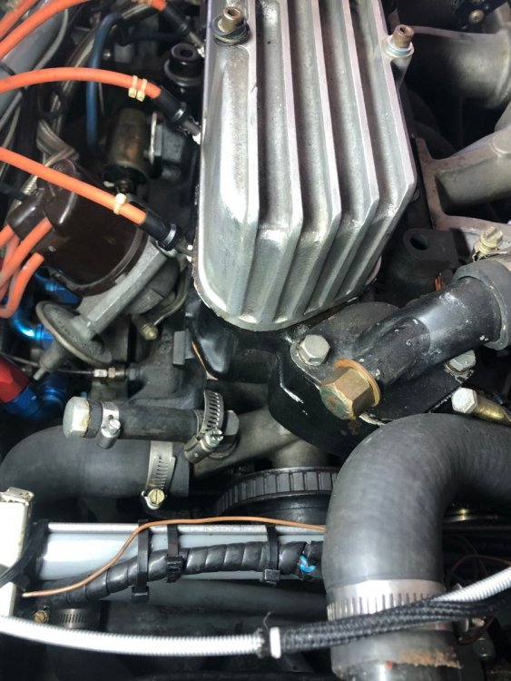

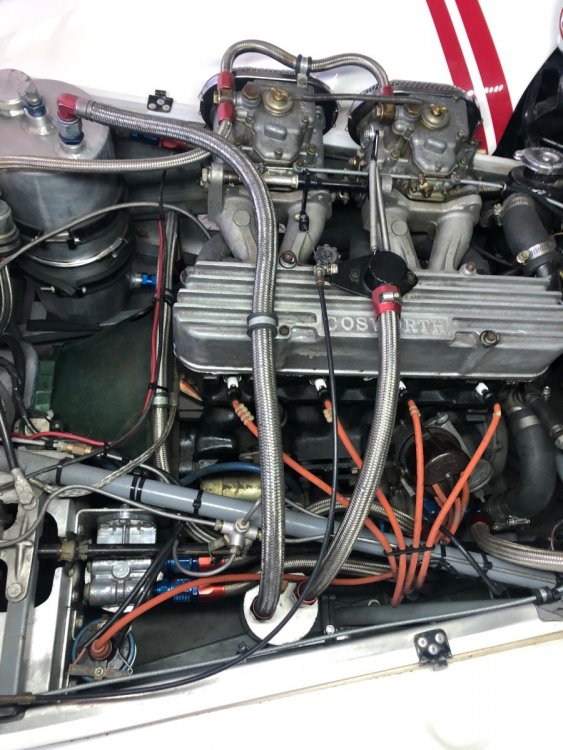

I’ve added some photos, if it helps anyone identify anything. It does have the external oil pump, which makes me wonder if it is the 105 engine? -
