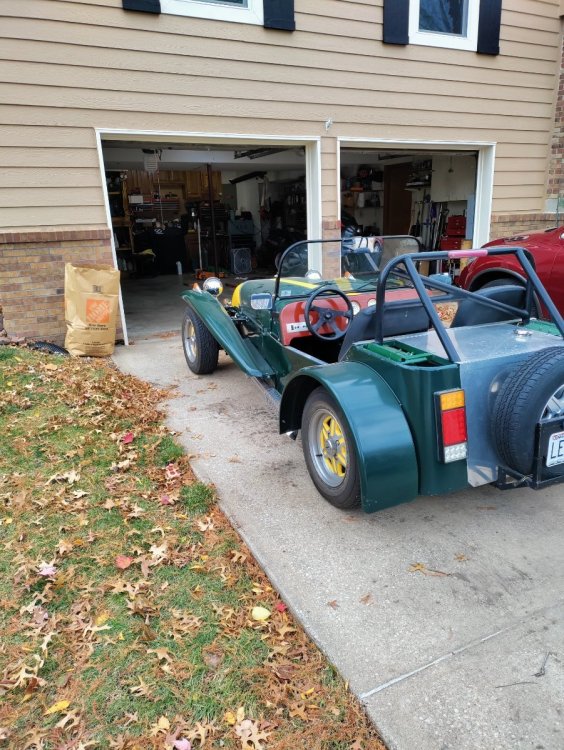

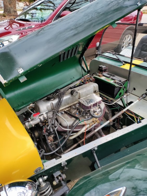

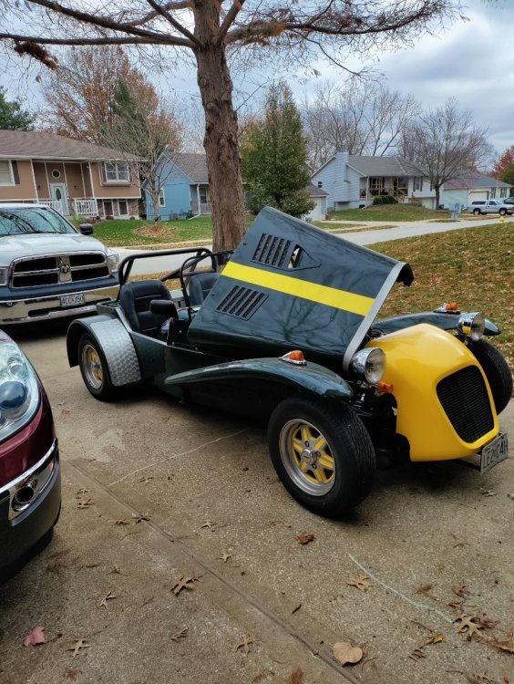

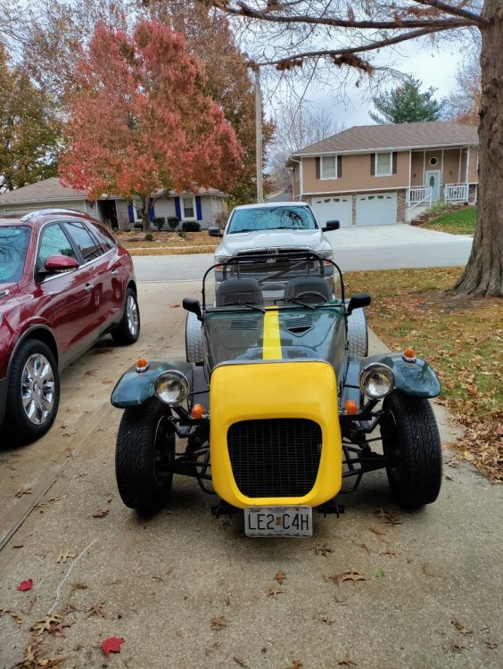

  1. Due to health reasons I'm going to have to let my toy go. I built it the early 2000's to fit my personal size. It's based on the book but with a longer length ( to accommodate the engine, trans combo) The hood line is also raised for the engine ( nissan L28) and the width to accept my personal "width". The donor was a rolled 76 280z with 30k miled on the odometer. The entire drive train Is from the z including the IRS. I was a professional auto mechanic at the time and just finished my last project, a turbo 215 powered 76 TR7 coupe. The car is street legal and has been my weekend since being built. Registered as a 1962 lotus 7 " clone". This is not a show car, it has seen the road to several "gatherings" here in the Midwest. But a solid build. The original build log comes with the car as well as some hard to find spare parts. Located in Lee's Summit Mo ( Kansas City) $7500 firm Jdziurawiec@outlook.com
