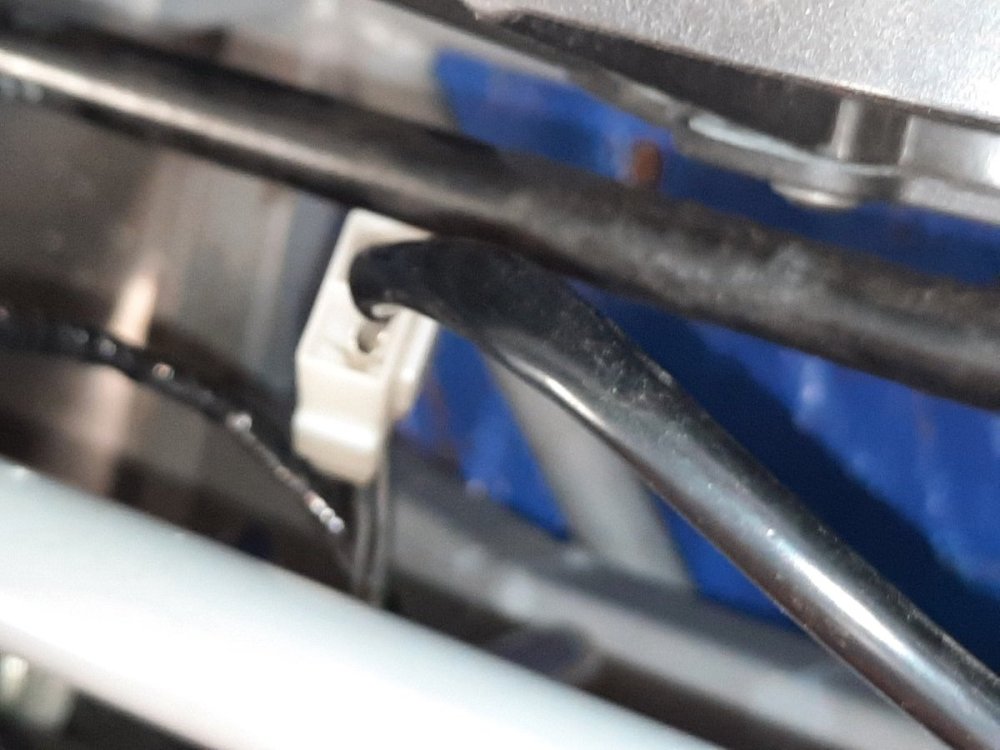

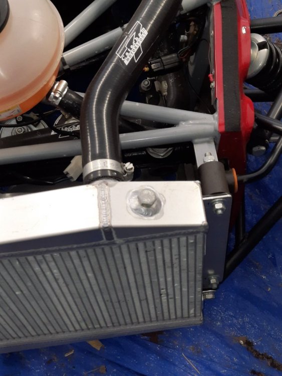

  3. Sorry for read. 1. is back side of radiator 2 is only port, outside of hoses and too high if air in system 3. fan plug connection, runs to light harness and back toward firewall. Easy car electrics for ref only, the sensor only talks with the ECM which controls temp gauge and should control relay I,ve wired fan BATTERY B+/ SWITCH/ FAN /BODY GROUND B- AGAIN THANKS

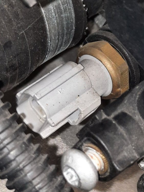

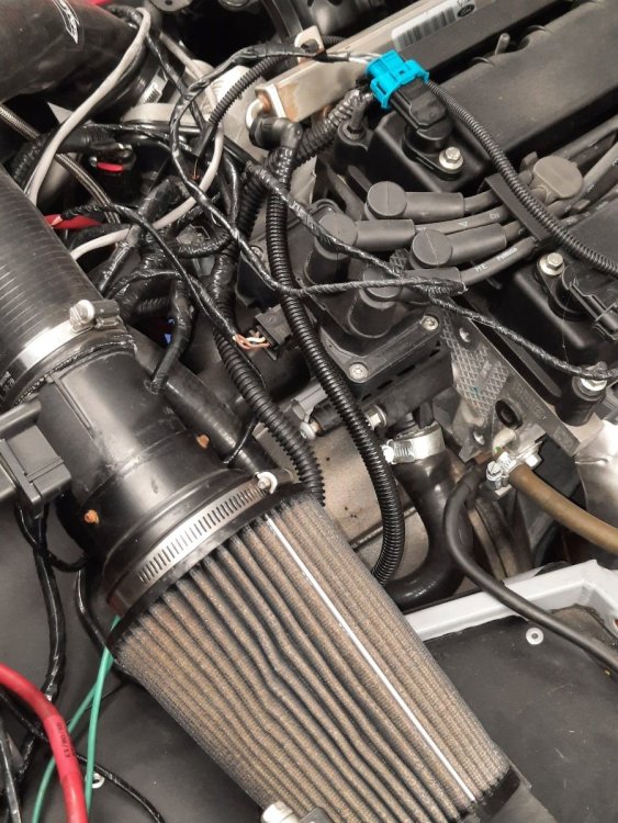

  5. Only temp sensor found, is located underneath the coil pack for engine (see pics). Was able to remove wired socket and as expected dash gauge went to high when turned on. As gauge works normally when plunged in, I'm not inclined to replace the sending unit right now. Engine and harness came from a 2011 Fiesta and tied into the caterham chassis harness. I also believe the ecm came out of the Fiesta. Thanks for all the good imput Rick img20230812_15244881.pdf

  7. Fan never comes on, I understand that the ecm activates fan relay, but just starting that trace. Temp gauge is working, so turn on the fan manually. Central Texas heat rt. now starts at 80 degrees morning thru 115 in afternoon. Only an hour check time in morning when cooler. Still looking for sensor, no temp sending unit found near heater core or other water pathways, so far, This has a 1.6 l sigma dohc in it
