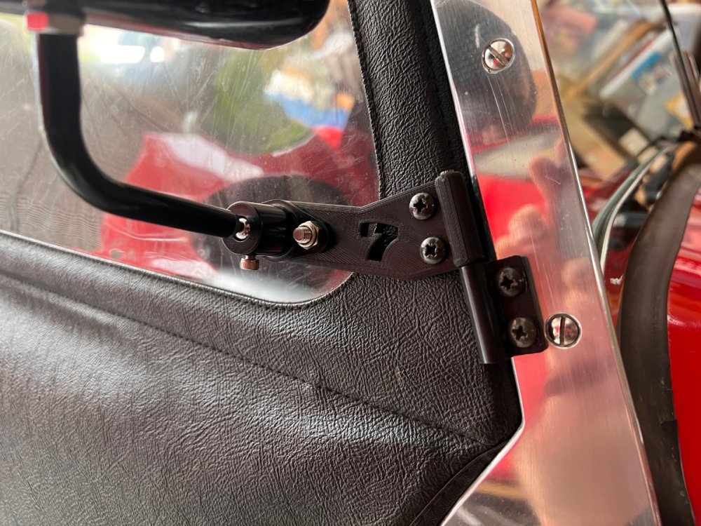

I’ve been driving my Seven quite a bit since acquiring it a couple of weeks ago and I’ve found that the wind above 60mph is pretty harsh. I noticed that a lot of folks use their side curtains, but that meant that I’d lose my stanchion-mounted mirrors and I like to have mirrors. I ordered a pair of small, lightweight, cheap mirrors and asked my son to 3D print a pair of ABS brackets. I’m delighted with the results - the mirrors are pretty decent and the doors can be opened very wide without knocking them. The file is available if anyone wants to try the same thing. The mirrors are: https://www.amazon.com/Carbon-Look-Race-Small-Mirrors/dp/B0BWYSCZYC?pd_rd_w=ABtPW&content-id=amzn1.sym.b854a5c2-4475-41f8-a6d4-df92b2868104&pf_rd_p=b854a5c2-4475-41f8-a6d4-df92b2868104&pf_rd_r=7RY8T153KK5682NZQGQ5&pd_rd_wg=rZ6NV&pd_rd_r=76851c1b-5a24-4313-a1a4-29284ef6fe38&pd_rd_i=B0BWYSCZYC&psc=1&ref_=pd_basp_bia_rpt_ba_s_1_sc
