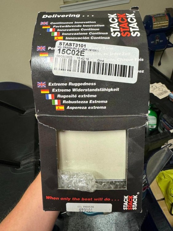

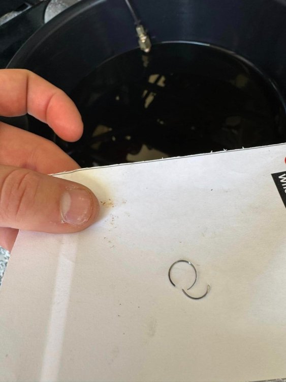

The adaptor came with the Stack kit. Depending on what you already have you will just need an M10 to 1/8 NPT fitting.
Solution was to clean the interior threads and I was able to install the M10 adaptor. Not sure why it was not threading initially but after the install there seems to be no leaks after an hour of driving.
Thanks. The suspected 1/8 fitting above the M10 in the photo does appear to thread into the housing on the car (not 100% certain if it is a bspt or npt) so I will plan on installing that directly and check for leaks. I found on an Elise parts website where the K Series oil sender can be 1/8 NPT or M12x1.5 so that is making believe it may be NPT. Haven't seen anyone else talking about this size on the Caterham forums so curious why it is non standard. reference: https://www.eliseparts.com/shop/engine-management-sensors/k-series-oil-pressure-switch/
Hi everyone, My electronic sender has become unreliable and I am refitting a Stack mechanical gauge. After research I saw it should have a M12 size fitting to the oil filter area. I went to install the new kit and the threads seem to be different. I also noticed some thread shavings came out with the old sender. Does this mean it has been retapped at some point? The old sender seems to be a 1/8 NPT. What would your recommendation be for continuing the install? I have some photos of the old sender along with the shaving that came out. Thanks! Logan
