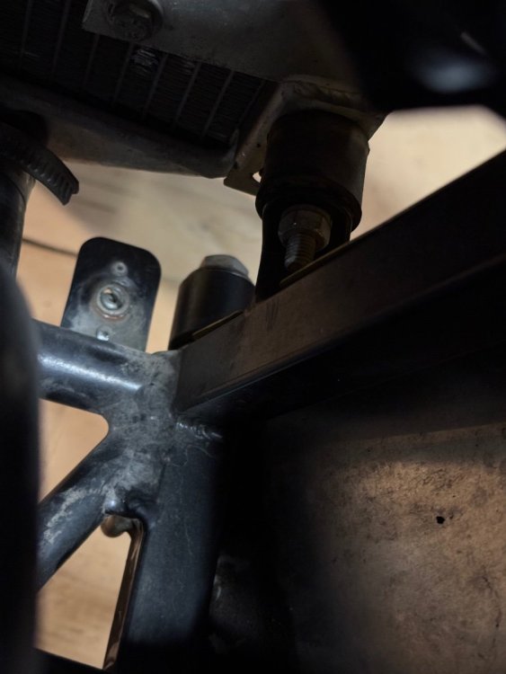

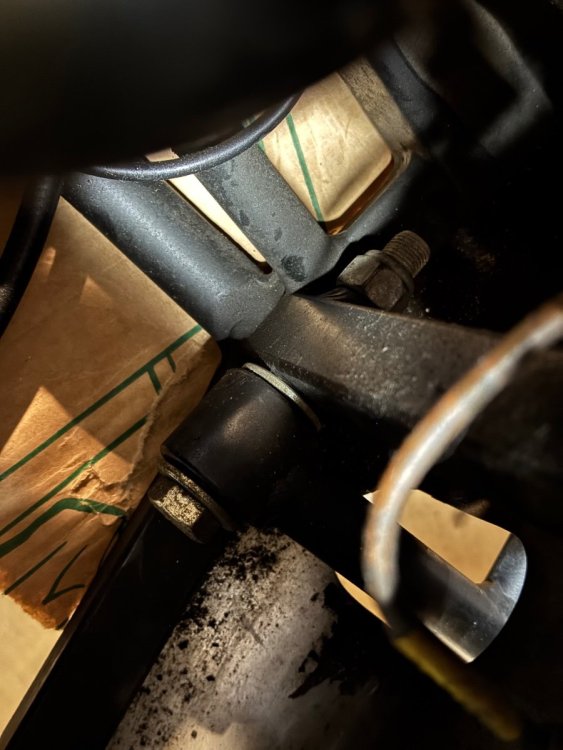

Thank you @IamScotticus this is exactly the info i needed. I don't know if all the bushes need replaced but the smaller upper front wishbone bushes, i think this: A arm top inner front 2030 seem very worn, the metal of the bracket and the linkage are touching and the angle is askew. Maybe this is normal, seems not proper idk. From a previous list you posted a while back its either one of these E2030 Radius Arm Small Length: 31mm Centre hole diameter: 9mm Outer diameter: 19mm ******************************* E2030 Short (S2030A) Length: 26mm Centre hole diameter: 10mm Outer diameter: 19mm I think short to fit into the arm thats 28mm, but there is a gap between the bush / washer and the bracket, 31mm could fit... bolt threads are 5/16 diameter. The coil overs need replaced so while I'm at it I was thinking about refreshing the bushings too. Waiting for my Tony Weale book -

Yup, 185/70 r13. No complaints but I don't have anything to compare them to. Running at 20 psi. I think for an old LA car this is good fit for road use they seem to absorb quite a bit of the harshness out of what I would have expected to be a much bumpier ride, even with worn dampers. They also look classy @MV8 hoping not to tear it all apart before ordering, but I went to lift it and started investigating, the configuration is not what my build manual said it should be and discovered.... @IamScotticus YES TY! The lower wishbone mounts on the front and rear with 1/2 bolts, the front bolt has no nut its in the chassis. The top "wishbone" is a combo of the old classic upper link and a front A-Arm that bolts to a bracket the sticks out through the skin and is mounted to the back of the ARB bushing mounts on the inside of the frame and to where the ARB mounts to the upright. On it! I have a similar book for my Lambretta "Stickys Book" and the "how to keep your Volkswagen alive", sorts through all this type of stuff for ppl 50-60 years later. So this is not represented in the build manual I have. All these wishbone parts seem available from Caterham but with bushings pre installed, does that mean I need a fancy press (more than a hand screw type) to replace them? More pics of the configuration for future folks. Separate part for the forward part of the upper links the small front bushings are very worn and the arm is starting to rub on the chassis mount. Front lower wishbone 1/2" bolt screwed directly into the chassis rear lower wishbone bolt also 1/2 in bolt. The bushings when calipered from the outside are the same size. ~1.25" long, ~1" OD with a 1/2" ID bolt: -

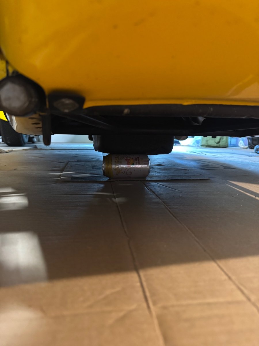

Hi all, I recently acquired a yr 2000 live axle xflow Caterham S3. It's on its original 25+ year old Bilstien suspension and I'm thinking these things are probably a bit long in the tooth. I'm not planning to track the car much if at all, it's primarily a road car. Whats a good replacement that also gives some adjustability too? Would be nice to dial in the ride height and rake at least. I've seen Meteor Motorsport in the UK thrown out there as a goto solution. Any good options this side of the pond too? the sump also seems really low :/
