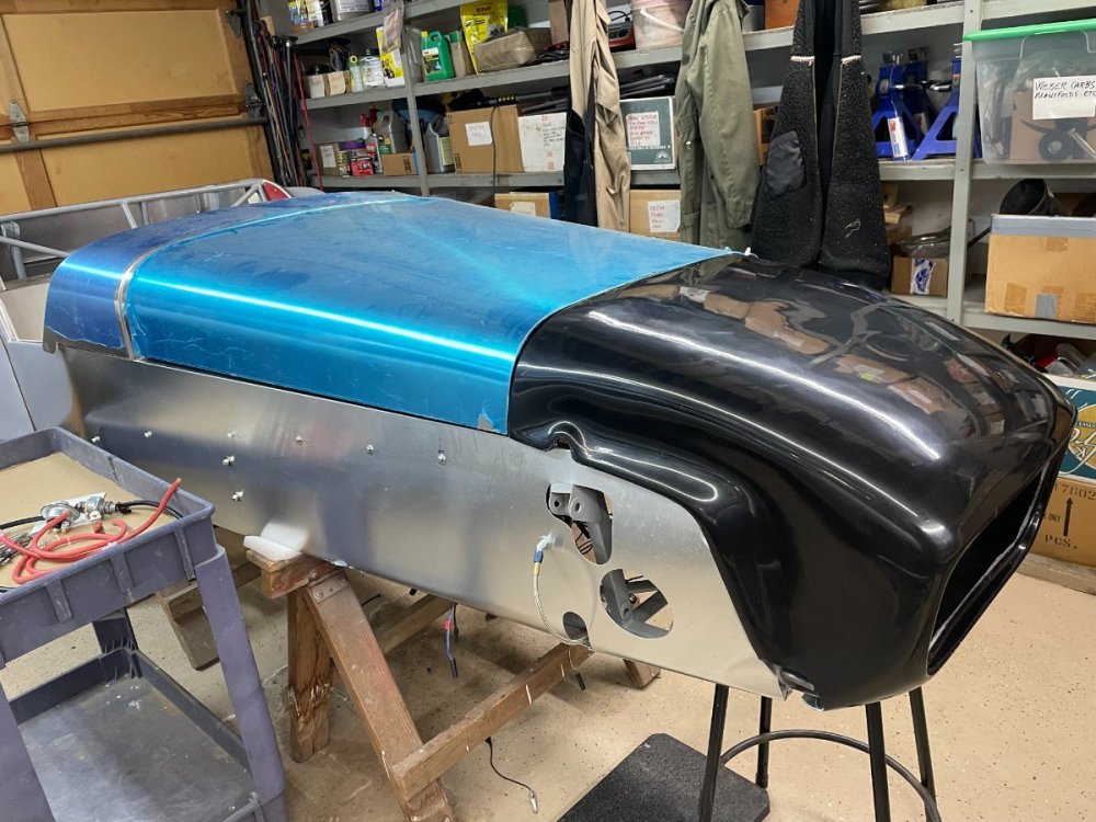

Yes, the headlight brackets align under the openings -

Incidently, about a week after I ordered the nose cone from MSC, I received a message from Chris at Redline that he had a S-2 nosecone that he could send to me! So if anyone is in the market for a nose cone, check with Chris and perhaps his product would need no modifications. -

Motorsports Composites nosecone: Thankyou Scott! I ordered a nose cone it from MSC. It fits quite well and the quality is good. I will need to make the following modifications: 1) cutout for the anti-sway bar 2) extend the skirt to fit the lower Dzus fasteners -

Thanks Scott! I will contact Motorsports composites. And thanks to all of you that contributed to this thread! -

Bad news: Just learned from Chris at Red Line that he is unable to furnish the nose S-2 nose cone that I ordered last April... so I am still looking for a nose cone. He said that the the Lotus S2 and S3 nose cones are the same except for the location of the Lotus emblem. The Caterham S3 nose cone is completely different. Lotusfan do you still have that nose cone....if not, any other leads? -

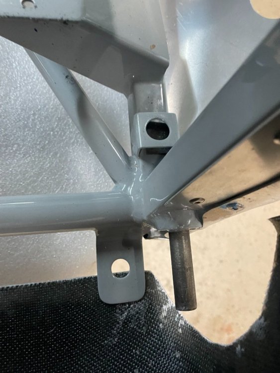

Cycle fenders were an option and this clamp was used for the lower cycle fender support -

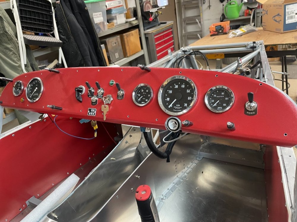

Hi Guys, apologies for asking for help and then failing to follow up with your kind responses! My feeble excuse is that Chris at Redline said that he could furnish the series 2 nose cone that I need. That may have been a mistake as after 8 months he has not come through. In fairness, he has had trouble with his supplier and I am in no rush.....just taking my time and savoring this restoration. Here are some recent photos. 2025 Lotus2025 Lotus instrument panel.txt2024 Lotus wiring.txt instrument panel.txt -
I have a restored Series 2 Chassis (thankyou Nathen Down) and have now discovered that the nose cone that came with the project is incorrect. Any ideas where I could source the correct nose cone? I understand (per Josh Robbins) that the correct nose cone depends on the bonnet length as the rear nosecone shelf has 2 different lengths available. My bonnet length is 37.5 inches.
