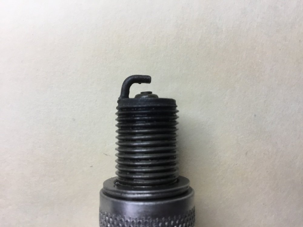

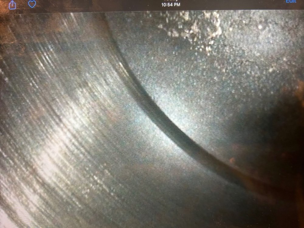

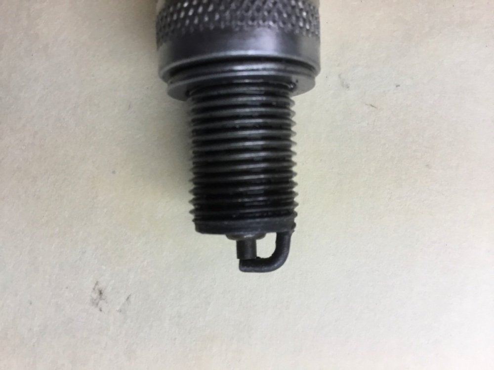

  10. This may get a little long but it’s unusual. The car started backfiring and missing and shaking and sounding like it was coming apart. If it had been just a plug fouling or failing to fire, it would have started to miss and shake while driving and I would have known what to look for. The backfires were shotgun loud and often, being on the left side of the car it got my attention and confused me. What the hell is going on? When I pulled #4 plug out, the center electrode was gone, as in the second photo. When I looked at it closer it suddenly appeared as in the top photo. The electrode would slide in and out when I shook the plug. I’m guessing that the plug never stopped firing, it would fire early or late depending on where the electrode was in it’s in and out cycle. I can’t think of other reasons as to why the backfiring and shaking was so violent. I was concerned that part of the electrode had fallen into the cylinder and had damaged the piston/cylinder so I ran a bore scope. All is well, nothing foreign showed up. I put 4 new plugs in and it ran as before, strong and smooth. Attached is a bore scope photo. Thanks for all the comments, Bill
  11. I’ve already bought new plugs, not going to install them till I’m sure that nothing fell into #4 cylinder from the plug that came apart. Bore scope late this afternoon. Bill
  12. I hope you are right, the bore scope should tell me, I don’t want to start it till I know for sure. Bill
  13. I’ll have to change my statement about the plugs, all looked the same except #4 cylinder. I started to clean the plugs with a small media blast device I use on aircraft plugs. I picked up #4 and as I held it the center rod in the middle electrode disappeared, as in retracted into the middle electrode. I turned the plug upright and the rod slid out and hit the curved side electrode which stopped it. I shook it and the rod slid in and out. The rest of the plug was a bit dark with oil or soot. I quit looking until I run a bore scope tomorrow. I called Champion’s customer service and asked how long the center rod was supposed to be and what it was made of. Trying to find out how much if any of the rod had broken off and was sitting on top of the piston. The rep said the center rod was nickel and wouldn’t tell me how long the rod was supposed to be because it was proprietary information! I was going to break the plug down, let the rod slide out and measure it to see if any of it was left in the engine. I thanked him for his help and will wait on the bore scope. More to follow! Bill
