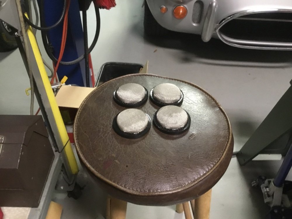

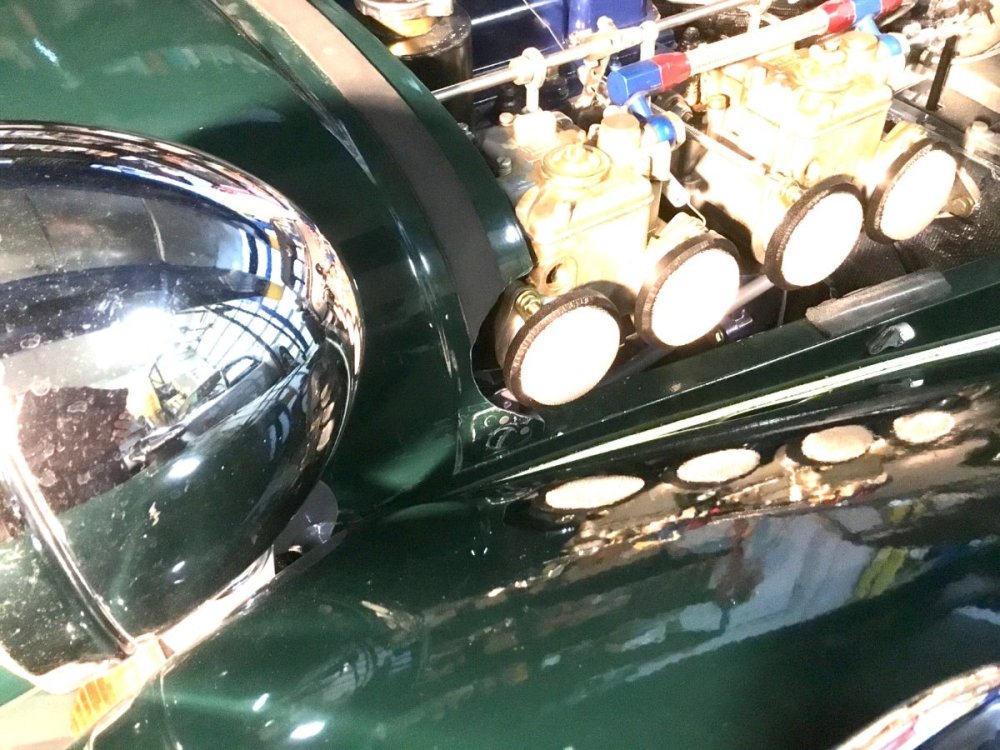

The original air horns were 1.54” high and the new horns are .63” high. A difference of .91” shorter. Going to use the metal mesh filters that attach with a plastic/rubber ring around each horn. Not the best filter, but sufficient for our high humidity weather in South Louisiana. These filters add about 1/2” to the horn length so I will end up with just over an inch total as opposed to just over 2” with the original horns. Cheers, Bill
Just ordered the short stacks from Pegasus. They are almost an inch shorter than the air horns the Webers came with. I did some measuring and they will fit with just a bit of grinding. Low profile filters will work. Thanks everyone for the info. Bill .
