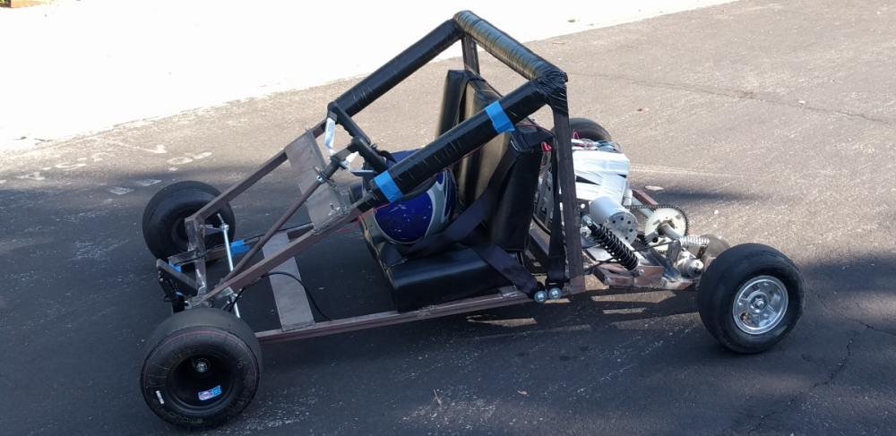

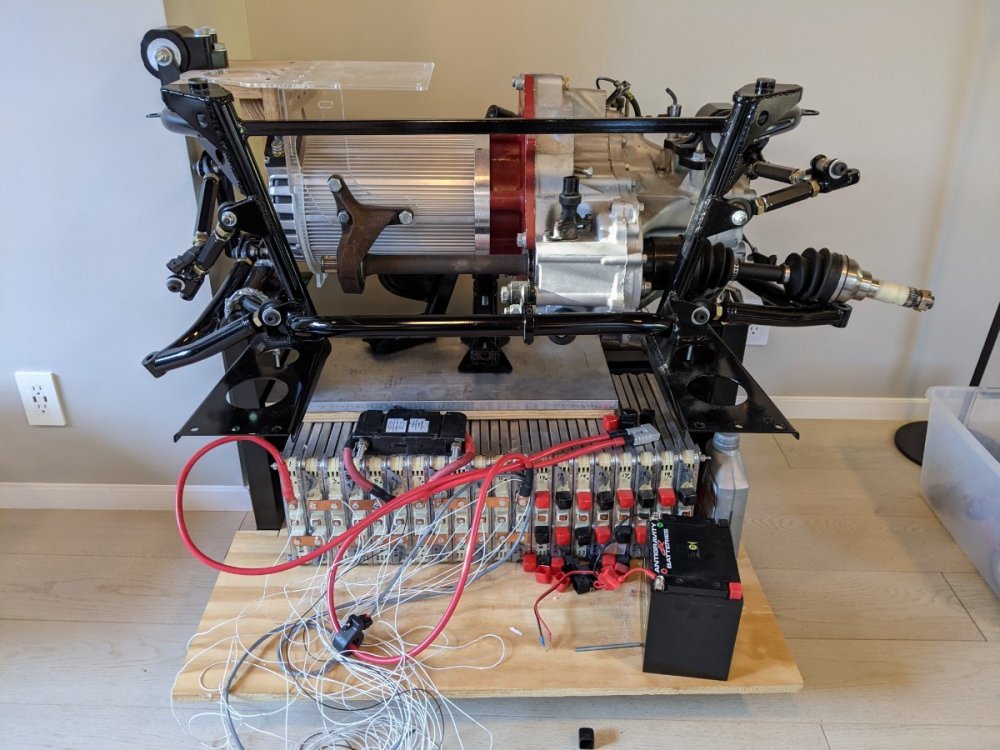

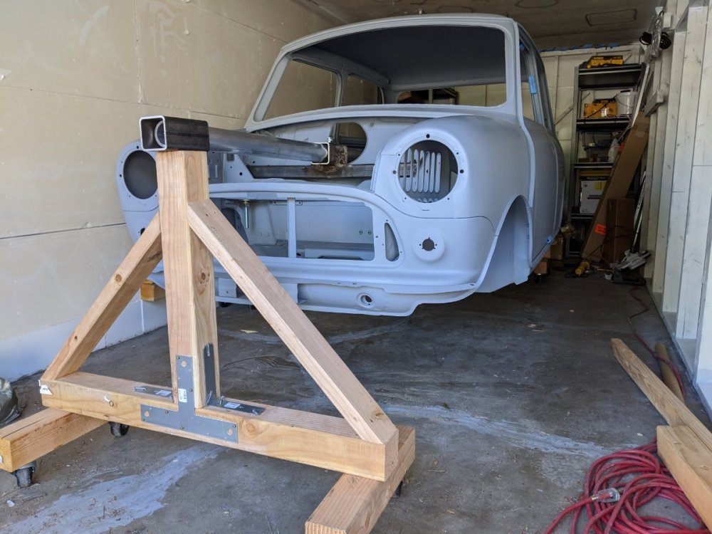

  3. Thanks all for welcoming me to the community! I really appreciate the feedback and pointers. Hope to meet some of you in person soon. I especially appreciate the reception given that I didn't build the Seven myself. I always wanted to build one, but I never found the time. I have built some automotive stuff in the past, though, including the Exomotive Exocet pictured below and an electric go-kart for my kid. At the start of Covid I also started building an electric Austin Mini (and trying to document the build at http://evmini.info), but some life & job changes have progress on that on hold for now. I'm attaching images of where I stopped, in case somebody is interested in checking it out. I'm looking forward to getting my Seven sweet and smooth, and better than new, with your help.

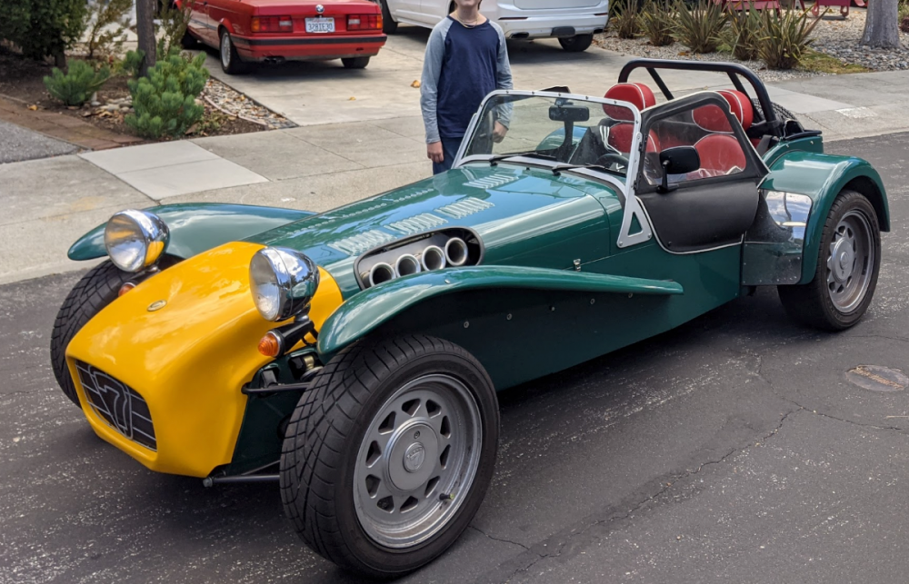

  6. I'd love to see the Cosworth version of the engine. If it turns out I need to do major engine work, I might as well proactively satisfy some upgrade-itis.
