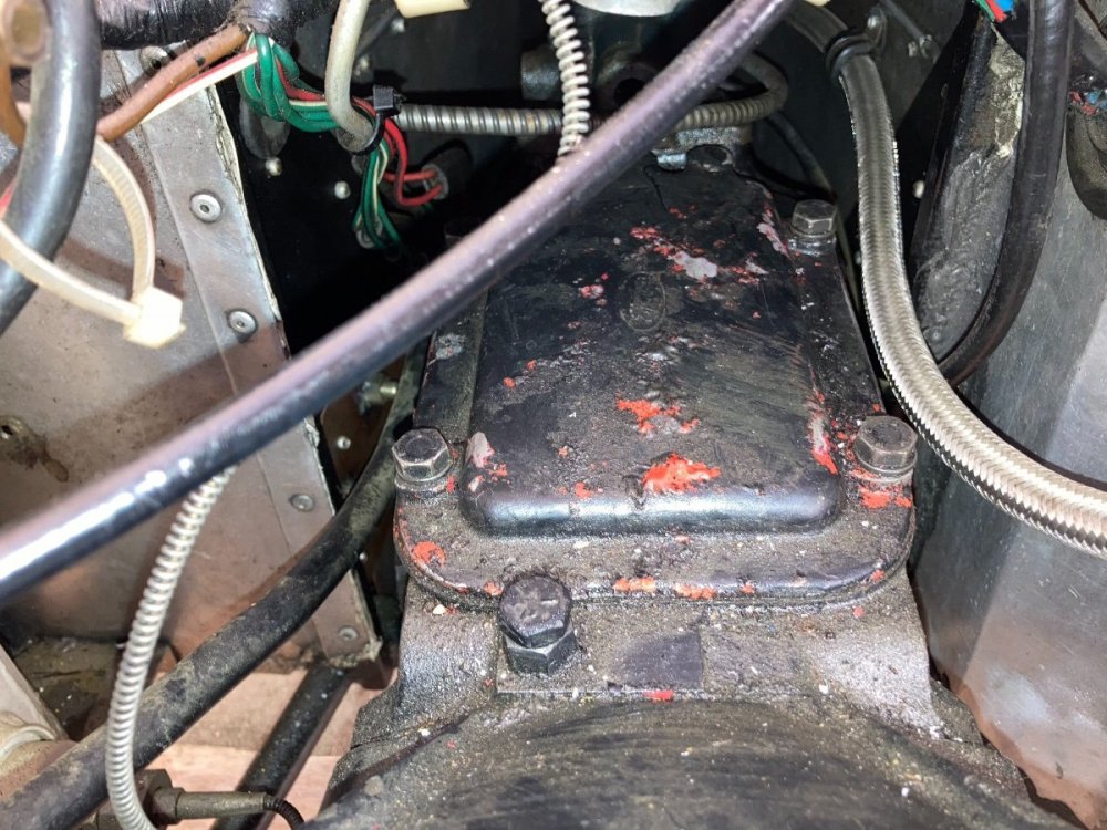

That must be where the issue is. When I pushed back the 1/2 (center) rod, it was back to normal... I guess I'll pull it and see whats going on, freshen it up etc....
Good information, thanks all...... I will pull it and see whats up, I was hoping for “just put heavier detent springs in” to solve the problem...lol....Nothing's that simple right????...I'll stop whining..... I don't have a problem rebuilding it, I appreciate the the parts sources and opinions..... the videos are a great resource too, thanks.... more to come, I'm sure....
Having issues with the transmission. Bound up the other day, couldn't move the shifter, seemed to be engaging two gears or ? Took the front cover off and saw the middle selector shaft too far forward exposing all the detent grooves. I pushed it back where it belonged and it works fine. Also my release bearing is occasionally noisy(dry bearing buzz). All I have for info is it is a Ford Cortina close ratio box. No year or model #. I need help identifying the box. Hoping someone can ID it by the picture of the top. 4 bolt cover in front of the shift selector assy. Any ideas on fixing the "bound up" part? Common problem? Etc. supposedly has a new clutch assembly but it has been sitting. I'm thinking after I.D. the transmission I should be able to source a bearing..... Thanks for any help...
