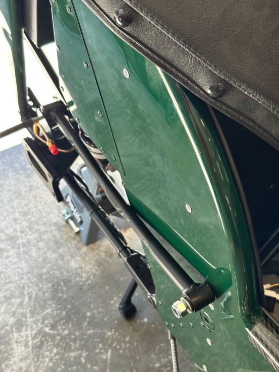

Ha, my brain was off getting headlight fluid More progress, but some issues with the radius arms both sides are rubbing against the frame/side of the car - this doesn't seem right to me, anyone faced this before? There is a lot of lateral pressure on both sides (I really had to pull on the dedion tube to even get the second one in. edit: looks like it is an S3 dedion tube 😐

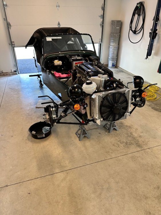

Thanks, I went back to it yesterday and made more progress (Diff, steering column, air box) and managed to get a couple routed well. What I’m fighting is now the routing for the line from the rear of the sump to the bottom of the tank, I’ve tried to copy some of the blogs I see but if I route it by the skin of the car the line is too short and the line kinks or keeping it inside the frame has it rubbing the alternator and belt. Here’s a quick picture of the progress (excuse the headlights, some new LEDs should arrive today).
