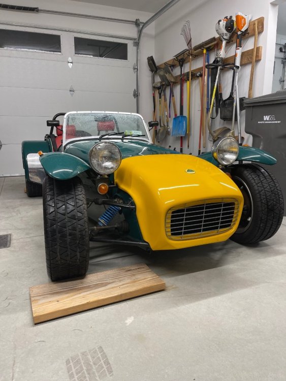

I have been in communication with Caterham regarding the car and Martin has been exceptionally helpful. He has been able to confirm the car is #42 of 47 Prisoner edition cars. The kit was delivered to the US in the summer of 94 and the engine and transmission were supplied by Caterham in early 1995. It’s nice to have a bit of history on the car. I was also able to get the build sheet and some shipping info as well. The folks at Caterham are fantastic. The only remaining mystery is how I ended up with a Prisoner Edition plaque numbered 14 rather than 42.
I like the yellow nose but unfortunately I don’t know the name of the color. I believe the color scheme was Prisoner specific so perhaps Caterham can tell you what yellow they used for the Prisoner edition cars.

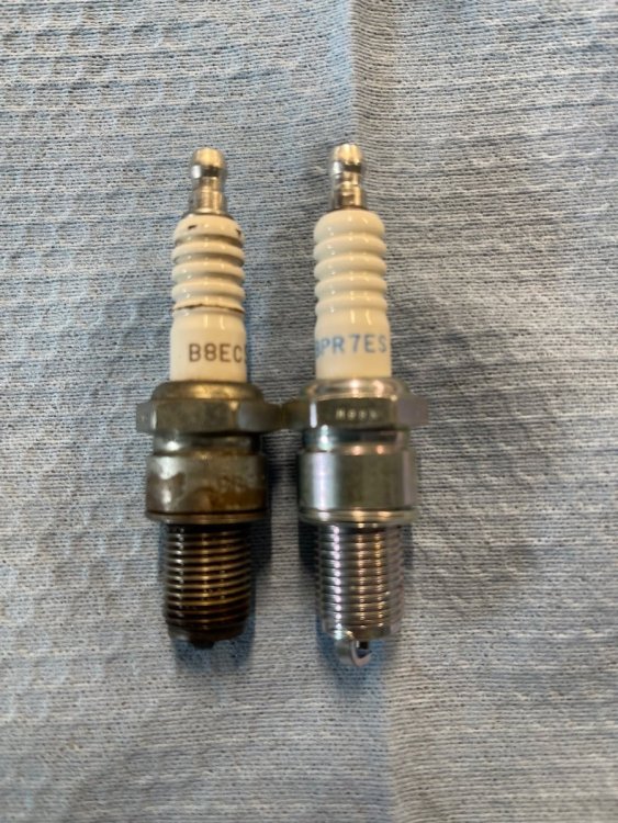

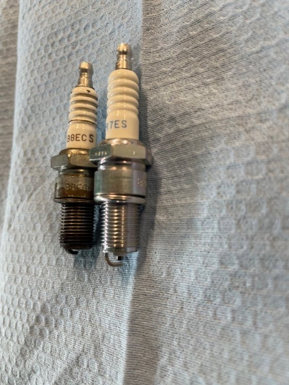

Thanks. I will take a look at that plug. Part of the reason to consider the BPR7ES was to go a heat range hotter. -
Newbie question. I have an early nineties 1700 crossflow. Plugs could stand replacement. B8EC S stock plugs aren’t readily available but I found a set of BPR7ES that some suggest are a good replacement option. However when I lay them next to each other I noticed that the 7ECS plug tip extends farther than the 8ECS. (See photo). If I install these will I have a clearance problem? Thanks.
