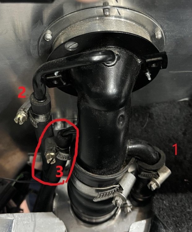

  5. Oh my… Mike, that’s a lot of knowledge! Thank you so much! Yes, this is a Zetec from 2002, and the original tank rusted and was replaced by the previous owner. When filling up, I have to go easy on the pump, or else it spills out. It seems the pump’s flow is bigger than the tank’s intake capacity. When that happens, hose #3 fills up and slowly drips down. So if I don’t need it… First, I’ll make sure the vents are all connected right, then plug it shut. Yet another winter project!
  6. Hello all, the car is a super seven, superlight R, 2002, and this is my tank's neck. #1 seems to be the tank's air return. #2 goes to the front of the car, so I'm hoping it's going into the charcoal canister. The problem is #3 -- what is this? Currently, this hose goes nowhere, just hangs under the car … plugged with a screw, and is obviously leaking. Where should it go to? thanks,
