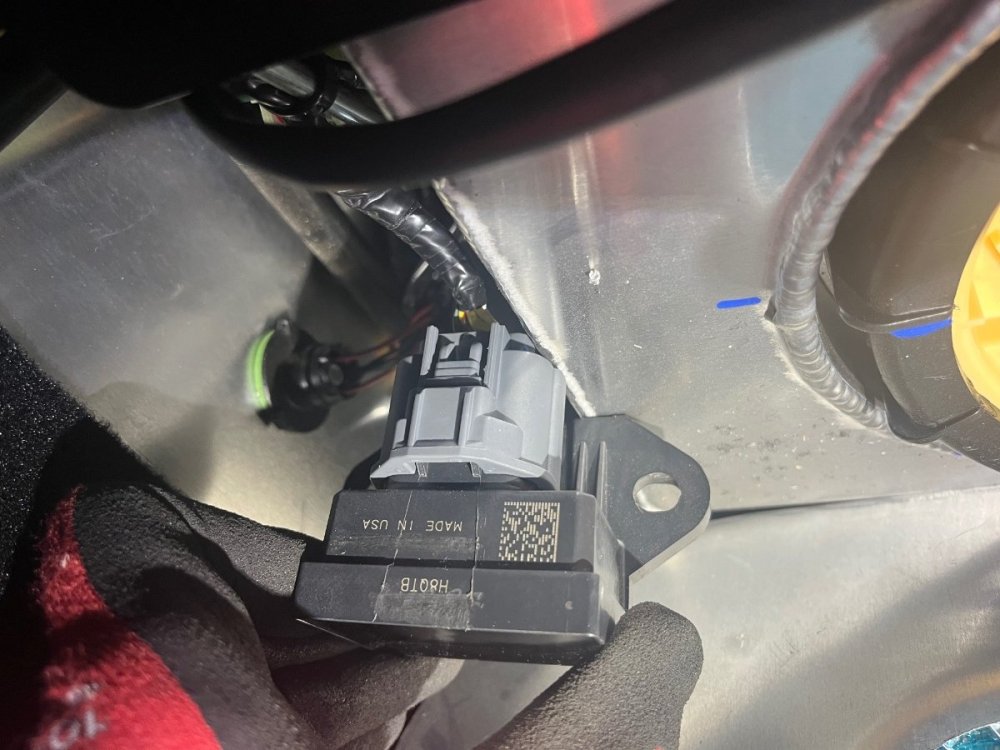

Quick question: what are these two connectors supposed to be used? I believe one is for the oil tank temp sensor which is currently not being used. They are harnessed really close, one is black, the other is double black/tan. -

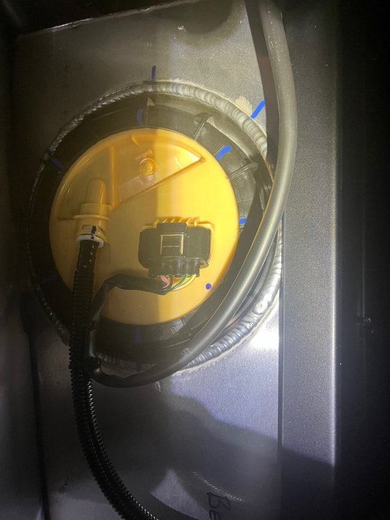

@CatManDo With the ignition off, checking at the dash between green/black and ground, I am seeing 0 V and actually getting 470 Ohms (tank is full now, so that might be right). With the ignition on, I am seeing 0.001 V (its repeatable positive and negative flipping the leads) and am seeing the 1.3 Mohms one way and no resistance with the leads flipped. I undid the zip ties at the back of the car to loosen the harnesses and connector at the tank. Struggling to get the connector apart because it's got a locking tooth on 3 sides So, no readings, but all the wires and colors are correct. -

So, I checked the green/black to ground at the gauge and got a massive resistance of 1.2 Mohms. When I checked it at the track it was the expected 220 ohms for a partially full tank. I think the wire got mixed up somewhere. Any stops along the way? I know it goes into a mystery unit back by the tank (fuel pump relay?) -

Thanks for the wires! It’s so odd how they skipped pins. Six pin connector and they use 2,3,5,6. Anyways, got resistance of 220 ohms and lifted one side of the car and got 225 ohms. Mostly just a check for the float to be working. Working from there to the dash, where should I chase it next? -
