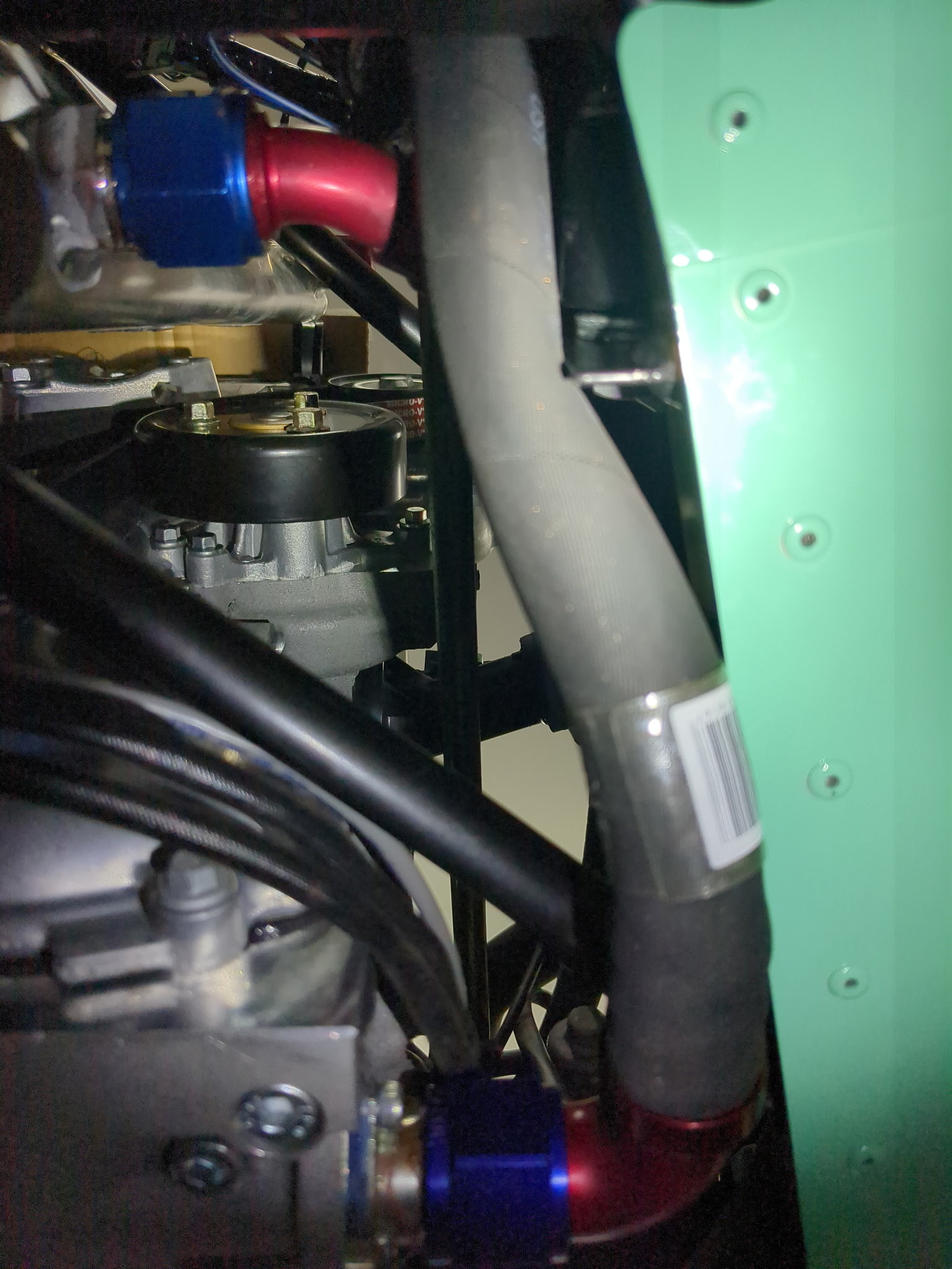

  1. Still waiting on a new water block and temp sender 😭 but made plenty of progress still without being able to try and fire her up. Rear fenders on, started installing the seats but stopped after one to await delivery of some crutch straps, carpet, tunnel, mirrors are on! Plumbing is done except for the water block, but I've a lingering question about one of the oil hoses: Does anyone have recommendations on how to route the dry sump to radiator hose? It seems to be getting kinked slightly by the frame, but as far as I can tell it's in the right place. One of the build blogs actually cuts the bracket edge off to remove the piece that is pinching the hose, but seeking why other advice before breaking out the Dremel again.. I can run the hose below the bracket but then it's hanging below the car which seems unwise
