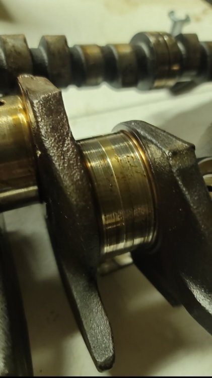

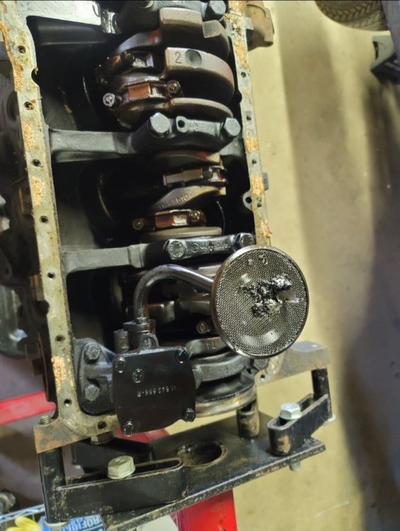

  2. I recently discovered why the one engine was pulled last night. I plan to pull the other engine that is in the car currently to try and get it unseized tonight. The top end of the first engine was "good" and intact, it was definitely dry and in need of cleaning. Lifters and cam seem good as I don't know if I can say the same for the other engine right now. Once I can hopefully confirm that rusty lifters are what is stopping the second engine from turning over, I can likely piece together a good engine with all the parts I have right now without having to find a good machine shop around me. If I do decide to stay with this platform though I do have a nice block that's ready to be built and a crank that is ready/needs to be ground down to allow more generous oil clearances. I need to grab my micrometer to see if it is salvageable though. Nice view of where one of the rod bearings from lucky rod #6 ended up. You can even see the height of the groves left by the mains on this journal, not good!

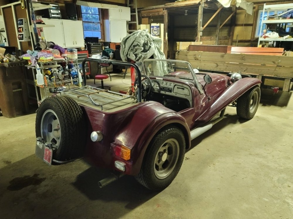

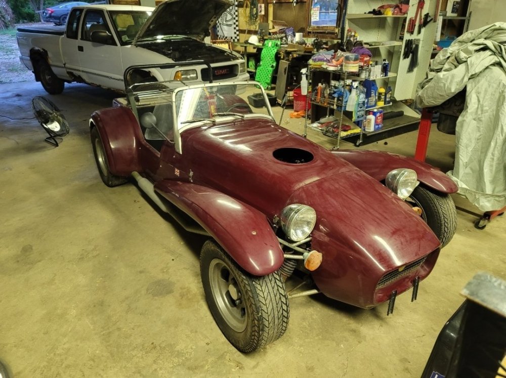

  5. Hello all, I picked up this 1990 Westfield SE yesterday and have been dying to get it running. It has 2 2.6L Cologne engines, one installed and another on an engine stand. Both need a good bit of cleaning and likely a top end rebuild as they have been sitting for a number of years without valve covers on. My main issue I am seeing is that these 2.6L engines were not put in much at all and don't seem to have a good aftermarket support. I'm pretty sure its paired to a ford type 9 5 speed as reverse is on the left, however I am not familiar with these and haven't checked any casting numbers/letters to make sure. This leads to recommendations on what drivetrain I should put in this guy. My buddy has a liter bike powered locost and that thing is pretty sick however performing this swap would cost a bit and definitely make this a winter project. I could alternately get a 2.8L or 2.9L cologne from a ranger/mustang/capri and have some aftermarket support but thats really my only option with aftermarket considering the bell housing pattern of the cologne V6. I am also considering a Miata drivetrain swap as that has loads of aftermarket parts that are readily available about anywhere. Just starting off so I've got a world full of possibilities and no/minimal lotus 7 experience to base any decisions off of so any and all advice is appreciated!
