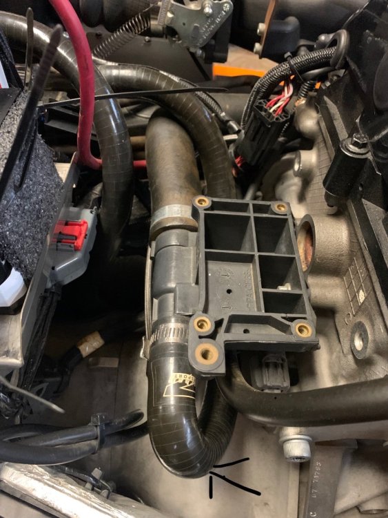

  9. The attached photo shows a coolant hose identified by a black arrow and labeled Caterham Motorsport. It has a slow leak at the bottom. I've been searching online for a replacement but have found nothing similar yet including it appears Caterham Parts and Beachman. The hose has two significant bends including a 180 under the plastic box and then up and to the left. The car is a 2014. If anyone has an idea of another seller of these please let me know. Much appreciated.
