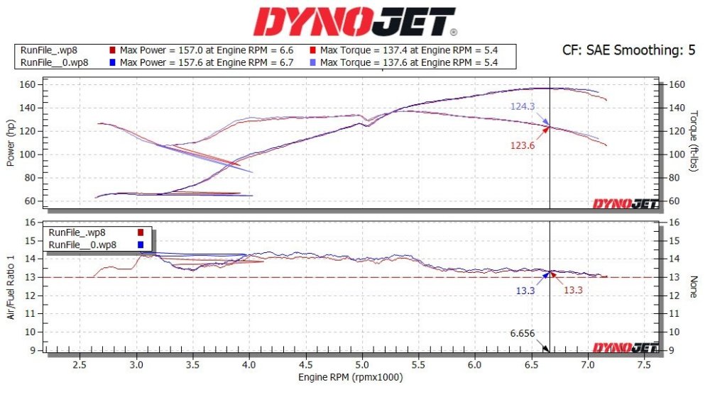

Club Member

  1. I have spent a little more time inspecting this Caterham. All of the external SVT hardware seems to be there. The intake with control cable and module is present as is the cam solenoid. MAF, EGO sensors and cat all look OEM. It dyno’d 157hp/137tq at the rear wheels. This seems in line with the sellers statement of 185hp at the engine if one assumes 15% losses. Will continue investigating. Any recommendations on tools to use to inspect the tune?
