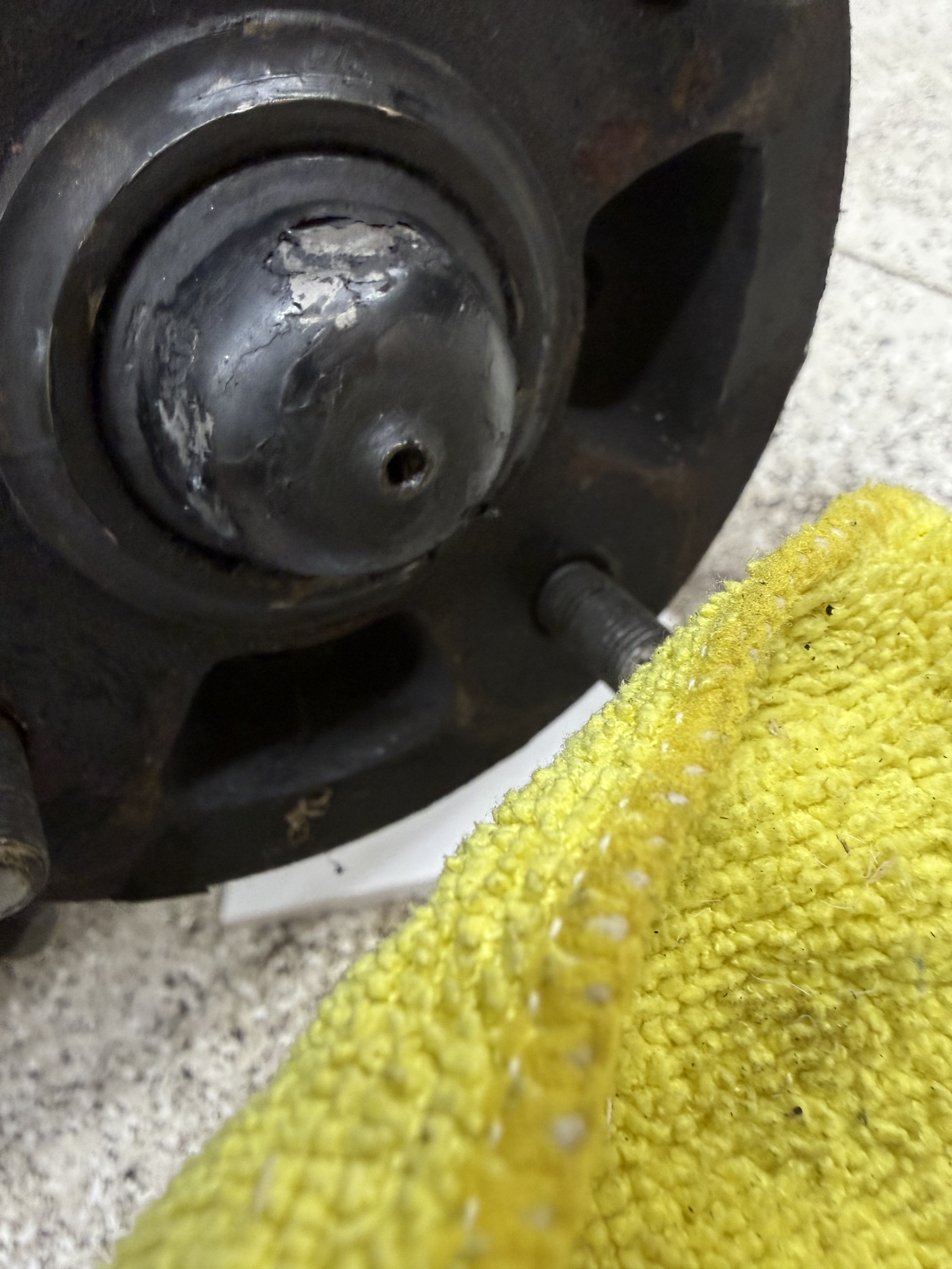

When researching a replacement grease cap, ChatGPT told me that I was supposed to thread in a #10 UNF screw and push them out. That sounds great, but for one of these, I don't think the screw would have survived. The cap was practically welded in.

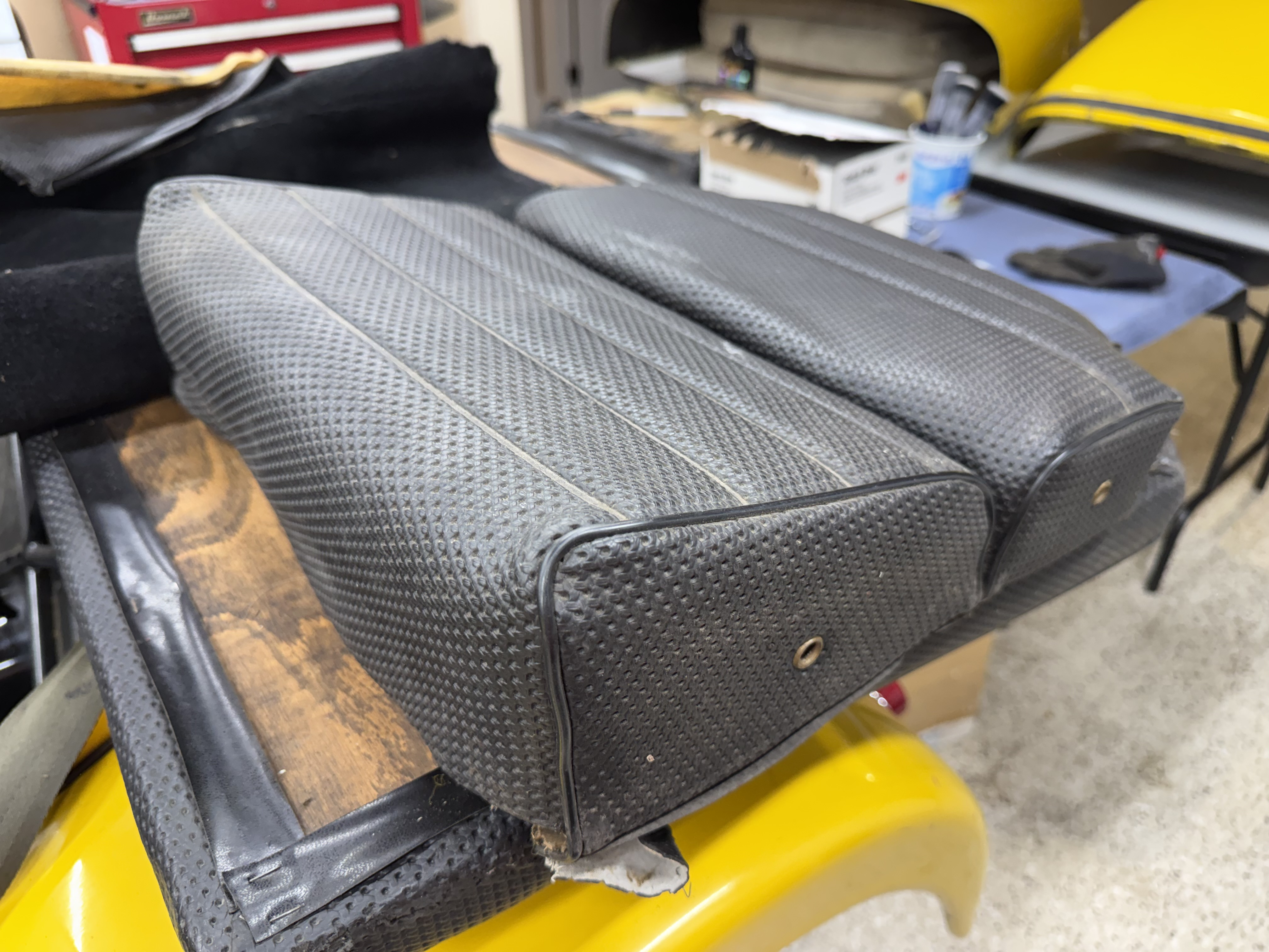

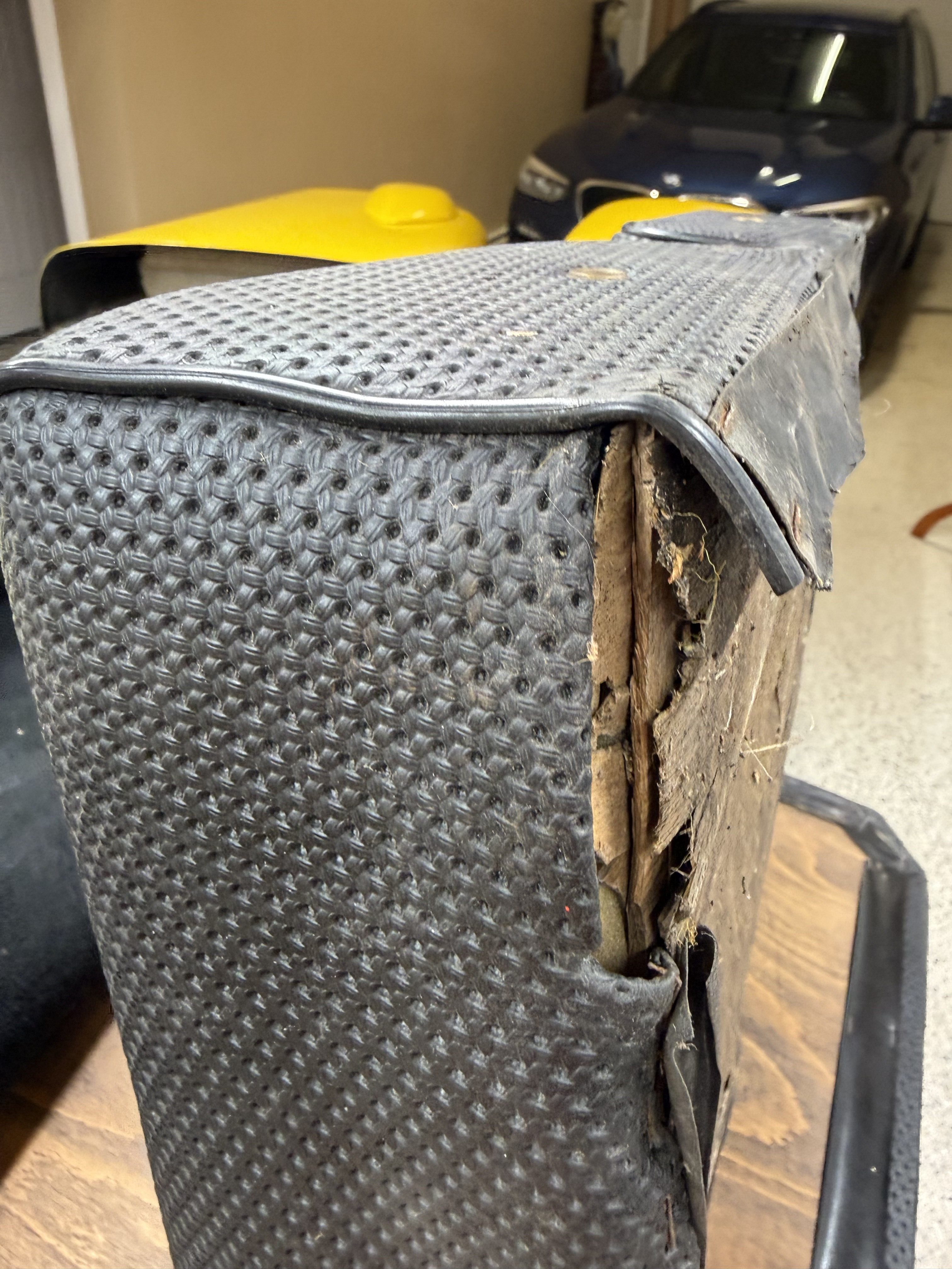

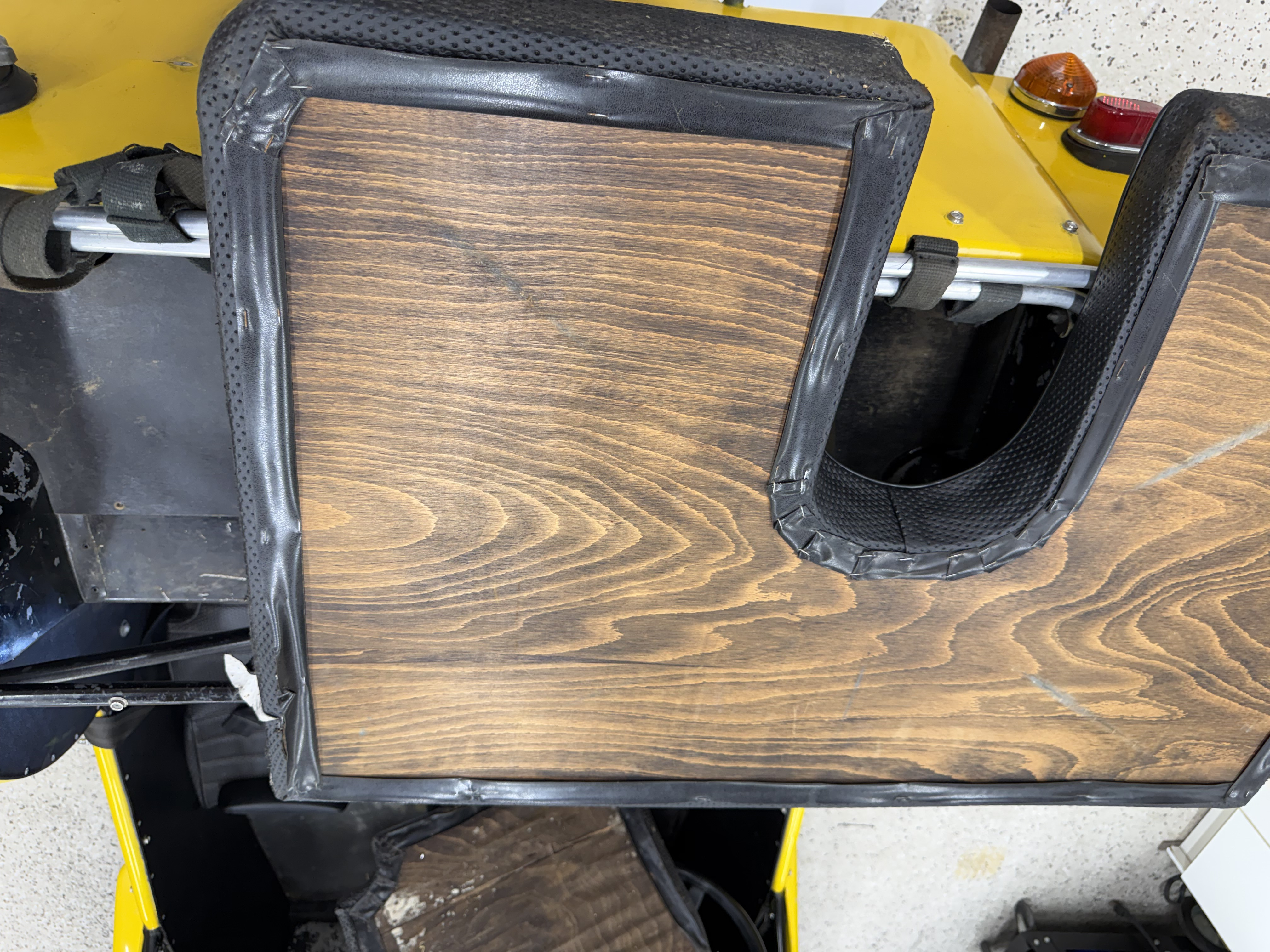

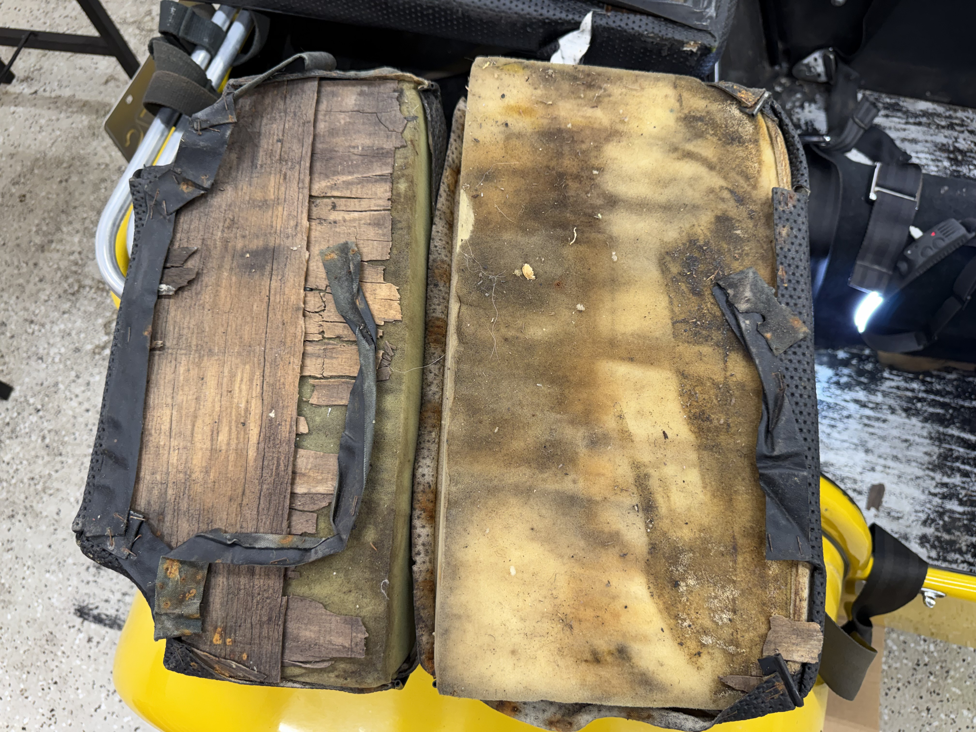

Time to think about seat restoration. One of the seats will be good for a pattern. The other has disintegrated. ChatGPT suggests using two different types of foam for the seats and gluing it together. The vinyl material is in good shape. I can make up the plywood. Marine grade treated is recommended, but I only need a few square feet. Does anyone know what the black plastic material is that is stapled on the bottom? Here are some pictures of the current state:

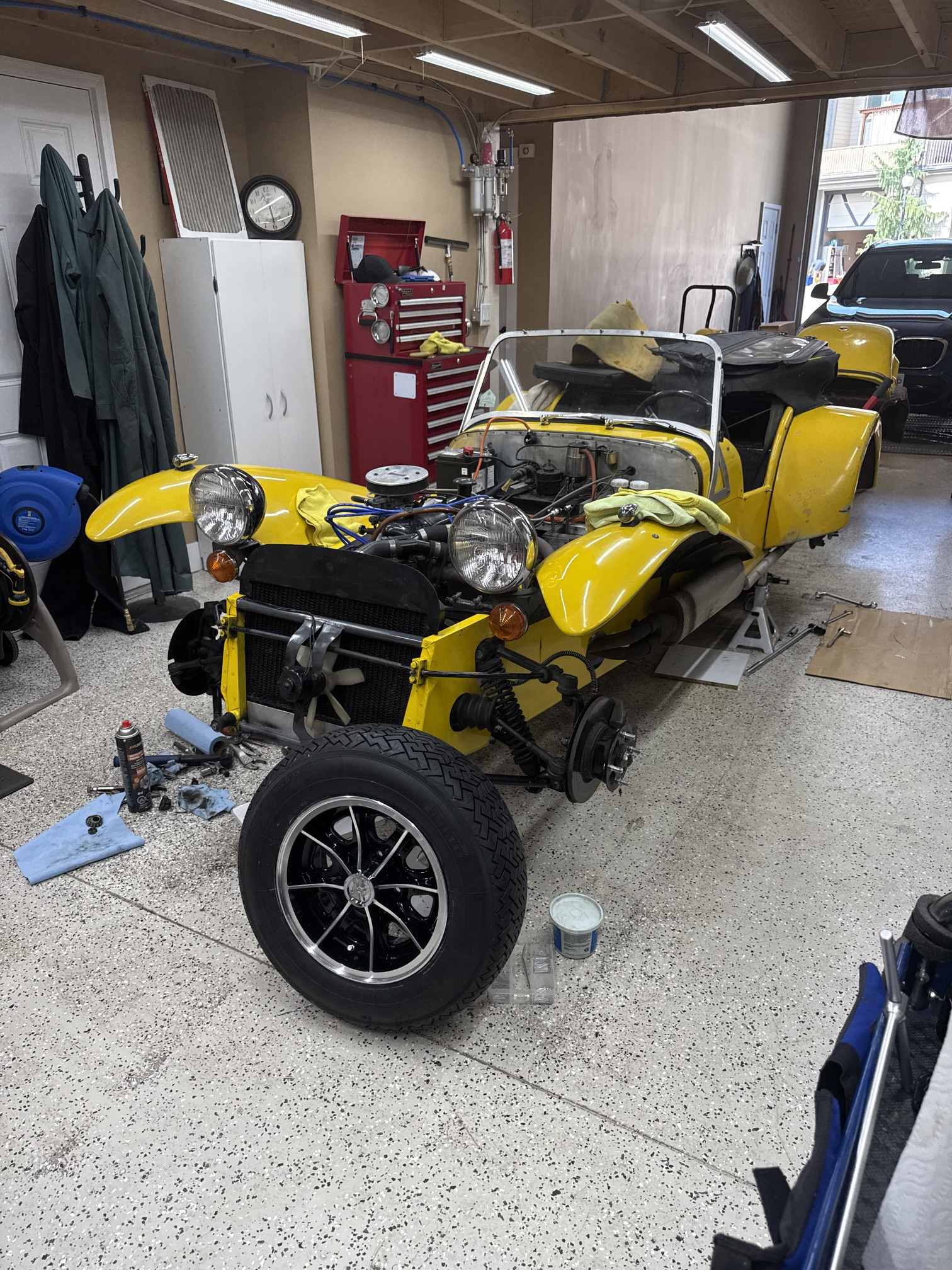

I thought I should post a picture of my Lotus' current state. I got the JBW wheels. They are great. But the wheel studs are too short, so in this picture you can see that I have new studs installed on the front left, and I'm working on the front right. I have some parts on order from Caterhamparts.co.uk, because I want to get it back on the road. I was shocked at the shipping charge from them. It makes no sense. I can order 5 Pirelli tires from the UK and pay 150 pounds for shipping. To get 3 kgs of parts from Caterham cost 90 pounds? I spoke to Ken at DaveBean.com and he reassured me that most parts for my car are available. I sent 3 different messages to Redline and have had no response yet (Email, WhatsApp, and online form). It was a holiday in the UK yesterday, so he may be a little behind. Does anyone have any idea how to remove these dust caps without causing damage? I have not succeeded in getting them out without making a mess. I suspect I am the first to remove them in 56 years. The grease is not pretty, but the bearings seem Ok.

I have the JBW wheels on new Pirellis, and they look great. New wheel studs coming tomorrow. I was only getting 3 turns of the wheel nuts on the front wheels, so they needed to be replaced with 1 1/2" studs. I have been searching for high quality yellow/green Lotus wheel centre caps, but have not had any success. Does anyone know who stocks them? I think I need 50mm diameter caps to fit the wheels.

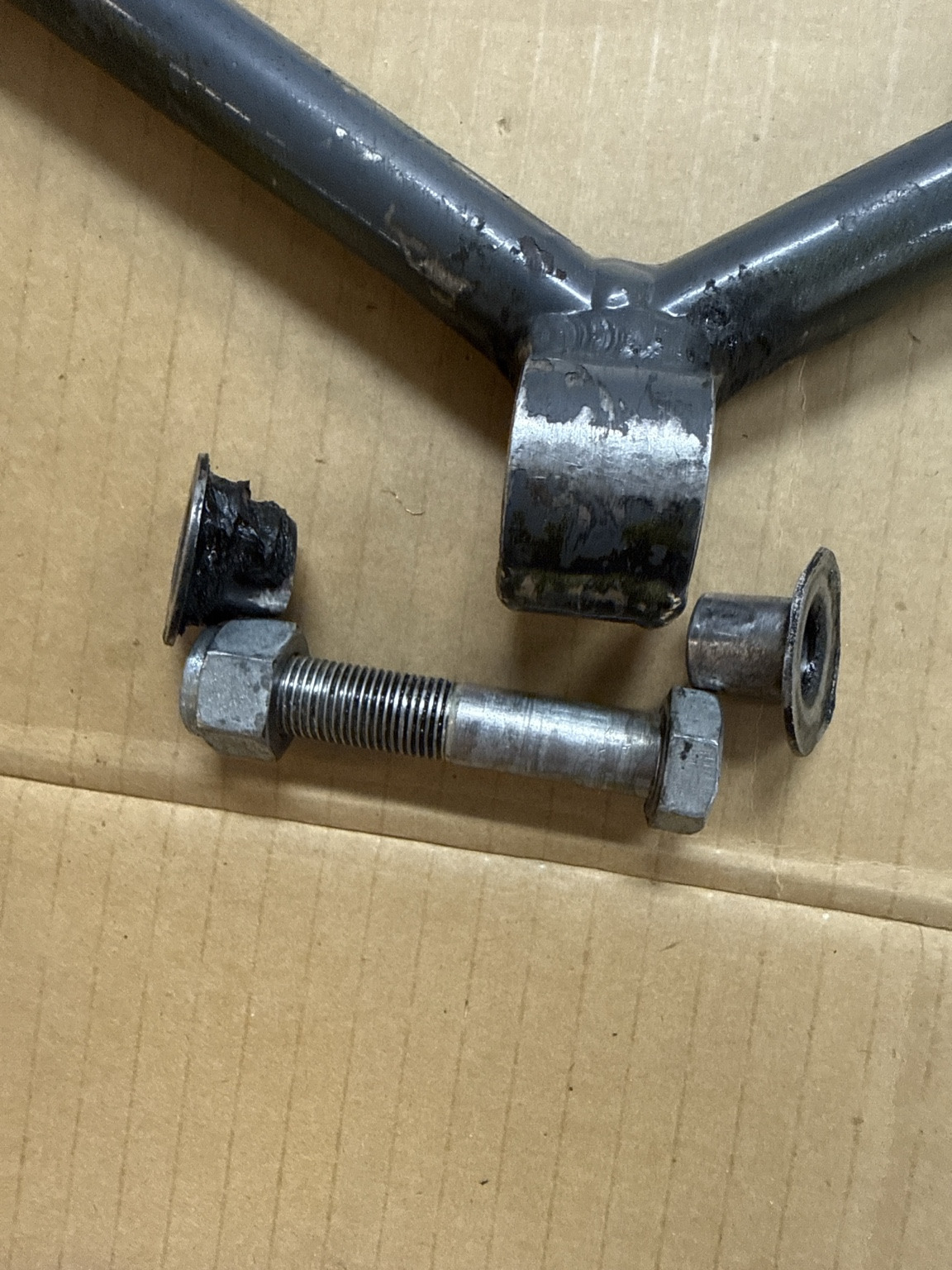

I have been gradually working through the car checking and learning. I purchased on Bring A Trailer. The owner would not allow an inspection of the car and the driving videos were suspiciously short. I knew all was not going to be good. In my only short road test I noticed a nasty clunk under the rear end. I pulled off the A frame and these are probably as bad as you can get without falling off. Searching for parts now... I called Dave Bean, and received a message that they are only open on Mondays and Tuesdays. Are they still supplying bits for Sevens? Their web site is a return to the '90s. I sent a message to Redline, but have had no response. It appears that Caterhamparts.co.uk has some of the parts, but not the bushings at the forward two A frame mounts. Any other suggestions? Any help greatly appreciated.
