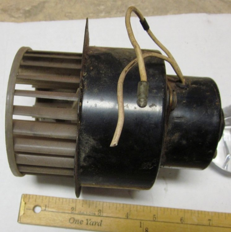

I've included some pics of my 70's spitfire heater. An early heater could be made using spitfire parts in a new box made of .050 sheet steel or aluminum. The spitfire box has too many openings and the motor/core arrangement is the opposite, so it would be easier and cleaner just to make a new box. The core pipes are longer and curved but they could be shortened to look original or left as-is if the box is installed with the pipes pointing toward the engine.
Some early fans have a bladed fan versus a "squirrel cage" with baffles in the box that should be swapped to the new box or fabricated.
