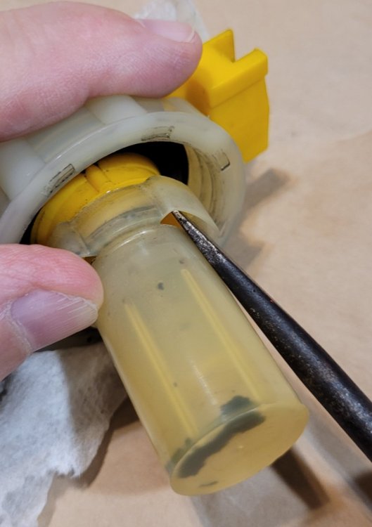

My old MC cap with level switch was dirty with gunk.
Yes, time for Q-Tips!
Prying here may not have been necessary, but this and a little tug, the basket releases.

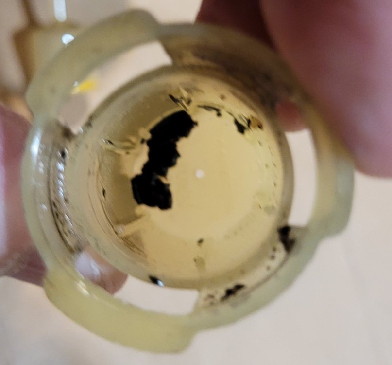

The float stays attached to the head.
Gunk.

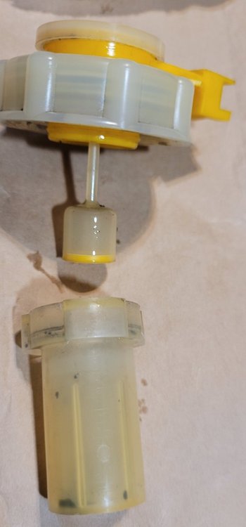

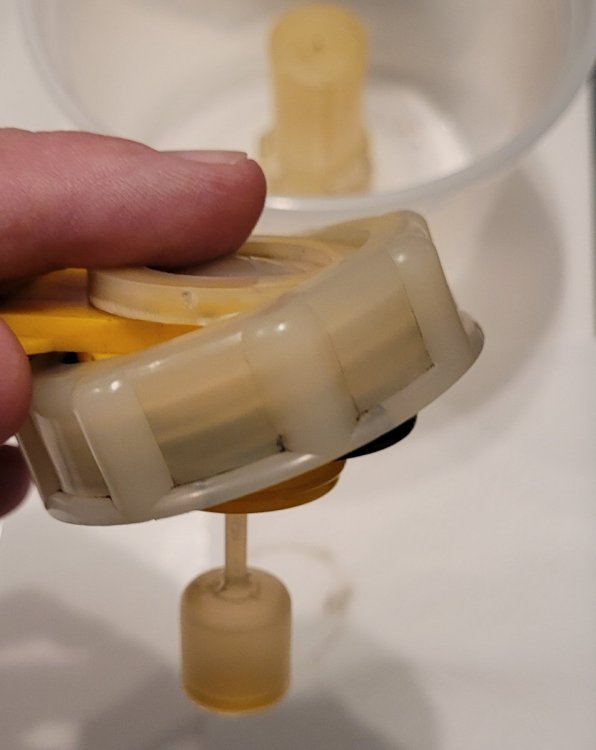

The head and gasket pop out with a push from above.

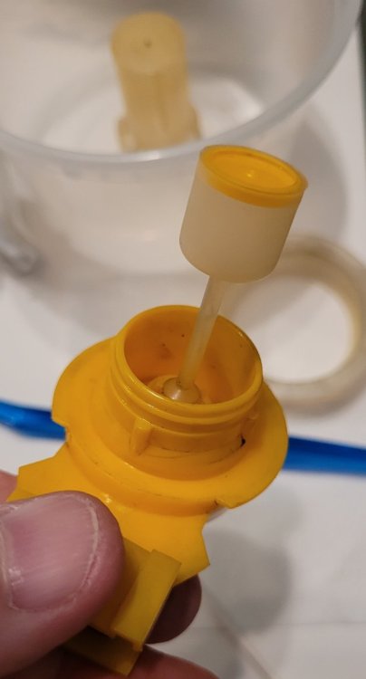

when using Q-Tips, don't leave any cotton fibers in the parts.

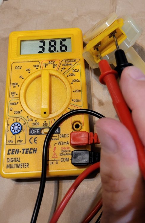

Check the switch for function.
A simple on/off switch.  Float on bottom should show current.  Makes the light go on.
