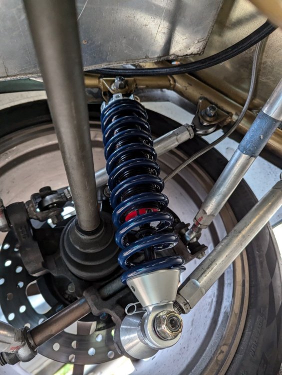

MV8 Posted November 1, 2024 Share Posted November 1, 2024 (edited) The bottom bolt is too short. Is there a washer added between the link rod end and the coilover? Definitely need a shorter spring. Edited November 1, 2024 by MV8 Link to comment Share on other sites More sharing options...
nc7s4 Posted November 1, 2024 Author Share Posted November 1, 2024 Yup. That's all getting reworked as we speak. Just a mock up in the pic. Fastenal has my 7" long 1/2" grade 8 bolts ready for me to pick up today. Also going to add a couple small spacers for the bearings. Car came with 6" bolts - all images I've seen have this issue Link to comment Share on other sites More sharing options...
