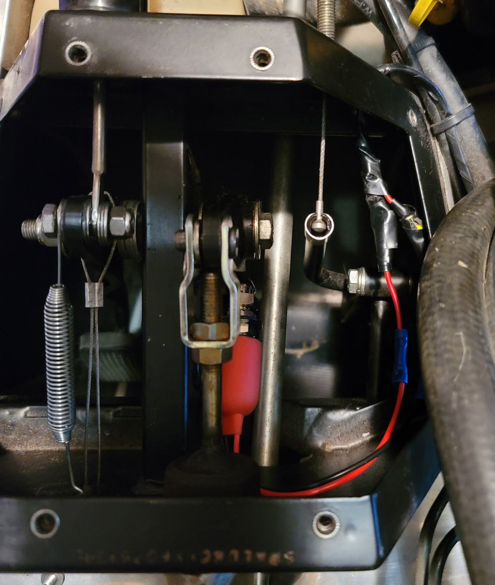

Over the last 6-8 weeks people have said I had no brake lights but both the wife and I checked later and they worked. On Monday night at the local Car Show people mentioned the brake lights and sure enough, they were stuck on, again.
This time I took everything apart and discovered that the last mechanic had jammed the switch between the end of the pedal box and the brake arm. He damaged something inside and it was hit and miss for a time and now it was totally broken.

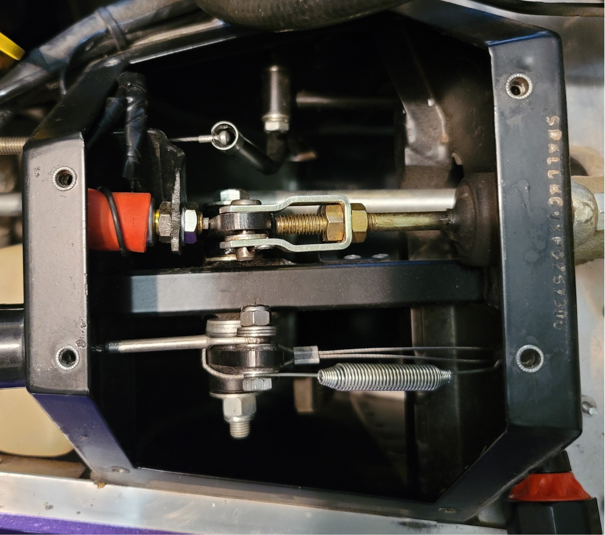

I tracked down the switch part #, which is available from Canadian Tire for $14.97. Funny the choke cable that the first mechanic also installed came from Canadian Tire too.
Canadian Tire said I had to order it on-line and have it shipped to the store where I would pick it up in 10 to 12 days. Luckily I found a local Motorcycle shop that got it in two days for about $20.00 out the door. It took some time to get it positioned just right but I finally got it working. I really wish I had a lift because the car is just that much too low to bend over to work on.
Now, here is where I get pissed. Looking back at my bill from 2024 I paid over $500 for parts and labour to have a bracket fabricated to mount a Canadian Tire switch (used on quads and snowmobiles) that wasn’t as good as advertised. Furthermore, looking around I found there already was a factory riveted brake light switch bracket in my car. So why did that first mechanic think he needed to fabricate and relocate the brake switch?

I’ve attached photos showing the first brake switch location and then the second, factory location with my new switch installed.
