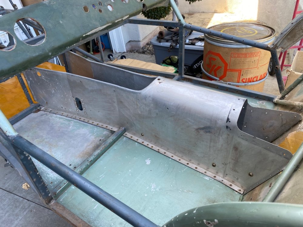

  1. Hi, I had read this same story. Looking at the chassis it clearly seems to be missing what might seem to be ‘obvious’ tubes. The one at the bottom of the seat back is arguably the most obvious, but there are several panels that lack triangulation. I will be looking carefully at adding some tubes to the chassis in an attempt to gain back some stiffness. What I don’t want to do is loose the ‘essence of 7’ that I’m sure is partially because of the flexi-flyer nature of the car. I will also keep a careful eye on the additional weight I’ll be adding back. Ian

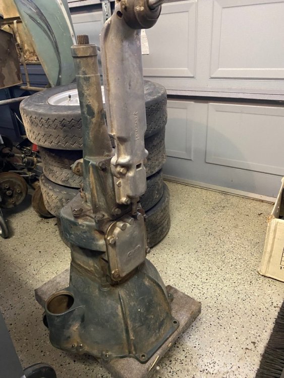

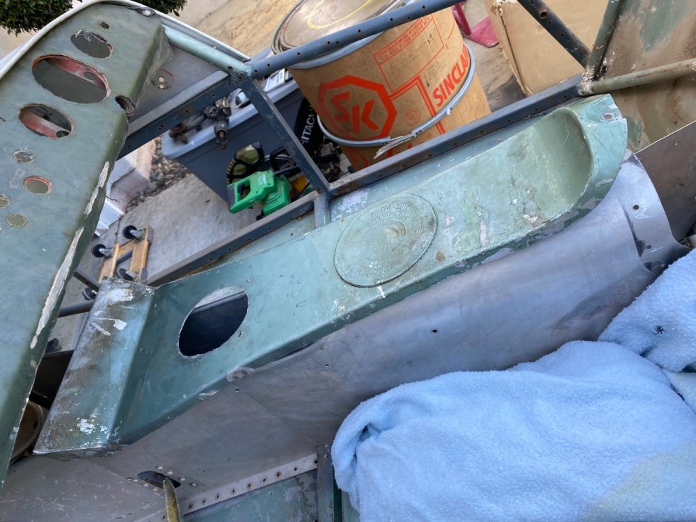

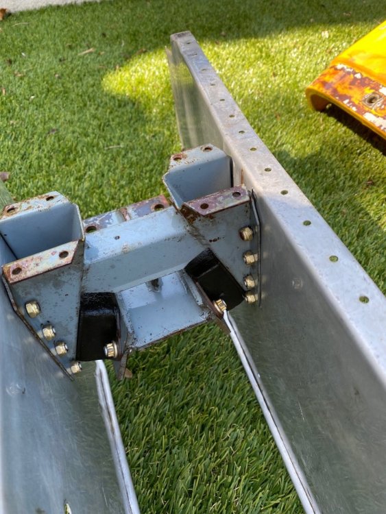

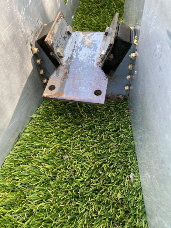

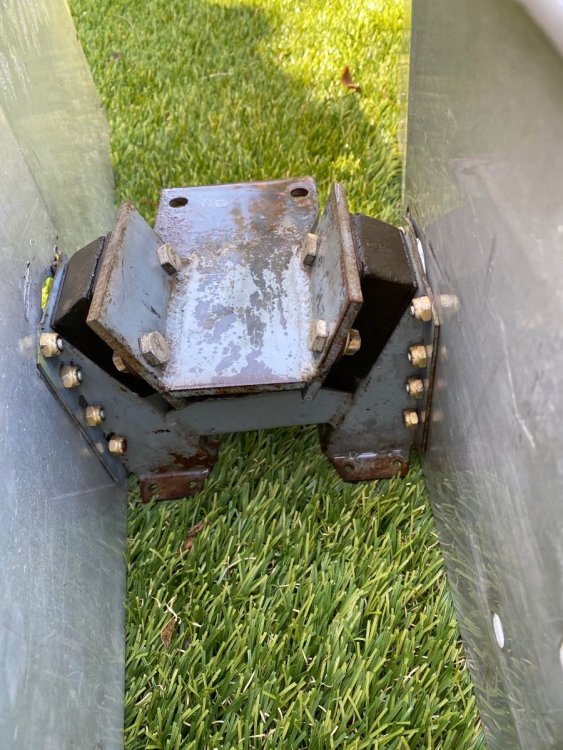

  2. Hi, This would make sense! This car was originally a BMC powered car. I have a quite well engineered, if a bit on the heavy side, gearbox mount that is attached to the tunnel. It certainly appears to be a retrofit. Looking at the mount again in these photos, it seems like part of it might be original and only the very heavy part is the retrofit to adapt to the gearbox change. I just need to mock this up to figure it out, but I think the flat cover is not going to work with this combination. So, a round cover may have to be made. Ian
  3. Hi, Yes, my gearbox has the Triumph shifter extension, and there is a hole under the patch. The rat-hole that is further forward is too far forward to be for a shifter. The forward vertical face of the scuttle is at the center of the hole. Something is not adding up here! Ian
  4. I’ve taken a look at some pictures of the Lotus 7 ‘America’ cars that had the same engine and gearbox as my car when shipped. The gear lever seemed to be in about the same position as the ‘patch’ on my scuttle cover. It also seemed to be in about the right position, just a touch forward of the dash. If my current engine/gearbox puts the gear lever in the rat-hole I’m going to need to grow my left arm about 6”! Something is not adding up here . . . I think I’ll take some measurements and see if I can make any sense from this. I wonder if anyone has a definitive dimension foe/aft for the engine. Rear face of the block is a common datum. The mystery persists! Ian
  5. Given that this car originally had a BMC A-Series engine and whatever gearbox that came with, but was converted to the 105E and Ford ‘box, I assume it was the previous shift position. It’s not made to be quickly removable, it glued on there! The new hole, a fair bit further forward look like it was made by a trained rat on acid! I’ll leave that mental image with you . . . . Ian

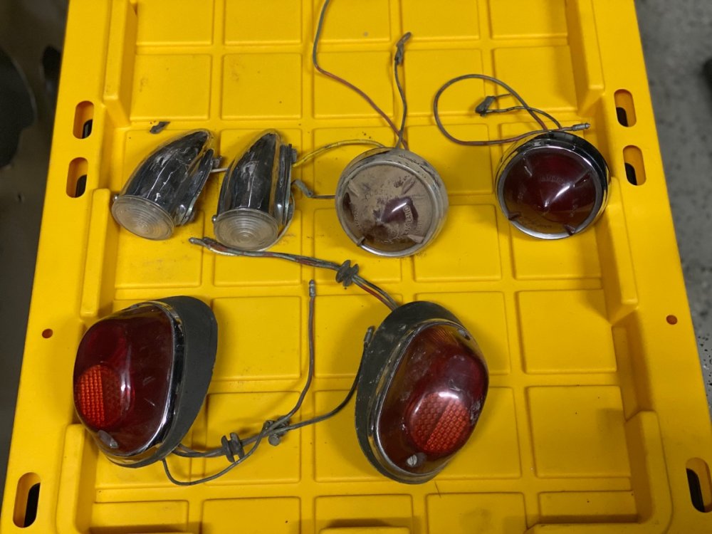

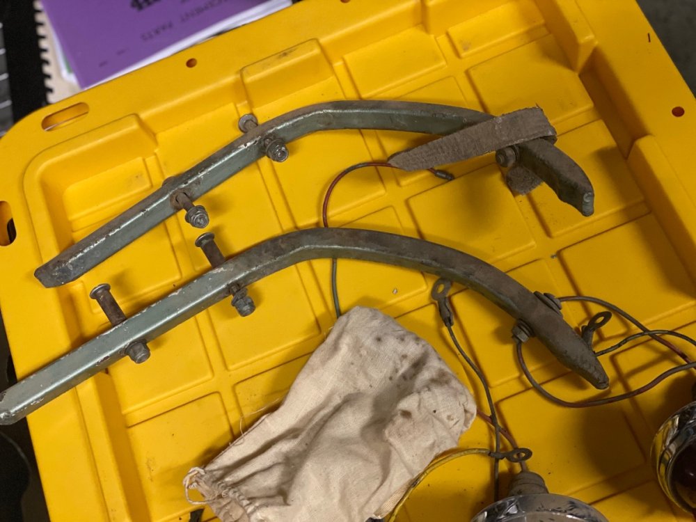

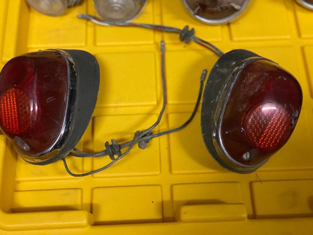

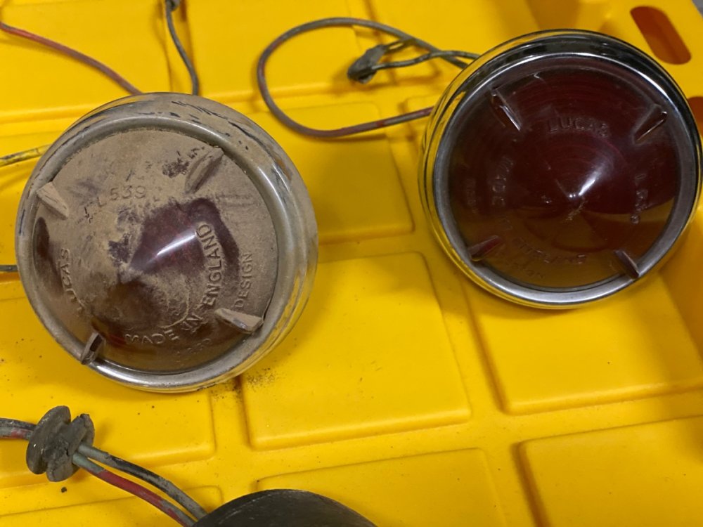

  6. I have no doubt that these are original parts, they are quite beautifully made. I did see something about someone reproducing the tail lights, but what I read seemed to indicate it was just the lens and rubber mount. These need to be cleaned a little and can go straight back on the car, they are that good condition! Ian

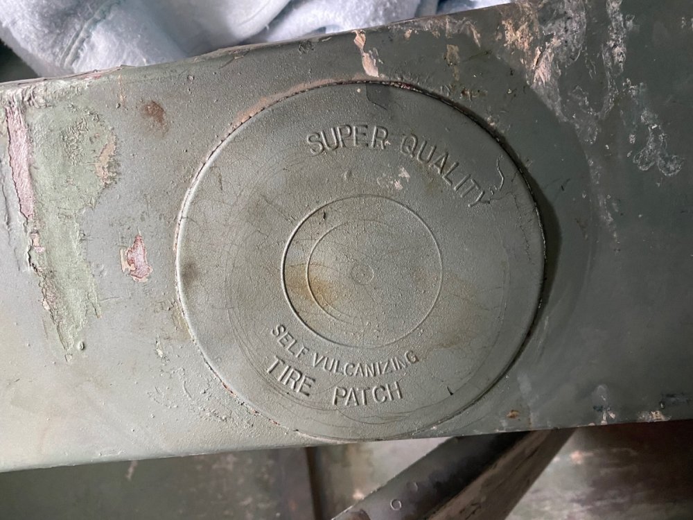

  7. And for those that asked about the ‘medallion’ on the scuttle cover . . . . Ian

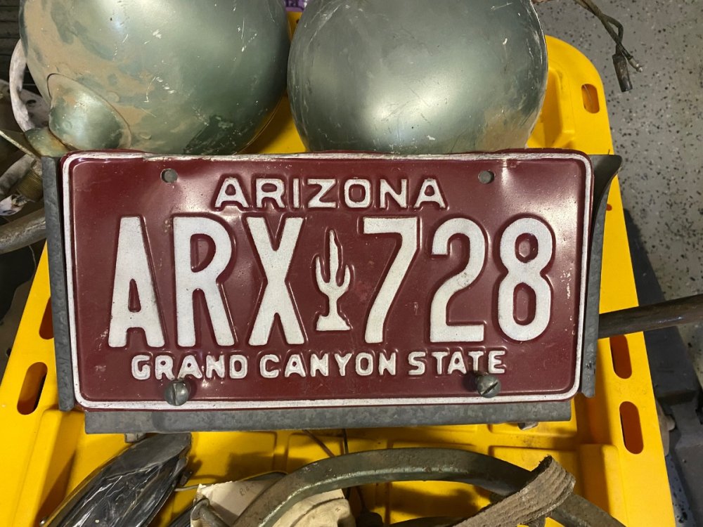

  8. Found this too! It’ll look good in the collection on the wall! I wonder if the AZ DMV has any records . . . The more I dig in to this pile of parts the more certain I am of its complete authenticity. I am very confused as the why the ‘arbiters of originality’ were so convinced I should not buy this car. Just because the plate is missing/misplaced doesn’t minimize the originality of the vehicle. I do understand that the Lotus Chassis number that this frame number was connected to in the Lotus Records is currently running around somewhere, so a totally authentic ‘plate’! Alternatively, the title that I have only a photo of and is one number later, 19 Vs 18, is what it was on the Lotus plate and therefor issued by the State of Arizona. It’s not beyond Lotus to mix up the numbers! My Elan was wrongly recorded too! Very confusing! Ian

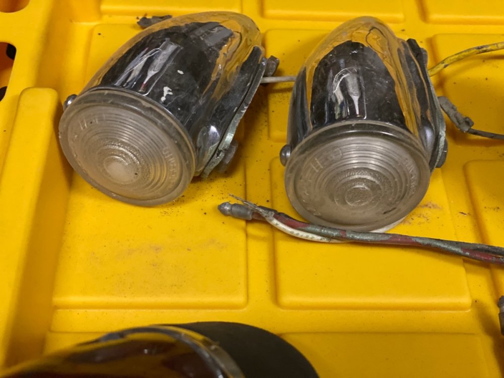

  9. A nice discovery when unpacking a box last night! All the original lights are present and all in very nice condition! I heard the rear lights are not available so I’m very happy to have original parts. Ian

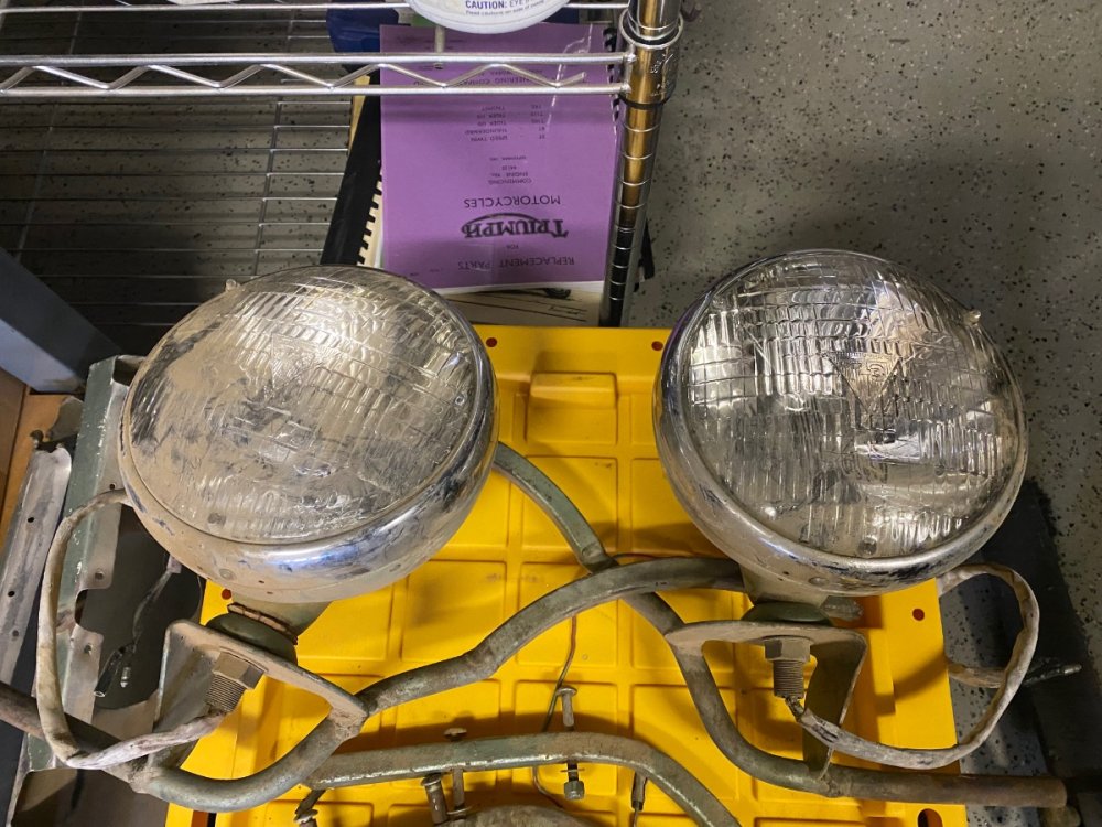

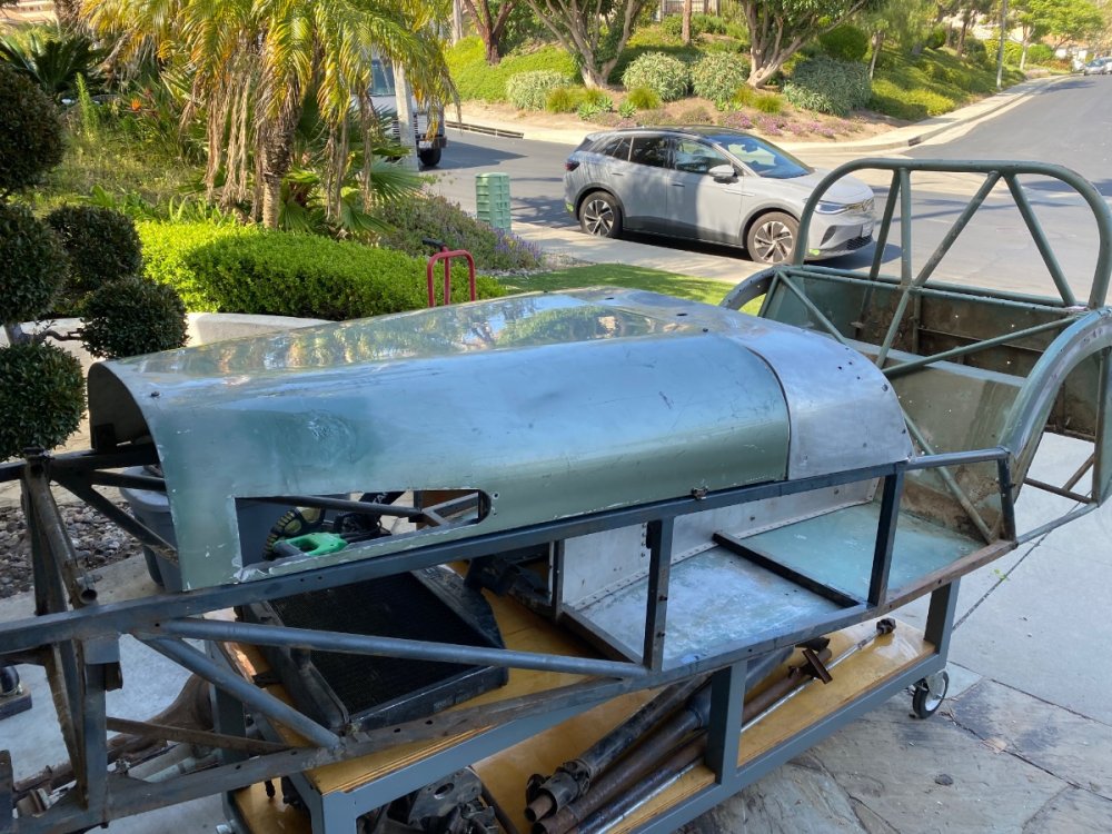

  14. I’ve been going through the parts and trying to figure out what parts I have and what parts I’m missing. Fortunately the former list is considerably longer than the latter! There certainly are some missing items which will have to be found, and some that I have that will need to be replaced. Who are the the best suppliers for S2 7 parts in the US and/or the UK? Is it the same suppliers as for my ‘66 Elan? I’m still formulating the plan for the chassis. There is damage that needs to be repaired and I do want to add some reinforcements, add some triangulation etc. The question is will it be better to send it to Arch (even though they didn’t build it originally) and have them fix everything (some new paneling too), do the work myself or is there a US fabricator that has a track record with these frames? Some of the paneling is in surprisingly decent shape, some is in almost useable condition, and some is just rough! If I send the frame to Arch the solution is simple. The other options are not so straightforward, and it depends on if the finished objective is fully painted, part aluminum and part painted. The hood has some damage that probably prevents it being aluminum. The scuttle I think could be but it will have the scars of 62 years, I’m OK with that! The rear panel is quite straight and damage free, but has been painted. I’m going to try and remove the paint and see how the aluminum looks before making a decision. The side panels are rough and will need to be replaced. There’s lots to think about, plans to be made etc. but that’s all part of the fun isn’t it? Isn’t it?

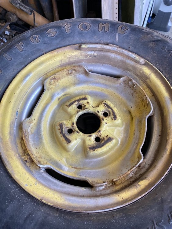

  16. I just measured the bolt P.C.D. and can confirm that both front and rear are 3.75”. Decisions on wheel are way down the road . . . Ian SoCal

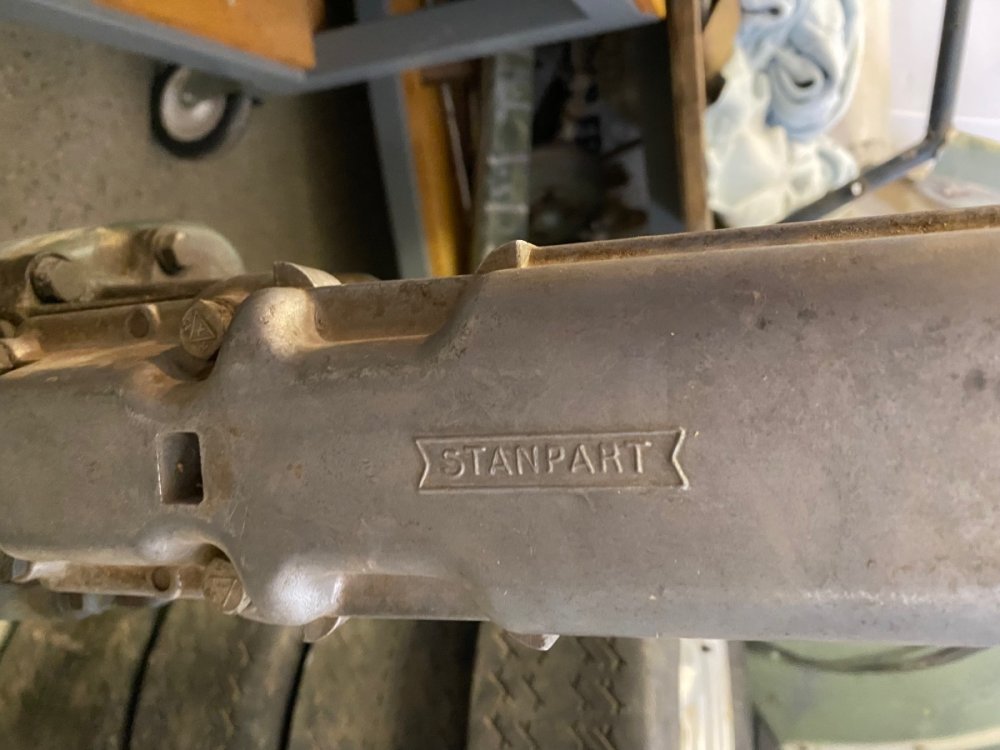

  20. Hi, The rear axle is Standard 10, I even was provided with a spare. I’ll check the bolt pattern on both but I think they will be Triumph, both ends. I’m not sure what look I’ll be going for, I quite like steel wheels and hub caps for a very period look on S2’s, I do have some steel bolt on Lotus wheels and hub cap from my Elan project and could use them, or a set of minilite style wheels would look good too. Ian

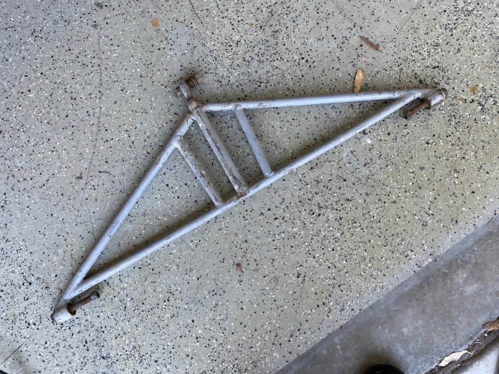

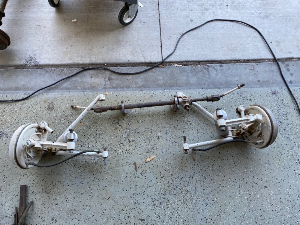

  21. “Do you know what led the owner to disassemble the car when it was still relatively young?” I really don’t! The owner is apparently quite sick and I had no contact with him at all, dealing only with his brother in law. Ian

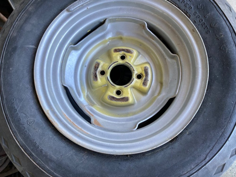

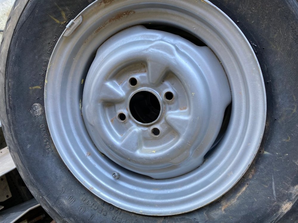

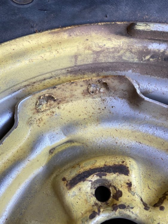

  23. The rear wheels have been modified for greater offset, and not really that well, the fronts seem to be in good shape though. Do these look like the original wheels? If so, are the available new anywhere? It may be that it could get a set of minilite type wheels or some Lotus steel wheels from my Elan if the sizing and offset works out. Ian SoCal Does this look like an original wheel? Nasty modification!
  24. Just a selection of todays unloading/unpacking. The frame needs work, serious work, but it’s far from some I’ve seen that ended up beautifully! Some of the sheet Aluminium is not bad, and some will need to be replaced. Then there will be the paint Vs polish discussion . . . The rear lower frame looks a bit rough and might need to be remade or at least repaired. The front suspension seems to be in good shape. There is an original fuel tank and radiator although the rad has a modification I’ve not seen before. Ian SoCal Front suspension seems complete and in good shape. A bit rough and will need to be repaired.
