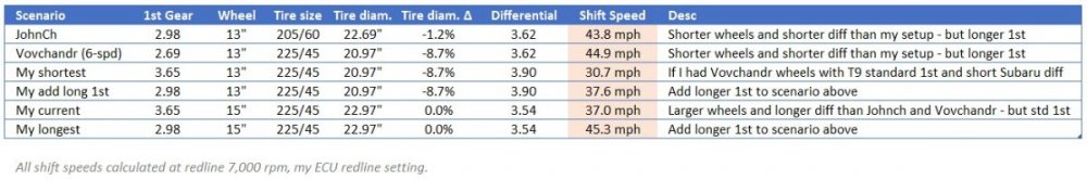

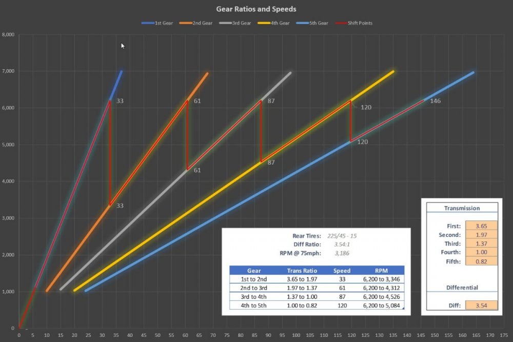

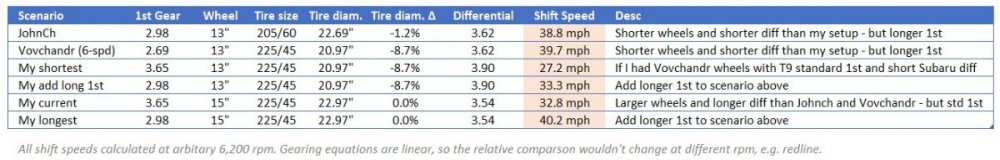

  4. I chose 6,200 rpm as just an arbitrary value and not redline. I did verify with Tom, and you are correct in that he sets the redline for 7,000 rpm. Here is the same analysis with redline 7,000 rpm, instead of the arbitrary 6,200 rpm. Of course the shift speeds go up, but still the same relative differences. Because I wasn't looking for the fastest 2.0L setup, the race cams were the low hanging fruit for an easy/quick way of boosting HP above stock. However, I didn't want to start chasing higher and higher costs of beefing up the internals which would allow me to increase the redline to 8,000 rpm. If I did that, then my taste for power might not stop and I'd end up with a supercharger or turbo, beefy transmission, etc... whew, glad I dodged that rabbit hole Great discussion, and it's good to know my calcs are at least consistent so I'm going into this with eyes wide open and a deeper understanding of pros/cons for the options I'm choosing. Thanks! -b
  5. Great points about gearing! Thanks for the sample values you guys are using... TLDR: My standard short 1st gear isn't quite as bad as it could be because I have larger wheels and a longer diff gear than both JohnCh or Vovchandr. But yes, I could get even longer (actually the longest of all) by choosing the long 1st gear option (long 2.98 rather than 3.65). I had decided that the money for a long 1st wasn't worth it for me, but maybe I'll regret the decision later ? My taller tires and longer diff gear also make highway cruising rpm a bit lower which I had read some people whish they had for a quieter experience. Interestingly for comparison, at 75 mph Vovchandr 6th gear shows 4,642 rpm and my 5th gear shows 3,186 rpm. Vovchandr's top gear (6th) is a 1:1 and my top gear (5th) is an overdrive 0.82:1. Detail: The following is a bit long and meant for me to document my thought process, it's not meant to prove right/wrong as you guys have much more experience and knowledge about all things se7ven, and I do appreciate the dialog! It's also meant for future readers that are also learning and 'getting up to speed' with gearing When calculating shift points, i.e. how fast the car goes in a specific gear when getting to a specific rpm and needing to shift into the next gear, three factors are used. Transmission gearing (a different ratio for each gear) Rear differential gear (a constant value while driving) Tire/Wheel size (a constant value while driving) short - refers to a large gear ratio, which results in slower speeds at same rpm long (tall) - refers to a small gear ratio, which results in faster speeds at same rpm I ran some scenarios using JohnCh and Vovchandr numbers as well as my own using my own spreadsheet (so hopefully they are accurate). I have slightly different gear options since my Birkin transmission and differential aren't the same as Caterham. My setup: Ford T9 transmission with standard gearing: 3.65 (1st), 1.97 (2nd), 1.37 (3rd), 1.0 (4th), 0.82 (5th) Subaru R180 Limited Slip Differential: Choice of short 3.90 or long 3.54 By the numbers I'm in the middle of possibilities as my overall gearing is made longer by going with 225/45 - 15" wheels and I opted for the longest rear diff gear at 3.54 (as opposed to my other option of 3.90 with the R180 LSD). But I'd be much worse off with Vovchandr's 13" wheels and my other option of a shorter 3.90 rear diff. For comparison sake, I assumed a spirited shift point from 1st to 2nd is 6200 rpm. The results of the different scenarios are: So, if had wheels like Vovchandr and didn't choose any long gearing options, I'd be down at 27.2 mph shift speed. Since I have larger wheels and a longer rear diff gear, my current build is at 32.8 mph shift speed. If I did go with a longer 1st gear option, I'd have the longest overall gearing with a shift speed of 40.2 mph. Maybe incorrectly, but I decided the optional cost for upgrading to a long 1st gear wasn't worth the 6-7 mph change in shift speed. If I'm wrong, then I'll have to live with it for a while until I can upgrade the gearing -b

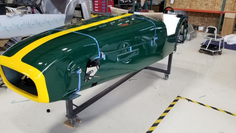

  8. Croc, Thanks for the article! I've been a very long lurker on this forum, in fact I was surprised to see I signed up way back in 2013. It took eight years, but I now have a new Birkin kit being prepped for shipping! You may have seen it in the shop, it's British racing green and this image from Tom was taken just last week. Overall, I can't express enough how much you and others on this forum have helped in making my decision to get a seven. Without the resources found here, I would not have had enough confidence to order a kit. I'm sure there are many others out there like me, silently researching and scouring through as many posts as possible and absorbing all the seven knowledge available. And I'm certain there are many of us with sevens as a direct result of the support found in this forum. Tom Carlin has been absolutely wonderful to deal with, and I heartily agree with many others who have said the same thing in other posts. Many small details have boosted my confidence that I made the right choice. For example, as I received photo updates from Tom, I could see things like - all the screws along the scuttle were 'clocked' in the same direction. Or, some of the standard electrical connectors were swapped out for 'Weather Pack' connectors to prevent future corrosion. Or, the curves of the aluminum bonnet had been massaged into shape to fit the chassis 'just right' when latched closed. Tom seems to take pride in his work, and it shows. I'll be sure to introduce myself on the "So, tell us a little about yourselves" discussion once I start building my kit. My intention is to post some FAQs that I had as a newbie that might help others who come along after me. Thanks again!
