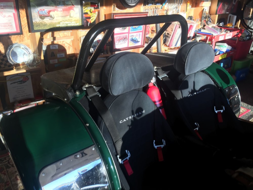

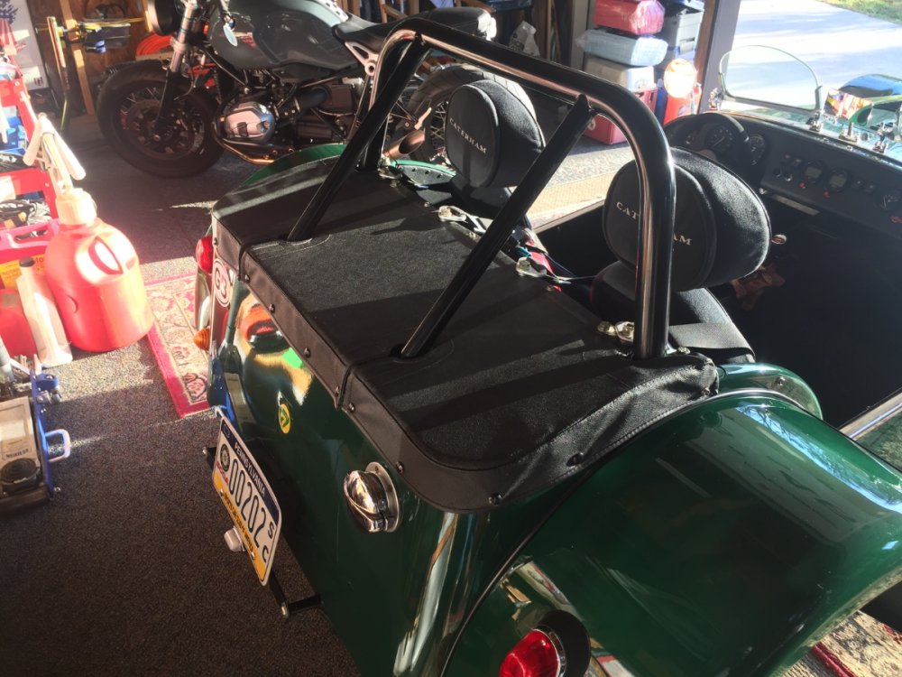

Really nothing to see here. Just the new standard bar which I swapped for the FIA bar with its forward slope and cross brace. The new bar is more upright, has no cross brace, and slants inward following the profile of the windscreen (although I have Brooklands screens). The only issue I had to contend with was fabricating bolts which mount upward into the roll bar bosses above the rear shock. The previous bar did not have these bolts installed, as is often the case, because the clearance is very minimal, Overall, I’ve achieved my goal.
Follow-up: I’ve obtained and installed a standard roll over bar meeting my desired appearance. I’ve also decided to keep my original FIA bar with petty strut in the event someone would want to use the car in competition in the future. Josh Robbins from Rocky Mountain Caterham was more than helpful with the process. I would heartily recommend Josh for anything Caterham related.

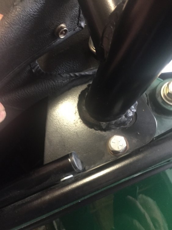

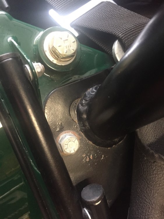

I’m thinking our roll bars may not be compatible. See photos of my upright mounting base; it has a large flat plate on which the bar is welded and this appears to be quite different than yours. I’m learning that there are a myriad of bars and finding one that’s suitable may be very difficult.

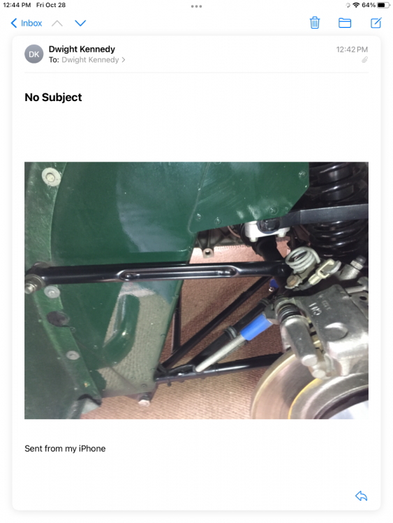

I stand corrected. I was under the impression that all bars with diagonal bracing were FIA. I learn something new every time I get on this site. By the way, concerning my car, it has de Dion rear suspension. I don’t know if it’s metric or imperial. I’ve tried to research that with the suggestion of looking at the horizontal fore/aft member to which the ARB attaches. Mine doesn’t seem to fit the description of being either totally cylindrical or a combination of square and cylinder. Mine is cylindrical, but with indentations as shown on the attached photo. Or am I looking at the wrong member?
