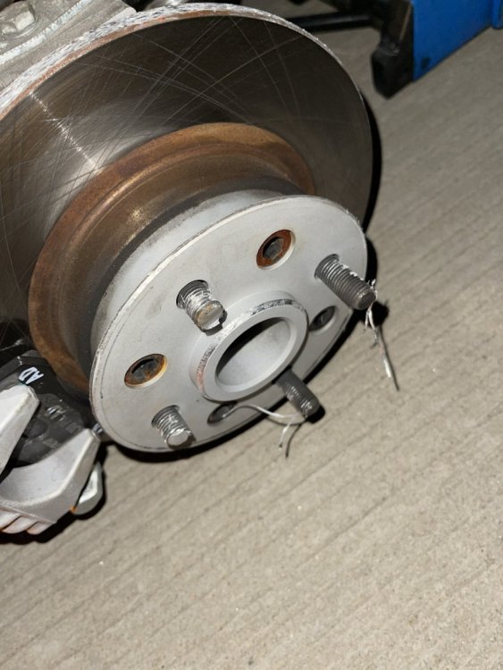

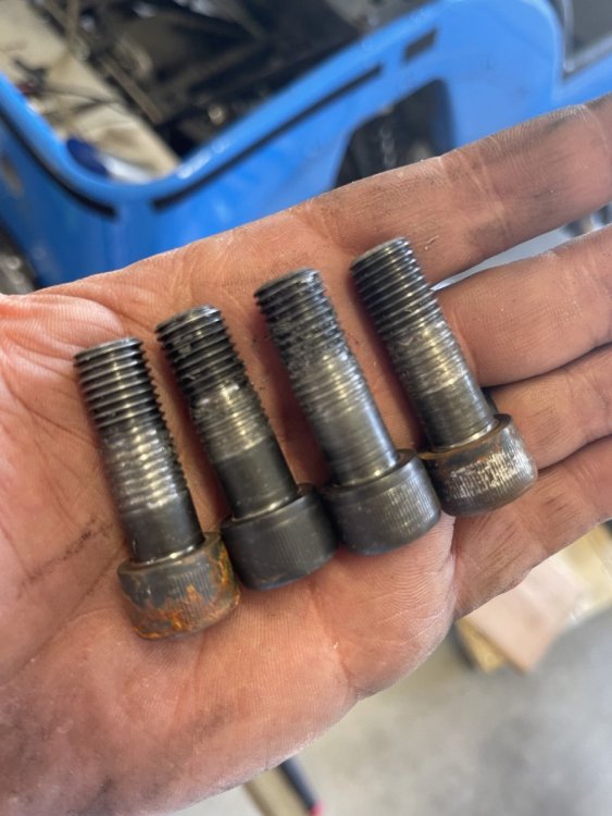

No yeah in order to replace the studs I had to take the adapter off and it was on snug in fact after I get the fender repaired, I may replace the bolts for the adaptor as well, they looked rough to me. So, when I see people running spacers, I sometimes hear people say how unsafe that is and I was wondering do people feel the same about wheel adaptors. I think Fastg was right and that two studs/nuts just failed. I also think it was likely my fault for not doing like my monthly or bi-monthly check. Just wanted to see if others had had any bad experience running wheel adaptors.
Oh, to be clear I 100% blame myself for this. It had been months since I last checked the wheels for Torque. I am convinced either the nuts backed off or the studs/nuts just failed.
Morning everyone, So, I recently had a moment. I was on my way home on the freeway doing about 70ish mph when my rear passenger wheel decided to yeet itself off into the unknown. It all happened so fast I couldn't believe it. Damaged fender, completely gutted wheel studs and a broken taillight. Honestly, I feel like I got off lucky could have been a lot worse. When I showed a friend of mine the photo of the aftermath, as soon as he saw my wheel adaptor he got triggered and basically said that it is the most unsafe thing ever. It is not something I am looking to change but I just wanted to see what everyone's general opinion is I feel like the idea behind the adaptor is both to clear the calipers and get the standard Seven bolt pattern.

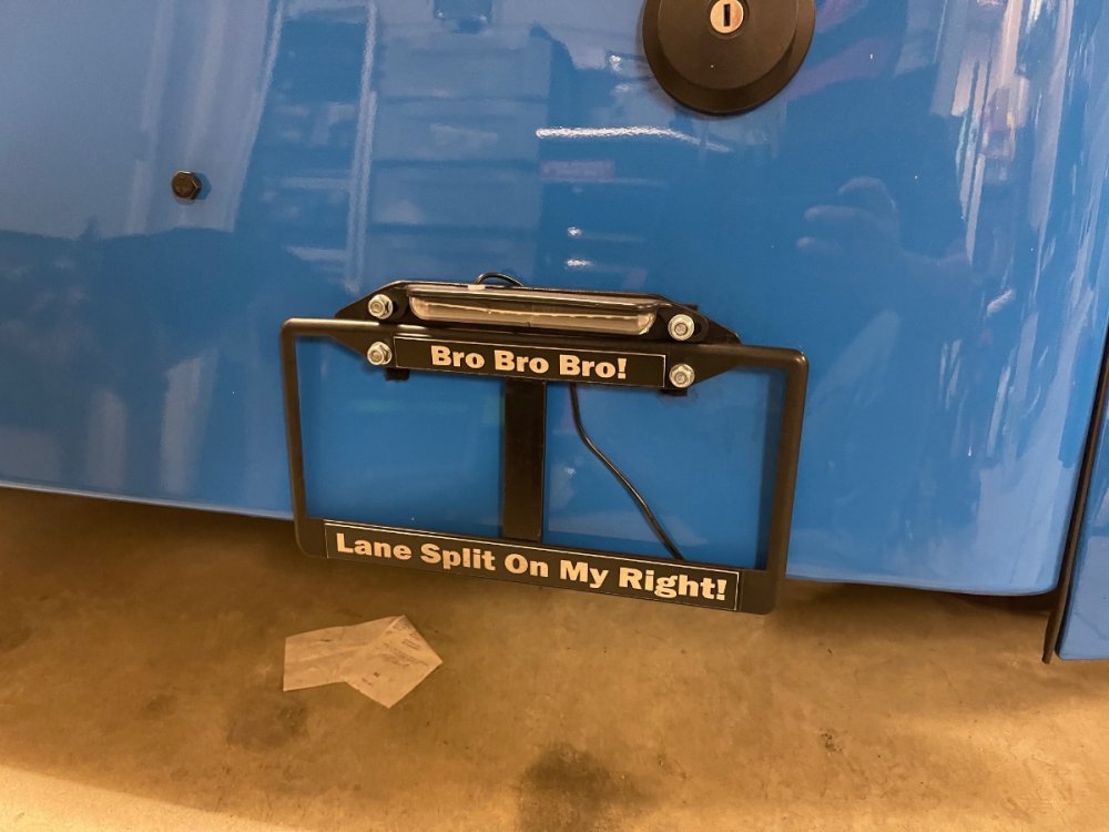

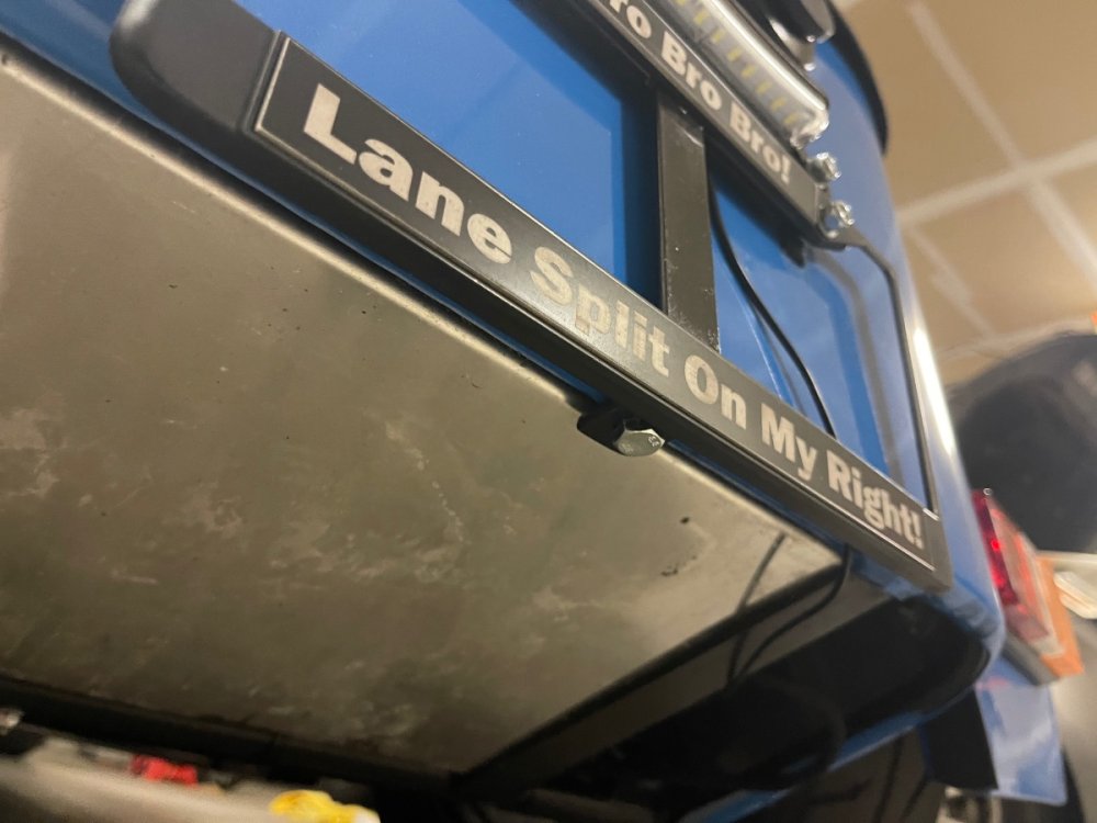

You can use Velcro to keep whatever from hitting the paint buddy (the soft side) that’s what I did lol.
I don't have a photo on me, but I will take one when I get home. Does your car have one of those spots in the back bottom of the chassis where you would mount the spare tire? I had a friend at work fab me of like this T shaped bracket to mount mine and also the plate light I needed to pass brake light. Velcro could definitely work I actually use it on my rear license plate to keep if from touching the car.
