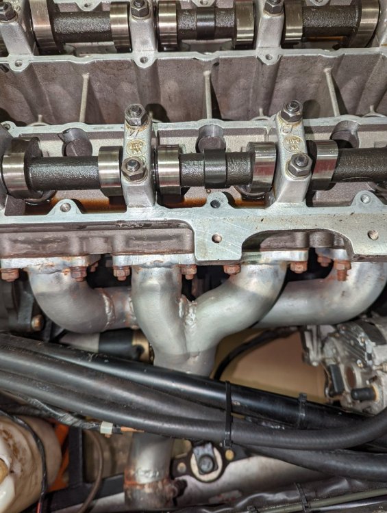

I would like to replace these short tube headers with a longer unit. I am pretty sure it's having a negative affect. The car is stock Caterham LHD long body kit car originally sold to a Dutch builder. the Cosworth takes up a lot of space. The photos aren't great but there's a frame piece, a motor mount strut, an alternator and a starter to work around. Question for the Forum is 'Does anyone know of headers that have been produced for this application?' What is the best way to go? Any options other than custom?

I've never thought of an A/F gauge. Car guys consider my headers to be way too short so that's one factor. My Alfaholic buddy helps tune the Webers but the situation persists. It has a Cosworth engine so it's been suggested it may be harder to smooth out. I live up the coast so some distance from Lotus Club members in the city who could likely assist in this regard. We had a hockey tournament in Montreal years ago and Henri Richard came to our banquet. Marvelous guy; still at game weight. As they say, he won 11-Stanley Cups. If he wanted to wear all his Cup rings, he had to take his clothes off. I'll look into the A/F gauge idea.
JB Collier/McDavid - Oilers fan i suppose - Haven't done much with them at all this winter - car runs with a sporadic pop back thru the carb. Likewise on exhaust; headers are an unusual design....short, on-line owners think they're a problem and I agree. BC Lotus Club member a ferry drive away will be giving his opinion shortly. Could be any number of issues going on....everybody has those stories. Love your team; love the Habs first but you're more entertaining. The few times I've been to Edmonton, I was stunned by the cracked up roads. I imagine you have specific routes for your blats. James.

Scotticus....you may call me Hamish....is there anybody in the states producing headers for these cars? or for the Cosworth? Is a UK product cheaper to acquire? It's not my top priority but it's not helping the tuning process.
I've got a few issues to deal with to get this '87 Super 7 Cosworth 2.0 L working smoothly. The headers have been universally questioned as they are short. The car backfires thru the exhaust. I'm working on timing, then carbs but the headers aren't helping. Is there a supplier in the US, or a preferred fabricator? foto 2.heic
I've seen that article and noted they refer to a 'long, tubular, elongated exhaust manifold.' A few racers have questioned if my set-up is hurting tuning efforts.
