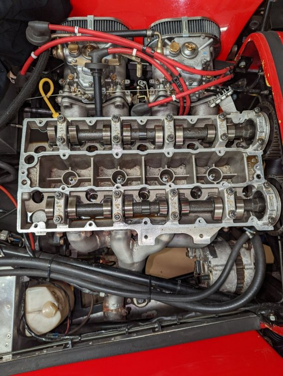

  2. What do these codes indicate on these Cosworth camshafts from a 1988 red top engine (described as a YB) intake, left side is LYD 5, right side is LYD 3. Car is new to me and am trying to get a baseline for it.

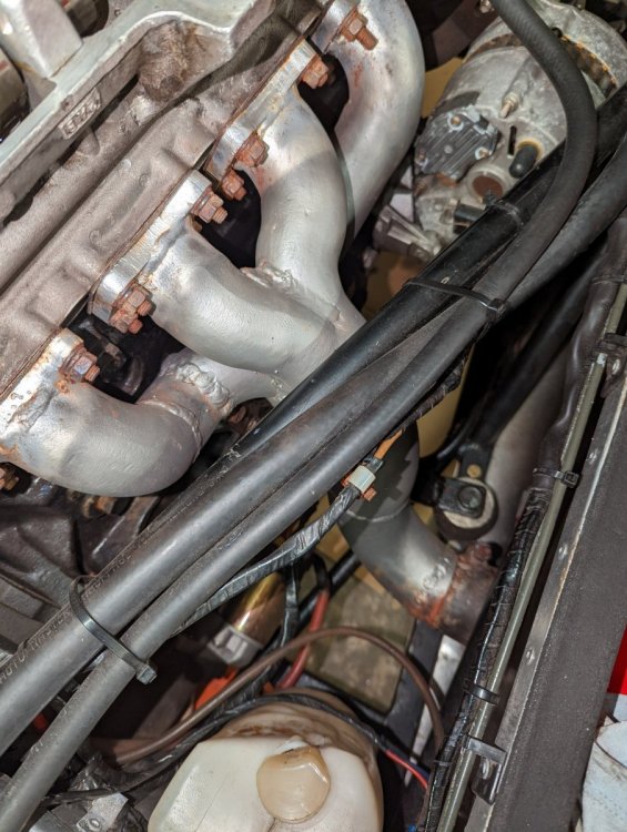

  3. MV8 - I wonder about the exhaust. It looks pretty home-made - just 4 to a big 1. Between those and the Webers, I wear earplugs. I don't know how well this unit matches the engine.

  5. DavidL, My headers are not a particularly attractive set up. I haven't spent any time considering them as a contributing factor but it's possible. I figure banging out the exhaust indicates a rich mixture. The distributor timing is suspect as my dizzy was originally a Bosch vacuum-equipped model. The vacuum has been removed and welded over/blocked off. My thinking is I'm not getting enough advance so I'm looking at a Burtonpower unit or an Accuspark product; the idea being to resolve the timing concern then devote time to the Webers' tuning. I'm interested to hear if anyone has experience with Accuspark vs the Burton Power (FT295K). Accuspark is much less expensive which raises questions.

  7. Trying to smooth out the carbs. Getting some popping at various times but consistently after coming off the throttle. Is there a site that specifies which jets and tubes work best with this engine? Unfortunately I don't know if I have a standard cam. Ideas? James.
