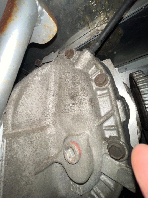

Selling my 2008 WCM Ultralite S2k. I purchased the car in November of 2021, and have only driven the car in my neighborhood, less than 50 miles. Young daughters and our careers have pushed this project down in our family’s priorities. The WCM is a Texas designed kit that took the 2.0 liter 240-hp F20C engine and 6-speed manual transmission from an 2000-2003 Honda AP1 S2000 through a Subaru WRX rear differential to great effect. This particular car has the Honda S2000 engine and transmission mated to a Ford 8.8 Independent Rear Suspension by a previous owner. The car runs and drives but need the rear suspension reworked to allow for proper suspension travel (the ford uprights don’t align 1:1 with the Subaru). Good: - F20c with good compression and fresh Valvoline VR1 5w-30 oil. - Clean bodywork with minimal wear & tear. - New QA1 8243-5 Rear shocks - New Eibach 225lb/in 8” rear springs - New QA1 450lb/in 8” front springs - New Falken Azenis RT660 225/45R17 200-TW tires - CTEK MXS 5.0 Battery Tender - New RaceQuip Sportsman Camlock 5-Point Harnesses (uninstalled) - New SKP SK698271/SK6928270 (Subaru WRX) Rear Knuckle/Uprights (uninstalled) Bad: - Car does not have a muffler. - Rear geometry does not allow for proper suspension travel as is, the axles interfere with the Ford uprights’ mounting points for the suspension. The 5-link rear design is completely adjustable and can be sorted via either adjusting the current suspension or using the provided Subaru Uprights with custom Ford-to-Subaru axles (not purchased). - Headlights and some suspension components showing some surface corrosion. I had planned to replace all the rear suspension arms once the geometry/alignment was sorted. This car requires some sorting but is a great canvass for someone properly inclined, it was last road registered in Georgia. I would like to get my initial purchase price out of it (not inclusive of ~$2,000 of new tires/parts that are included). Happy to provide any additional photos or discussion with anyone interested. Thanks! Reid Duff

What's up everyone! I'm in search of some professional help. My WCM's previous owner utilized a Ford 8.8" rear diff, beefy Ford axles and uprights. Between the mounting points of the ford uprights (compared to the original subaru ones) and the axles, the rear geometry doesn't allow for adequate suspension travel, and has some big bump steer. The previous owner had used 10" rear springs that made for an odd ride height but allowed for some suspension articulation. My plan is to retain the Ford diff, use the original Subaru uprights (which I've bought), and have some Ford-to-Subaru axles made to mate the two. Issue is my young kids and job take almost all my free time & energy. My preferred fabricator/mechanic (has worked on my S2000) doesn't have availability to take on the job. I'm hopefully there may be a race shop or craftsman somewhere between Birmingham and Nashville that might be able to help. Any recommendations are definitely welcomed! -

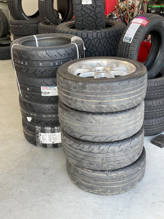

Well, what a month! I'm slowly learning about the car and getting it roadworthy. Replaced the 17 year old Hankook's with a set of "matching" 225/45R17 Falken RT660 200tw tires at all corners. I use quotes on the matching, as 225 seems to have grown about 1" wider since the early 2000's. Massaged the front fenders a little bit and seems to fit fine, but will likely try and find a set of lightweight 17x8 rims since these roll over the 17x7 Enkeis on the car. After an oil change Valvoline VR1 10w30, the first couple neighborhood test drives were a great success, despite the lack of muffler. First time I took it out of the neighborhood the car seemed mildly psychotic above 30mph. I got some toe plates and sure enough it turns out the rear had around 0.25" toe-in and a similar amount on the front. After adjustment to 0" all around it seems like it will be stable enough to get the 5 miles up the road to my alignment shop. I've ordered some 450lb fr 200lb rear springs to throw on and we hopefully will be aligned soon. Just discovered a small leak from the rear differential and to my surprise there is a ford 8.8 rear end with an open differential... Confirmed in fact with wheels spinning in opposite directions when jacked up. Oops. The diff code is hidden on the top of the unit but it appears to be a 434A 3 27 88 out of maybe a Lincoln MK8. And 3.27 gearing, yikes. So I'll be looking at learning all about limited slip diffs and what may be the best path there. Other thoughts: Stones/Pebbles everywhere! Definitely need to take the PPE seriously with these cars and am looking at eye/head/hand protection options. Will see where the next month gets us, cheers. -
