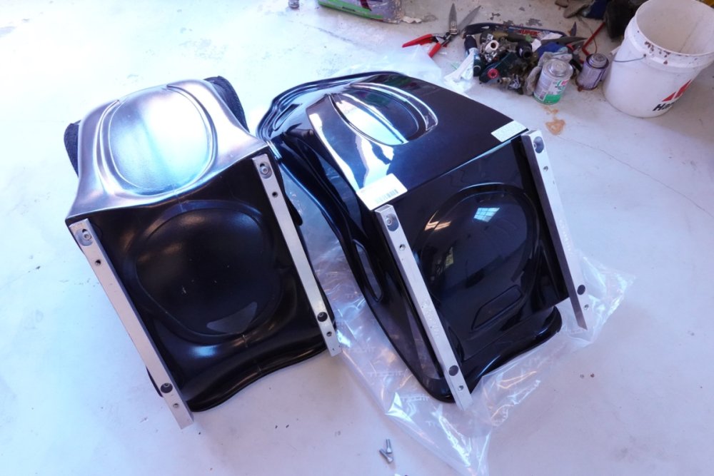

  7. The Catterham Tillets Carbon Fibre Seats I ordered and installed are wider than the Composite Seats by about 1-in overall. Makes the car more usable and comfortable for us big guys. Suprising the Carbon seats are about 2 pounds each heavier than the Composites, in part because of the additional padding. But I got the weight saving back by not using the heavy steel adjustable seat sliders, but just bolting the seats solidly to the floor with the stock aluminum seat mounts.
  8. I have ordered the Caterham exclusive Carbon Fibre Race Seats with padding and less inside contour which my Caterham dealer assures me have about 1in / 2.5mm more inside room than then R model Composite Race Seats. Just what I wanted. Expensive $3500 for the pair with mounts and runners. Here is their photo:

  13. 2022 Update - I ordere and installed the newer, wider Carbon Fiber Tilots (shown right) seats from Caterham ordered through by Caterham dealer, and they are the way to go. About 1/2-inch wider across and an easier fit for my 230 lb 40-inch waist. Snug, but comfortable and perfect for hard cornering. Hi Guys, Just got my new used Caterham with the Caterham Plastic Race Seats and the fit is really tight with pinching on my ribs and butt. It is obvious the seats are molded plastic and were formed with a plastic sheet, heated on a mold. In looking at the clearance between the seat sides and the car interior there is almost 1-in of clearance on each side. So I'm looking to buy a heat gun and open up the sides of the seat back and botton around 0.5in. on each side which should be perferct for me. I'm asking if anyone has tried or heard of doing this? Thank you! Jim Gianatsis
