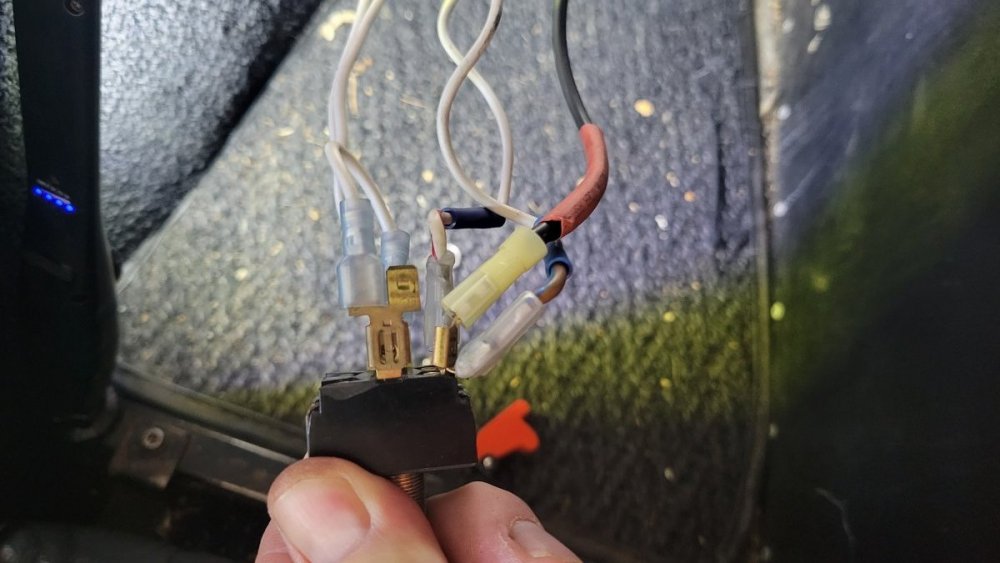

Progress - worked my way back to the original problem! Grounding was fine, but the ignition switch wasn't PO or somebody had hacked-in a screw-terminal off-on-start toggle switch, and attached the wires with some really dodgy connectors. One of the wires had fallen off. I knew the original starter switch was bad, and had sourced a replacement from a nice chap in the UK. I cleaned-up the wiring, put new ends on, and re-installed the replacement switch and all now works as it should - except the indicators and flashers still don't flash. I ordered a new hazard switch from Caterham as the tests on my old one show it has problems, but I'm now convinced that the flasher is actually bad. I took the cover off the flasher, and it picks-up the relay and closes the contacts when the indicator switch is turned-on, but the relay doesn't release to make them flash. I'm fairly convinced it is indeed a JIS flasher - so anyone have a link to where I can get one without going back to the UK again? Here's a pic of the previous switch wiring... -

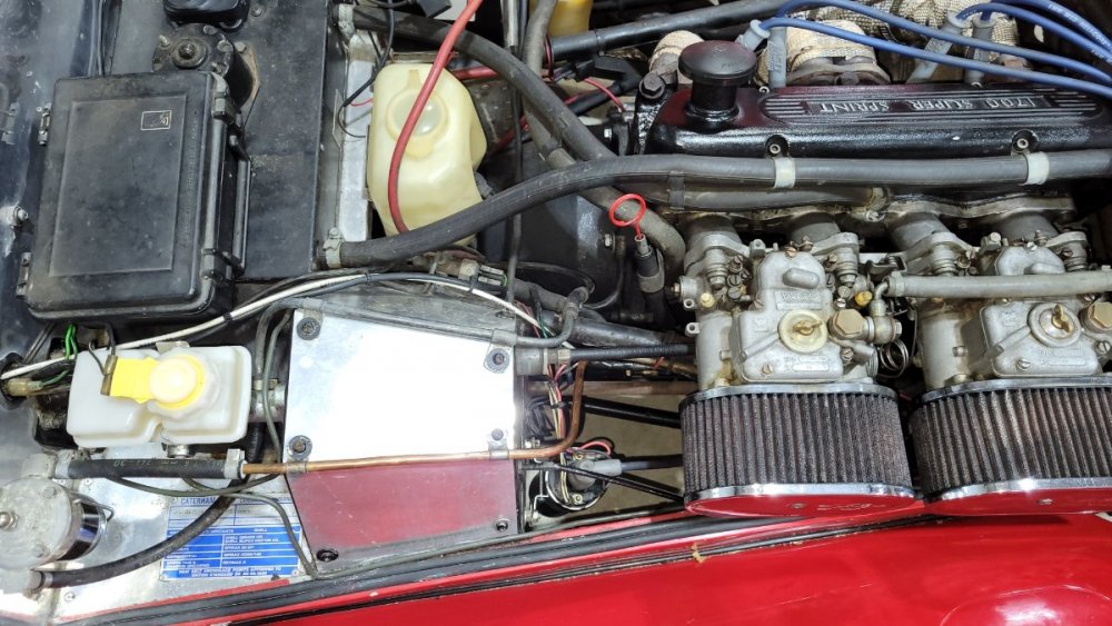

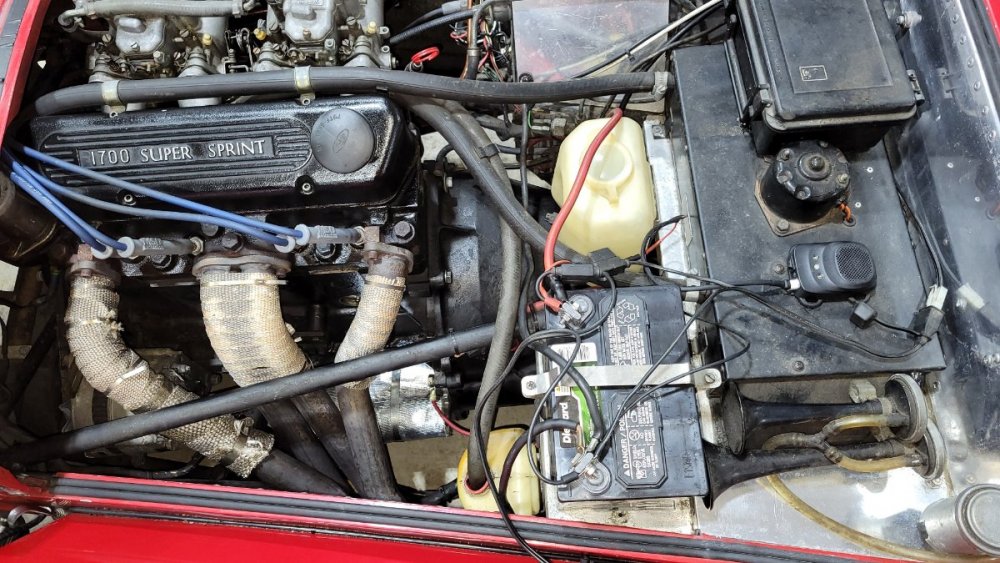

Thanks! Had no idea there were ISO and JSO flasher configs - perhaps that caused me to blow a fuse, but all the ones in the fuse box at least looked just fie - I pulled and inspected each one - especially the one for the indicators. More investigation in a few days when I can get back on it. I also suspect a bad ground somewhere... Here are some engine pics.
