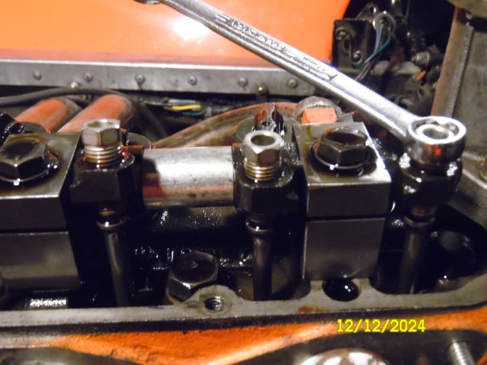

  9. Thanks, MV8, I noticed them, but wasn't aware they were also a valve train mod. Someone in the past put some thought into it. This morning I had time to adjust the valves with #1 at TDC: 1 I & E 2 E 3 I I'll rotate to #4 TDC and get the others in a bit. None of the first group are off more than 0.001, but this is much easier than the old "lock nut and screwdriver" method. Steve Rineer Lititz, PA
  10. Hello all, I'm a relatively new owner of a 1985 Caterham Super Sprint and have a question about valve adjustment. I'm not new to adjusting valves, just new to what I'm seeing. Engines in my experience have a jam nut which is loosened, then one adjusts the valve with a screwdriver, then tightens the jam nut. Naturally, some trial and error is always needed since the jam nut changes the clearance slightly. What I'm seeing, however, appears to be similar to a tube nut which bears on the pushrod, but with no lock nut. Is this correct? After adjusting clearance with nut part of the tube nut, what maintains the clearance? Picture attached. Thanks in advance. Steve
