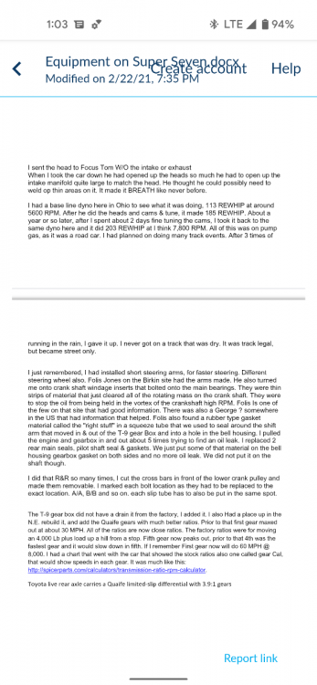

I attached what info was given to me by previous seller. It has a full belly pan so I can't spin the wheel and count drive shaft rotation. I'll see what I can do.
225/45/15 I believe.
Thanks a bunch I will check them out!
Good morning all. I have finally got most of the kinks worked out on my birkin s3 and have done a couple autox events. My current setup is a zetec with a t-9 that has a tall first and close ratios after that. I hit 59/60 at 8k rpm in first and close to 80 in second. For autox I'd like to be in the 48/50 range for first and 66/68 range in second. My current rear gear is a 3.90/1. I do occasionally street drive the car and in 5th @ 80 I'm turning 4k rpm so going with a higher ratio gear isn't ideal but that all depends on how hard it is to find gears and parts to change on the t-9. any info or suggestions are greatly appreciated. The previous owner sent the trans somewhere in New England to be built years ago, but he doesn't remember where. I am currently in Texas. Cheers John

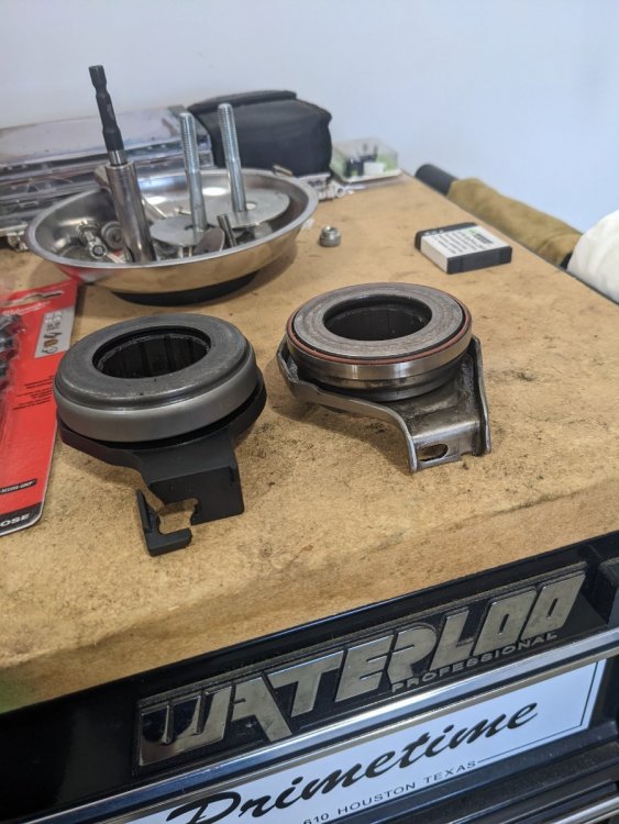

And I don't! Been having one hell of a time figuring what parts are in there. Closest I can get is a UK escort release bearing. -
Duratec annular bearing on a zetec/t-9
RedbeardRacing replied to RedbeardRacing's topic in General Tech

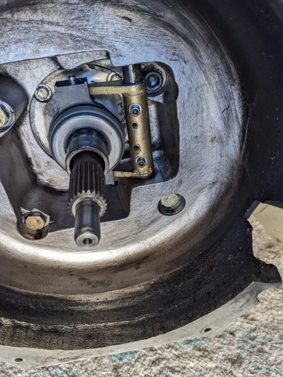

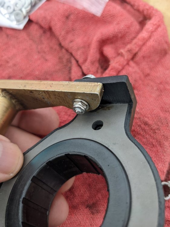

I currently have an external slave, the bearing that came with the car failed, and I can't find the exact replacement. And the bearing from Birkin doesn't allow proper geometry with my current setup, and frankly I'm tired of all those moving pieces when I can have it all as one unit. Then I can do away with all that linkage. -
Anybody done the annular bearing setup on a zetec bellhousing? Just trying to plan ahead. -
Good afternoon everyone, I spoke with Tom at birkin USA and he has a kit to adapt the newer duratec annular release bearing to the t-9 attached to my zetec. It looks like it should clear the boss in the bell housing for my current external slave and linkage. Just wanted to see if anyone has done this upgrade and what they found out on the way!! TIA

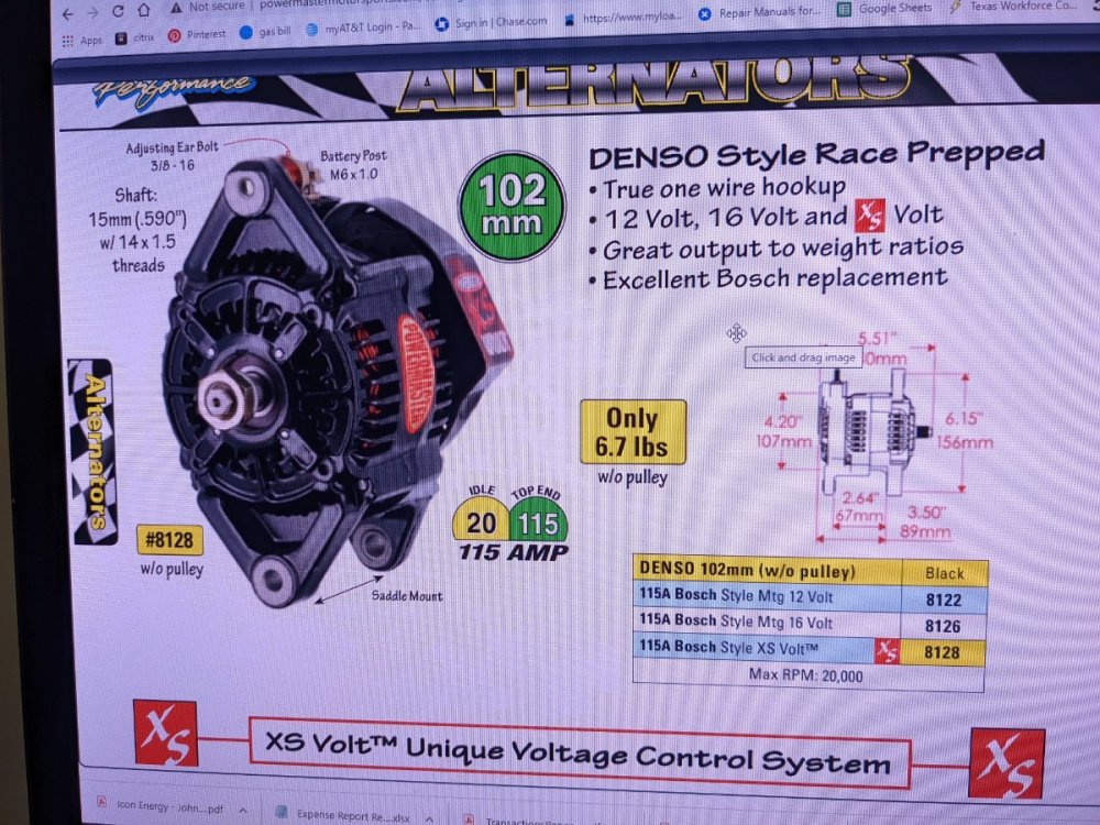

That's a nice price for that much fun. So via Graham, I've looked through the power master options. The ones on page 42 are smaller in body than what I currently have the 8122 model on page 44 is the exact dimensions of my current part. This one is 20 amp idle and 115 amp top end. It is quite pricey, around $360, but looks to solve all issues.

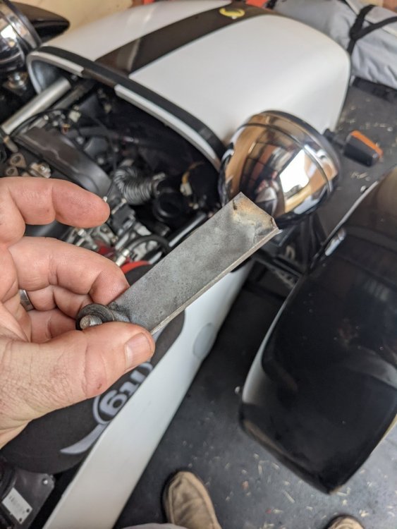

I bet it's peppy with k series in there, and even more cramped than mine. Found a broken top alternator bracket. That could have been side loading it, at bare minimum vibrating and sorts. Gonna throw a new one on it with a fixed bracket and see what happens. Does your amp meter show 0 when running? Shouldn't it be +12/14 if the alternator is working?
