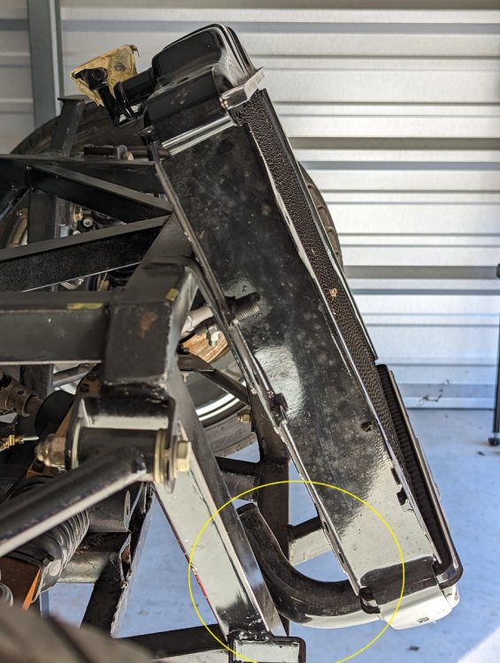

  12. I took some measurements yesterday. I measured in the yellow plane thinking that a slight angle would give the largest height. allowing for some clearance (about 1/2 to 1") on all sides 16" high 20" wide. My plan is to go get some rigid foam board insulation sheathing and cut a 16x20x? block to test fit. After studying the inside shape of the hood, I doubt that knocking off the corners is really going to allow any gains in size. Again hoping test fit of foam board will tell. Looking at fans, there are a lot of 16" ones. I've feelin that radiator needs to be at least 16" tall. Reading about fans, the round fans do not take advantage of the full area of the radiator. I would really like to build sheet metal duct and mount the fan behind the radiator. This may be a real challenge with the tube frame basically in the same space... but I think something like this would work. I also find this radiator interesting in that it is a double pass and inlet and outlet are on the same side. My engine was originally transvers mounted, so both water pump inlet and outlet at back of the block are on the driver's side.

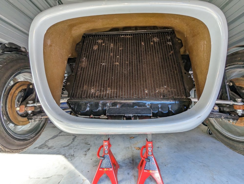

  17. My first Post! The car is an unfinished 2005 Brunton Stalker. 3800 SC engine. I’m not fond of the radiator that is on my car. In replacing, I hope to be able to shorten/improve hoses routing and clean up the appearance maybe flow air better. I know at one point Stalker Cars had a custom one designed and built, but through google searches, the company who built the radiator does not seem to be in business. This is a radiator from a 80’a Hyundai Excel. Looking from the front the lower tank is very visible. Not very attractive. I think by using a side tank radiator, I can clean this up and open options for inlet and outlet locations. The radiator sits at about a 25 degree angle. It seems this this was due to clearance on the lower outlet. Guessing I can easily get it to 15 degree. Maybe 10… Not sure if I can, but I would like to bring the radiator top forward enough to allow for a rear mounted fan. I might even be able to mount the radiator perpendicular… I’ve been trying to figure out how to measure and consider different radiator sizes. I’ve only come up with cutting blocks of Styrofoam and test fitting… do you have any suggestions? I would like to stay away from a fully custom radiator. Looking online at Summit and Jegs for standard sizes. Where else should I look? Any manufacturer recommendations? Looking for any input/suggestions/considerations TIA -- Stan
