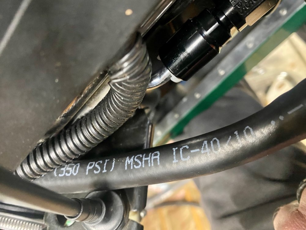

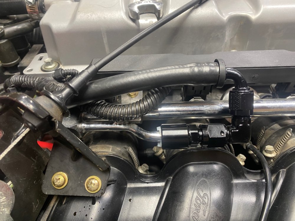

Interesting. Wonder why they state only 50PSI for the Jegs hose? This hose I assume is Fragola along with the fittings.
Yes. Not quite sure of the push loc fittings on there. The hose is rated to 350psi. I’d imagine the small fuel pump that is on the car will not exceed 40psi spike.

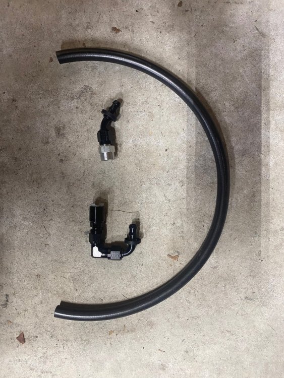

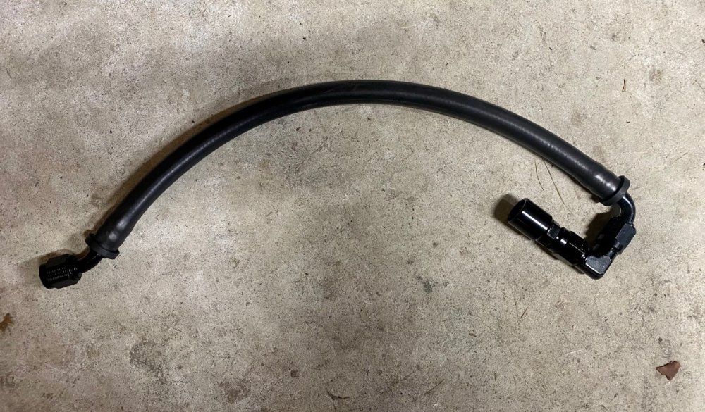

MV8 thanks for offering to help repair the fuel line. The speed shop supplied me with all but one fitting that I was an to order online myself. Here is the final product after put together.

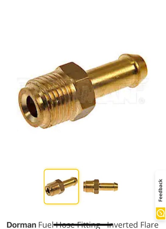

The speed shop yesterday had me order this and he said once it arrives he will be able to fabricate a hose for me. Rocky Mountain informed me last night that the SVT cars fuel hose was made from a Rover fuel line and they would cut one end off and attach the fuel rail push on connector.
I’m going to try and get photos today.
I’m sorry yes you are correct it runs to regular fuel hose. I was thinking about the breather tube that ran to the charcoal canister.

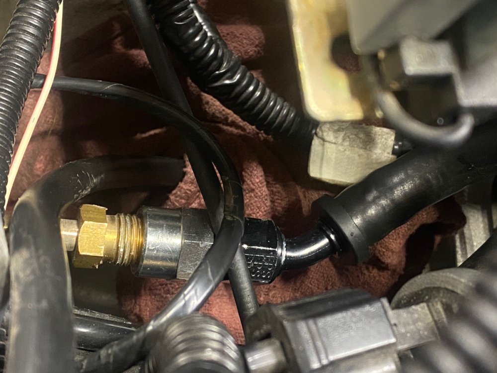

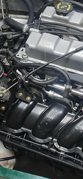

Here is the only photo I have currently of it installed. I’ll get a photo of the opposite end tonight when I get home from work. Thanks for offering to repair the hose. I might take you up on that. I’m going to try one more place locally today and Rocky Mountain said they may have something there. the brass end connector connects to a inverted flare fitting that has a couple of inches then nylon fuel hose from there back to the fuel filter. The 90 degree fitting is the ford push on rail connection. Thanks
Apparently Caterham did not support a Zetec conversion package is what I have been told. I’ve tried three different hydraulic hose builders in my area and they don’t carry the fittings unfortunately. Beachman said they have a Duratec line, but I may still need to modify that to get it to work.
Looking for a fuel hose that goes to the fuel rail on a SVT or a good source for someone to make one.
