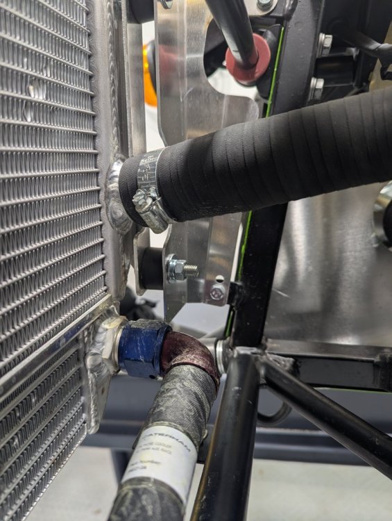

  4. Finally up on the lift, found my coolant leak, not sure which connection it's coming from - but went ahead and tightened all 3 clamps in the line where I see yellow crust. Still at the "min" mark on the tank, so just something to keep an eye on for now
