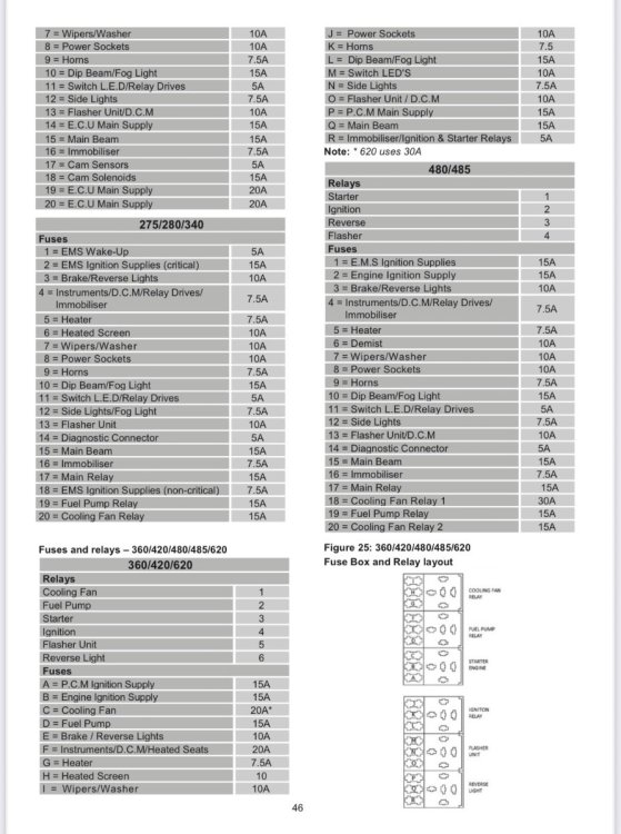

  2. Thank you for both of your responses! Our dealer, Bruce Beachman, helped us locate the correct fuse which wound up being the 10 amp fuse M (Switch LED’s) for my issue. 👍
  3. Hello, Where would one find the fuse for the turn signals on a Caterham 420? The manual is not too much help unless the Brits call them something else. Thank you!
