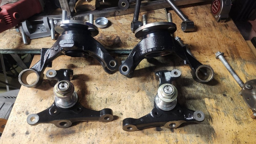

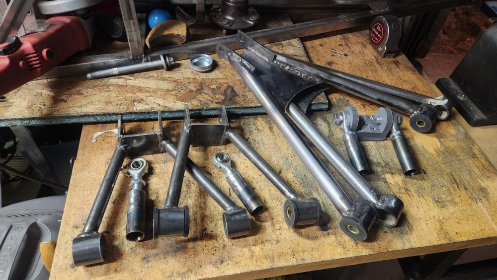

Been a minute since the last update. I did get bogged down with the vegetable garden, and my son's spring baseball season. But, I did still make some progress. I have 4/8 control arms, and Miata spindles/uprights cleaned, painted, and rebuilt. I still have to build the rear lower control arms, and then I can start mounting rear suspension. Shoutout to Matthew Kohl for the STL files to 3d print the jig to mock up the heim joints for the rear lower control arm. I have a self imposed deadline of September 1st to have this thing on it's wheels. I also scored a set(7 wheels actually) of stock NB Miata 15x6 5-spokes for $110. They need new tires, but they hold air, and I will just get new tires before it's finished. Don't want good tires aging while the car is being built. Did you know Enkei made the NB 5-spokes? They're pretty light too, only 13lbs per bare wheel.

I'm using the 9.9107 bushing. The shell is 1.5x0.125, I think. 1/2" bolt.
I will be using Energy Suspension bushings. I do need to place that order though.

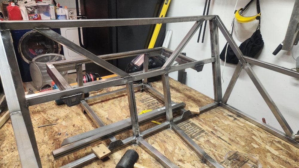

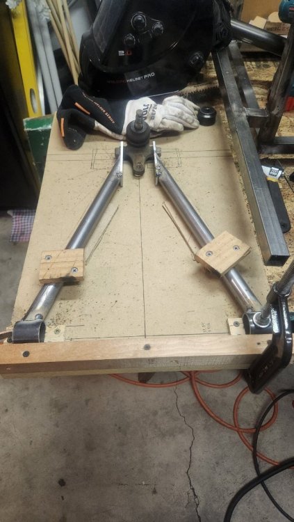

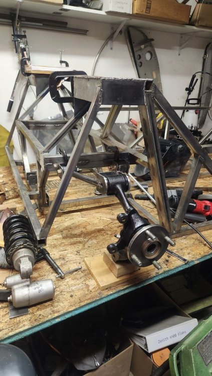

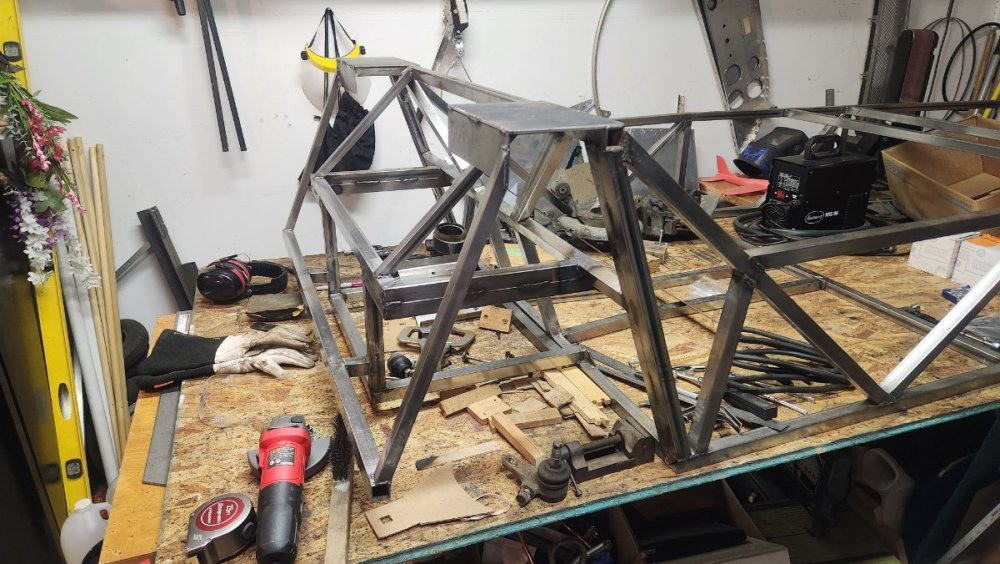

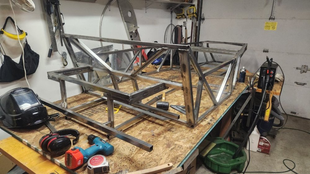

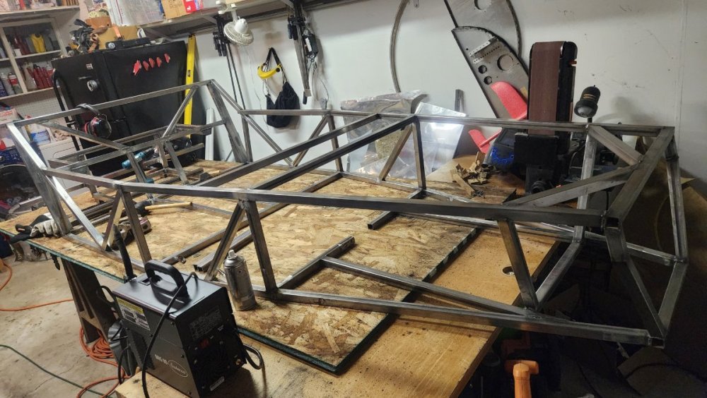

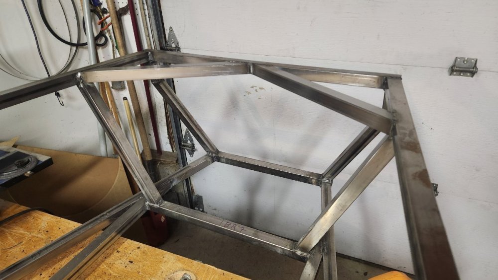

Ok, time for an update. Progress has been slow. Shortly after my initial post, I acquired a $200 2006 Mercedes S-Class project. Really nice car, had some shifter/transmission issues. This car consumed a lot more of my time than I wanted. Then, on January 15th, that car was rear-ended and totaled while driving to buy suspension parts for the Locost build. I got the insurance payout for that today. Anyway. I bought a new welder, a Primeweld with TIG capability(TIG not yet used). I finalized the front/rear suspension geometry, built 1 front lower control arm(partially built in photo), and am almost done with the rear section of the frame, just need the rear "hoops". I have set September 1st as the deadline to have a rolling chassis. I hope to beat that time.

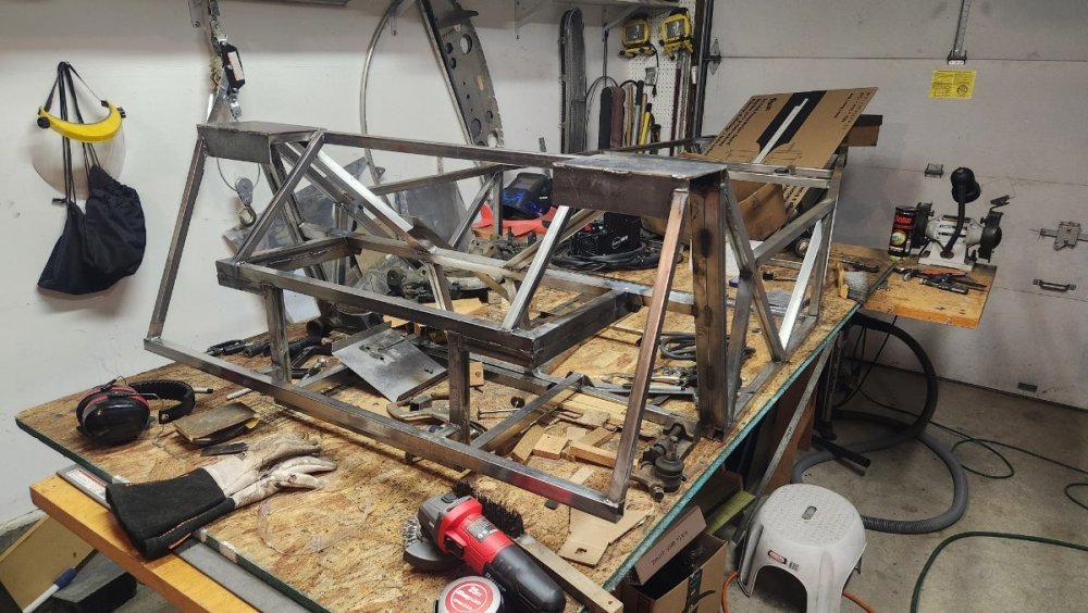

I've wanted to build a Lotus 7 type car for several decades now. I'm pushing 40, and no better time than now to start. I started with a McSorley 442E, Figuring that the bigger it is, the more likely that my "larger" friends could fit. After I built the basic frame, I started looking into the suspension design, which was giving me anxiety, since I wanted to use NA/NB Miata diff, axles, uprights, etc. I was told that the 442 was too wide to use stock axles. I didn't want to go down the rabbit hole of custom length axles, designing my own control arms, mounting points and geometry. I have a full time job, a 10 year old son, and a baby girl, I don't have time for all that. So, I cut it all up, and used the pieces to build a Haynes Roadster, using the Saturn Sports Car plans to adapt to MX5 running gear. This way, most of the work was done for me. Planning on using a Ford Duratec 2.3, NC Miata 5-speed, NB Miata rear diff, axles, uprights, brakes, steering column, and other small bits. Oh, and don't worry, the irony isn't lost on me, that the time spent cutting up one frame, and building another probably took longer than just sticking with the first frame. Anyway, I'm almost ready to start fabbing up some control arms.
