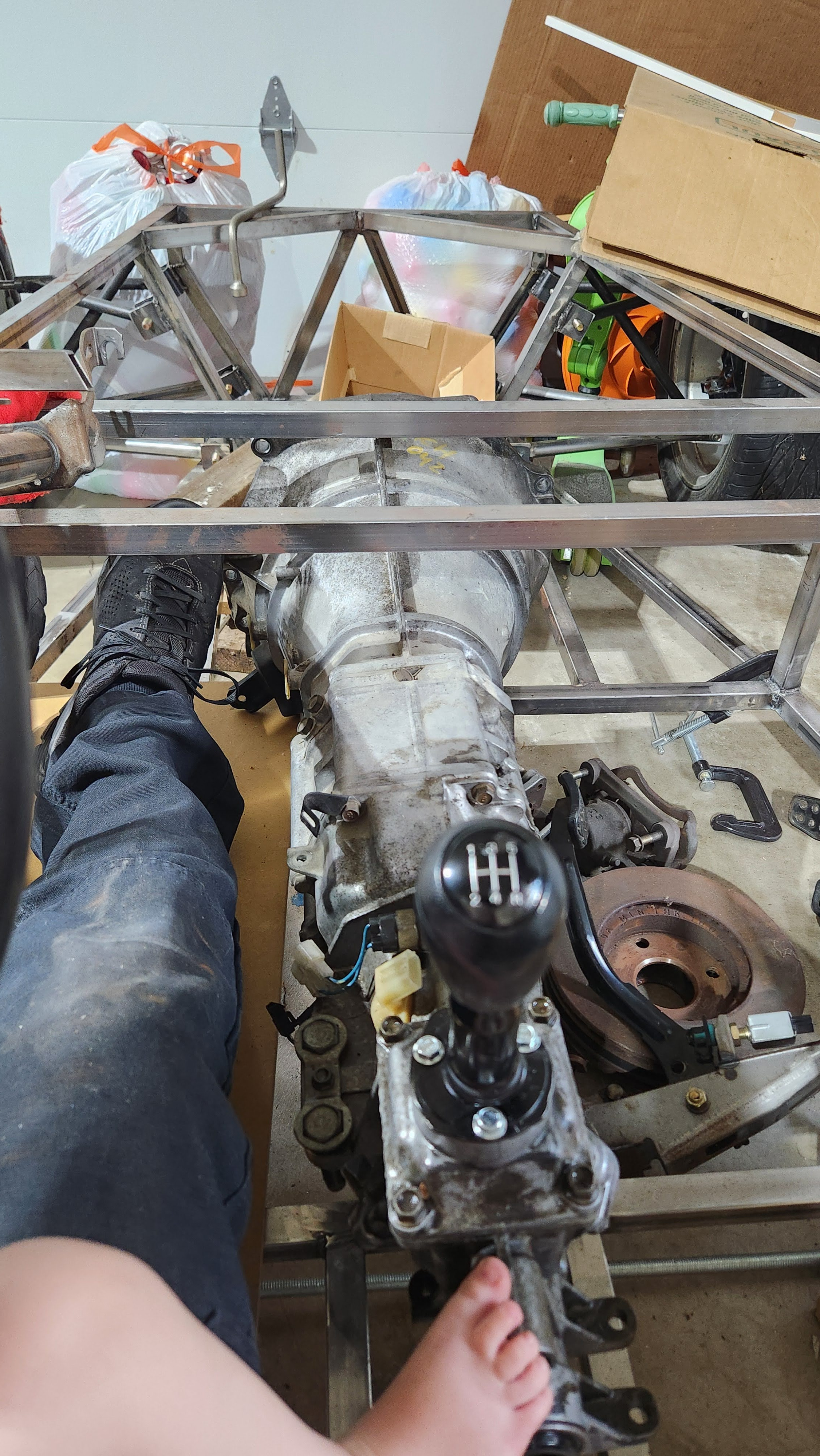

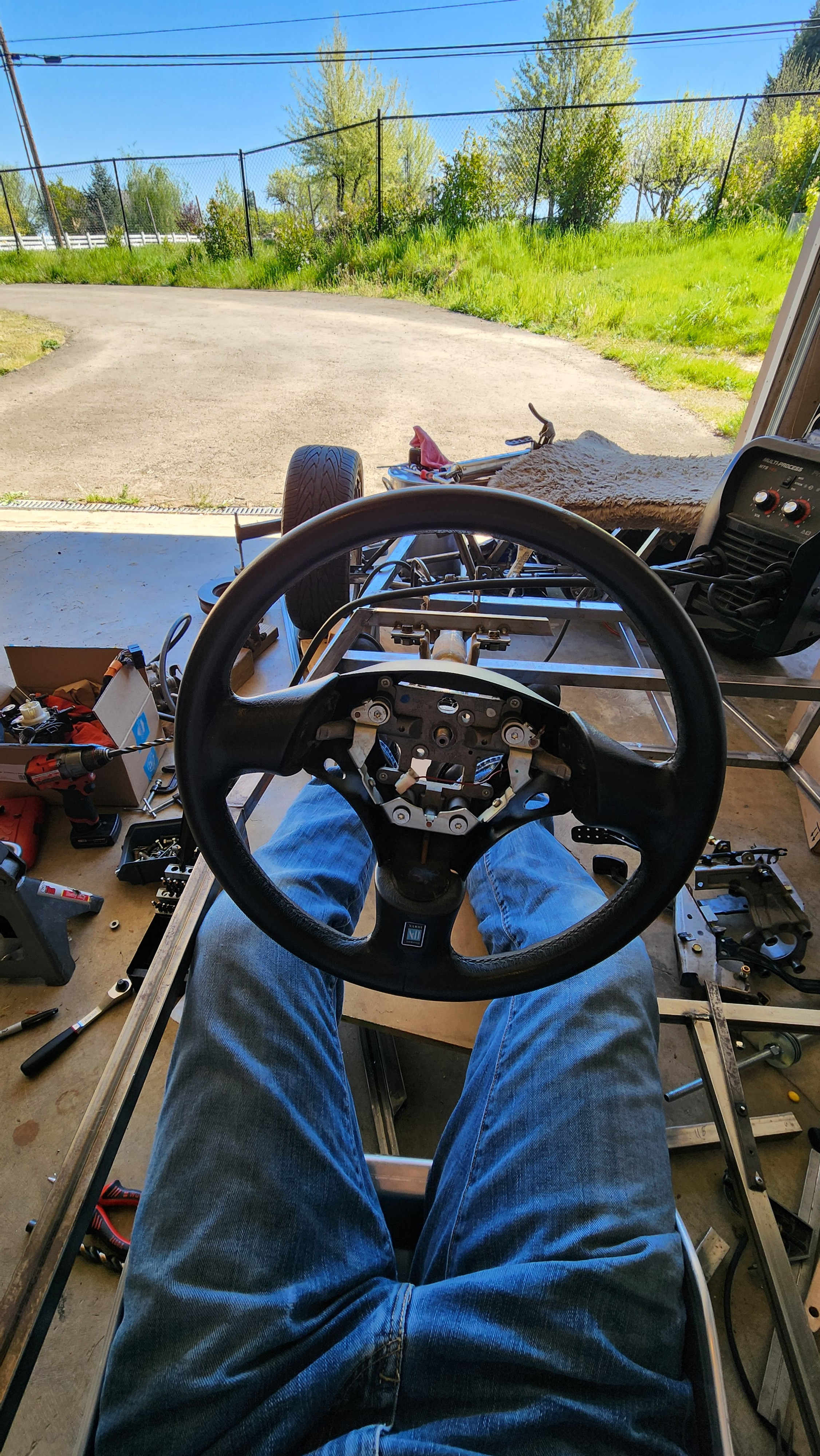

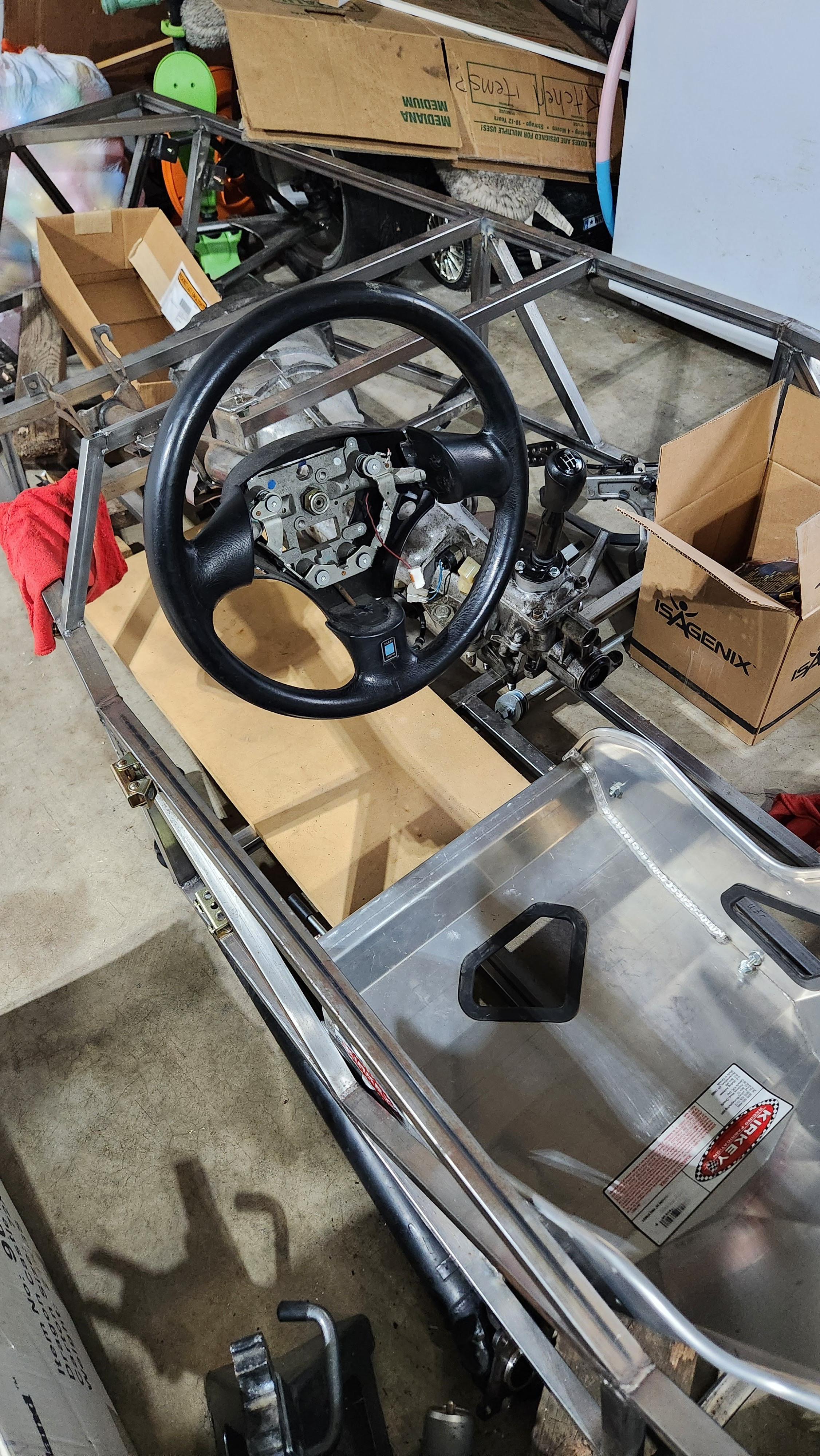

  1. Well, I suppose I owe you guys an update after almost a year. Shortly after my last post, my family moved into another house(long-term housesitting, long story)with a small garage. I didn't have room for my tools, and the project, and my vintage BMW in the same garage. Earlier this year I got back to work and made some progress. Installed 4 15" NB Miata 5-spoke Enkei wheels, Kirkey drivers seat on sliders, started mounting the steering column, and this past Tuesday, picked up an NC Miata 5-speed w/ clutch, flywheel, driveshaft and shifter($500). Once I get the engine(Ford Duratec 2.5), I can really make some progress with trans tunnel, pedal box, and and engine/trans mounts. My son is 12, and he's getting excited to help. According to my spreadsheet, I'm $2,071 into it so far. Not bad. I unfortunately didn't take many photos of the progress, though I can take some better photos tonight.

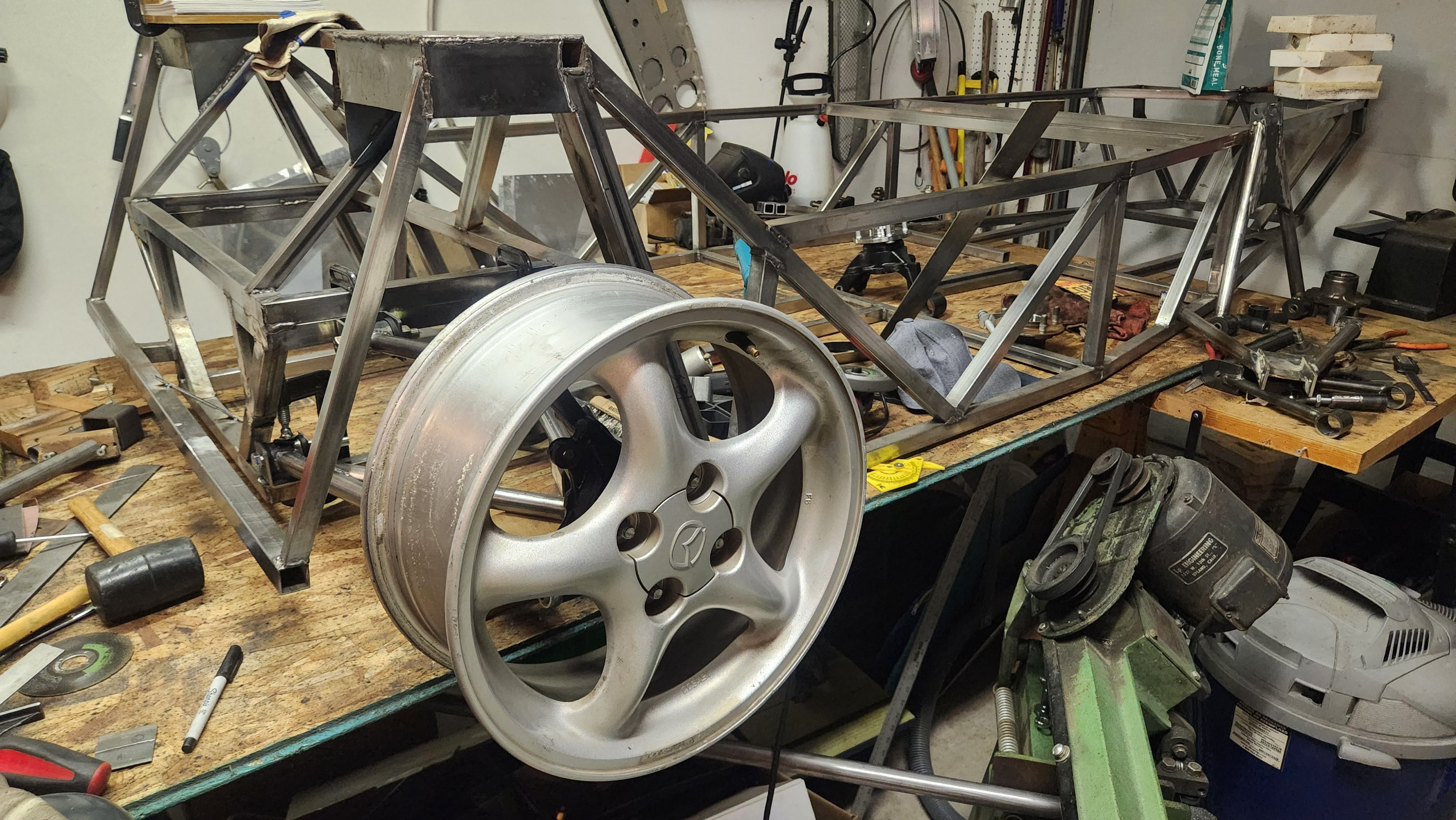

  3. Been a minute since the last update. I did get bogged down with the vegetable garden, and my son's spring baseball season. But, I did still make some progress. I have 4/8 control arms, and Miata spindles/uprights cleaned, painted, and rebuilt. I still have to build the rear lower control arms, and then I can start mounting rear suspension. Shoutout to Matthew Kohl for the STL files to 3d print the jig to mock up the heim joints for the rear lower control arm. I have a self imposed deadline of September 1st to have this thing on it's wheels. I also scored a set(7 wheels actually) of stock NB Miata 15x6 5-spokes for $110. They need new tires, but they hold air, and I will just get new tires before it's finished. Don't want good tires aging while the car is being built. Did you know Enkei made the NB 5-spokes? They're pretty light too, only 13lbs per bare wheel.

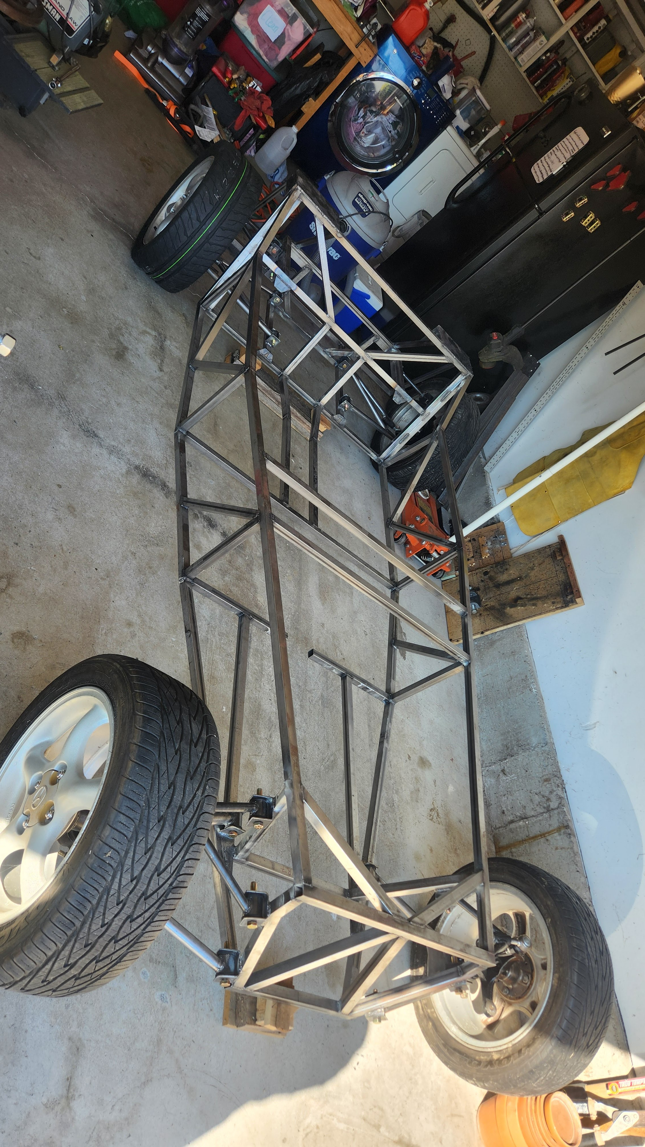

  7. Ok, time for an update. Progress has been slow. Shortly after my initial post, I acquired a $200 2006 Mercedes S-Class project. Really nice car, had some shifter/transmission issues. This car consumed a lot more of my time than I wanted. Then, on January 15th, that car was rear-ended and totaled while driving to buy suspension parts for the Locost build. I got the insurance payout for that today. Anyway. I bought a new welder, a Primeweld with TIG capability(TIG not yet used). I finalized the front/rear suspension geometry, built 1 front lower control arm(partially built in photo), and am almost done with the rear section of the frame, just need the rear "hoops". I have set September 1st as the deadline to have a rolling chassis. I hope to beat that time.
