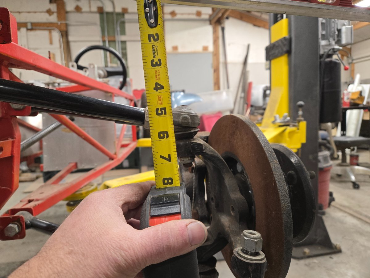

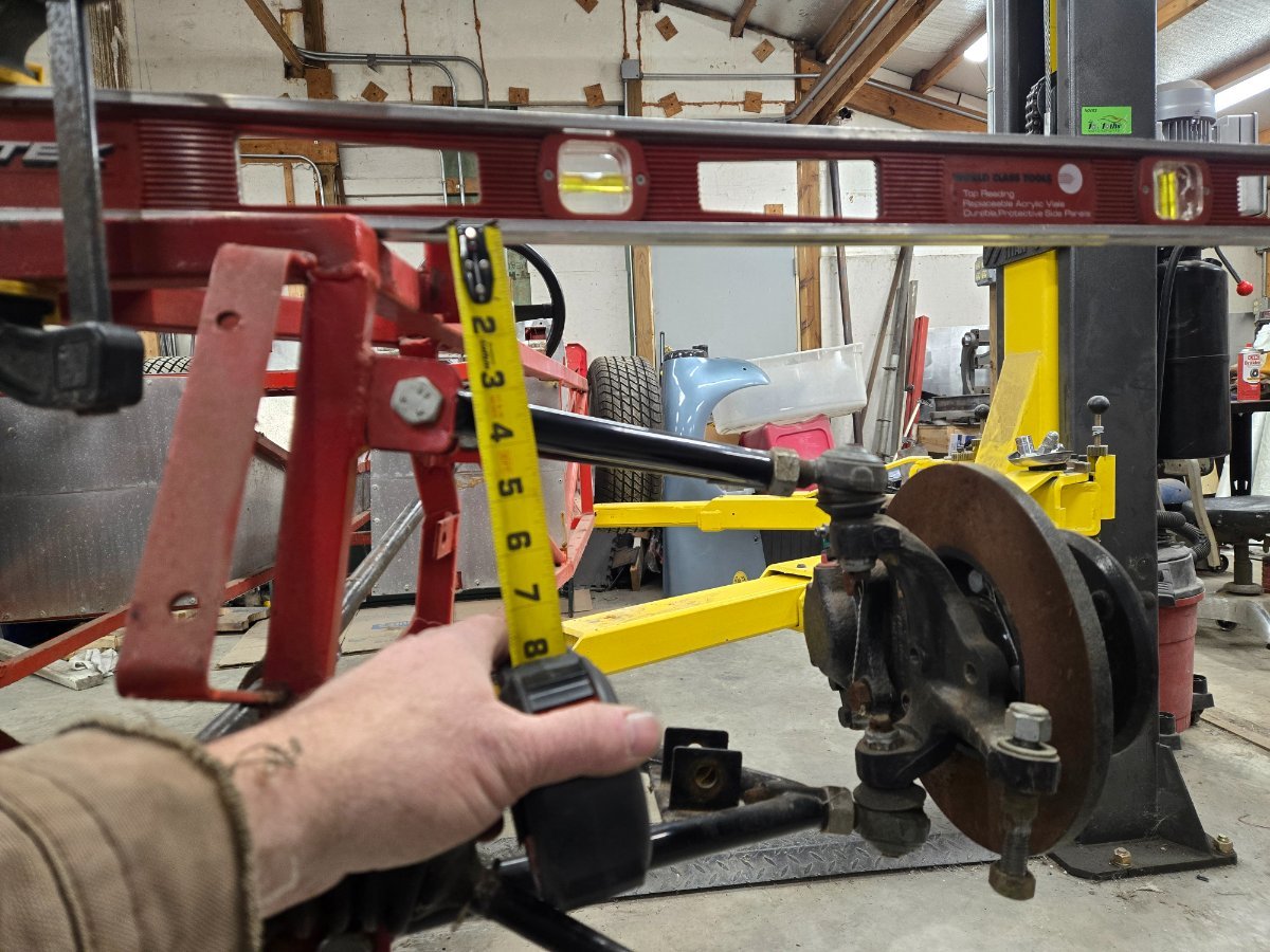

What is appropriate droop for front of RM7?
Healeyracer replied to Healeyracer's topic in General Sevens Discussion
MV8, The kit dates from the mid 1990's, so i would assume the parts used would have been from before that. It appears to have been purchased as a mostly complete kit, but aside from a hand written notebook and a bunch of emails, I don't have much original info. Thanks Mike -
Hi, another newby question, this car came to me with the original owner having spent a massive amount of time working on bump steer, and I was not sure if he did anything else to the front end. The person that did that work was 2 or 3 owners ago, and I believe passed away, so not available for inquiries. It also did not have any coil overs fitted. I pulled the front left off, confirmed all joints free, and re assembled, and was surprised at what seemed to be fairly limited droop. The ball joints go into a bind at the bottom of droop. Once I put a straight edge across, it appears droop is about 1.5 inches, just checking to make sure that is sufficient. No issues with upward movement.
