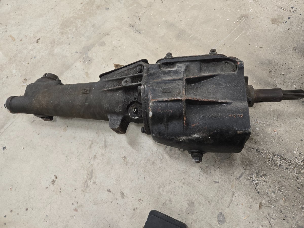

I have a Lotus twincam motor, I know same block as the cross flow, and what I believe is a Lotus Elan transmission (but that is a guess).  It has Ford markings and the following numbers 282IE - 7006D.  I bought an early pinto bell housing that looked like it may fit, but it doesn't fit the transmission. Anyone have any direction or guidance to find the proper bell housing?
Have you verified that all the bellhousing bolts align on the block? Looks to be a "bullet" 2000E 4 speed. Post a pic of the front and back of the bellhousing and the short block. Could be an odd-ball kent/EAO application bell for a euro external rail shifter transmission like the Reliant Scimitar with a Type 5. Most all domestics in the early 70s were external rail (all linkages on one side) with the euros having internal rail or very compact external rails for clearance in smaller vehicles. One possibility is the bell is for a pinto lima. Some limas had both patterns back then and some bells may have been made with both as well. If you have a bell that accepts lima application transmissions and fits the block, that would be a huge plus.

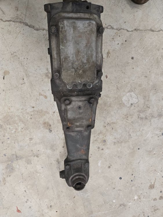

Given the shifter turret in the back of the tail housing, this gearbox is not from an Elan.  Post pictures of the various cast numbers on both the box and tails housing and we may be able to help identify it.

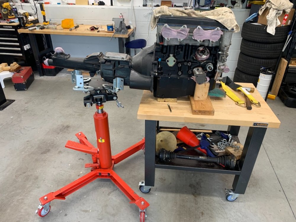

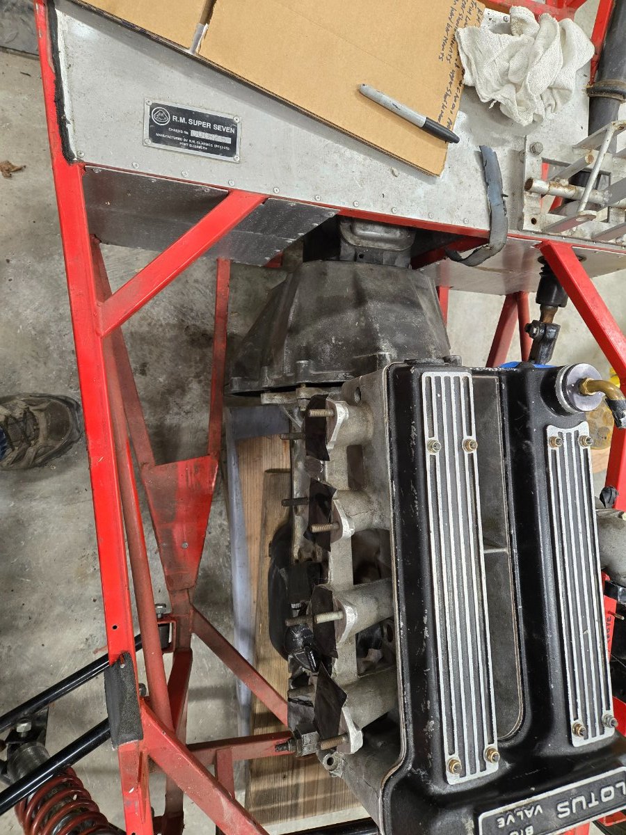

That looks like the gearbox in my 7. Here is a picture of the gearbox, bell housing, and twincam engine. Sorry I don't have casting numbers for you. The car is laid up for the winter and getting dimensions etc. would be tough as well. But if they'd be helpful I can give it a go.
As far as the gearbox is concerned, it's definitely a Ford unit of some kind, very closely related to the Elan gearbox. I used an Elan gasket set and seals when I resealed mine. The innards are just like the other 3 rail gearboxes as well. It's the tailshaft that differentiates it from, say, an Elan gearbox.
It's a type 3 / 2000e

Another clue to what the gearbox came from would be the gear ratios, which you probably want to know anyway before deciding whether to use it.  Easiest way is probably to count the teeth on each gear.  Also, both the gearbox casing and tailhousing should have stamped date codes (though internals could have certainly been rebuilt to other than original specs).
There were multiple variants in the 2821 series, so get a good idea of what you actually have before ordering any bits if you are planning a rebuild.

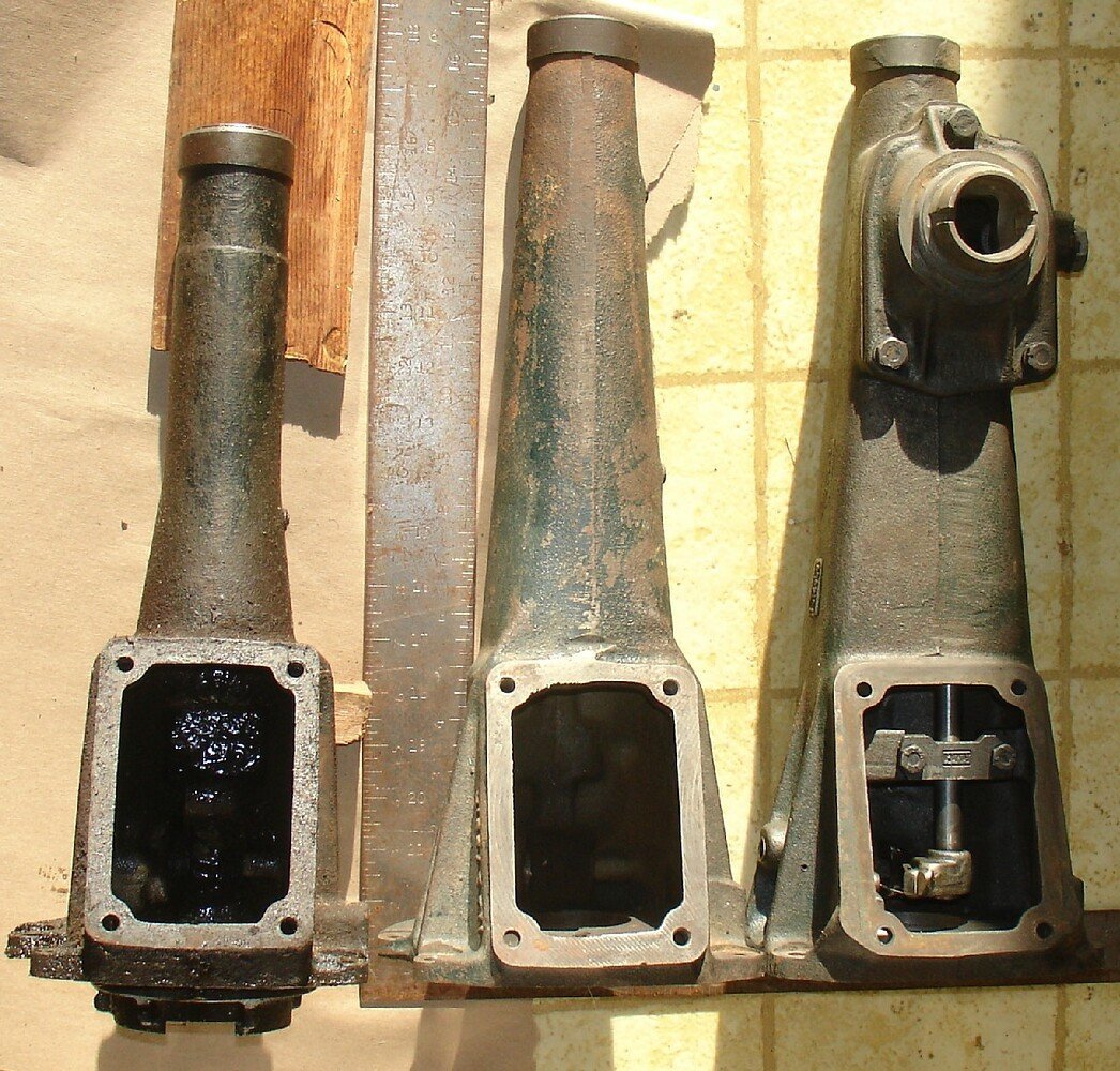

EDIT - as I noted in an earlier post, the reason I'm confident this didn't come from an Elan is the shifter turret location (green).  Elans did not have the tailhousing with that "port" - I'll grab a picture of one and post it, too.
Elans had the shifter turret where the red arrow points.
Older Sevens, like mine, that use (essentially) the same gearbox and tailhousing as the Elan required an add-on remote shifter.  It bolted to the tailhousing where the red arrow it but moved the shifter back to the equivalent of the turret in your picture.  Then, Ford made the tailhousing with the remote turret built-in and Lotus didn't need to the add-on.
My recollection (but I havent looked this up in a while and could be mistaken) is that Ford made the tailhousing with remote built-in for the Escort.
Lotus definitely used it in some Sevens.  I don't have an Elan+2 so perhaps someone can chime in if that car used the remote shifter location, but the Elan did not.
EDIT2 - additional picture - the middle tailhousing is the style used in Elans.  The right has the built-in remote, like yours..  the left (I think) is for the Anglia.

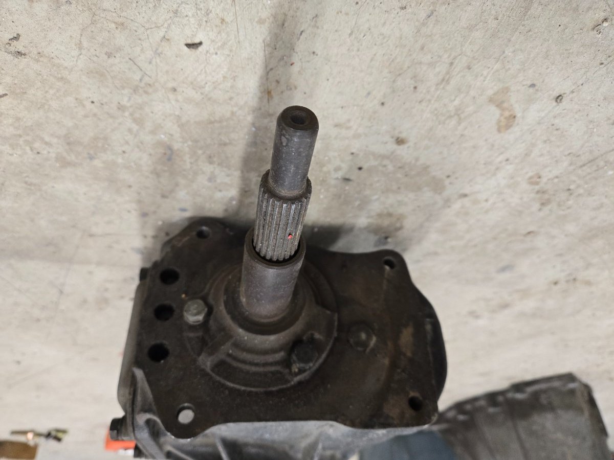

Seems like Henry pretty much nailed the different type of tail shafts. Not sure what your application is, 7 or Elan? On the bell housing per MV8, neither are for a Ford 3 rail that uses the bell housing with an external slave cylinder located in a boss on the right side (viewing from the front) of BH, which is generally used in Elan and 7s. Also to note, those type of BH usually have the starter mount open in the rear to accommodate the starter pinion. On the picture of the input shaft, you will probably need to clean it up and check that its in spec.

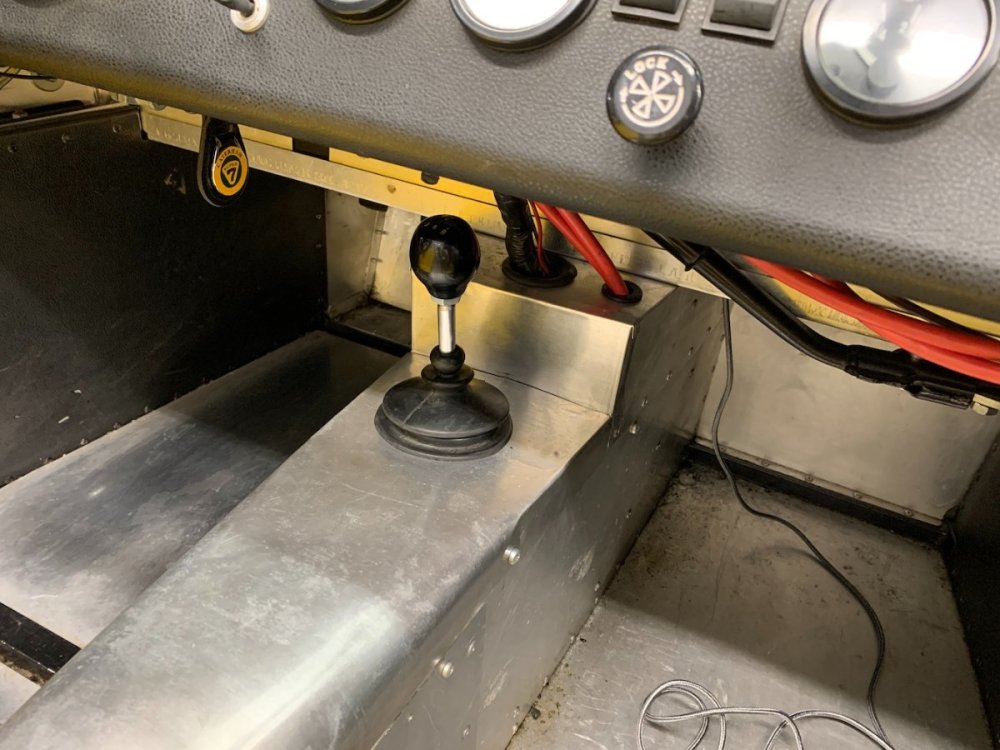

Thanks for all of the input!  Yes this is going in a 7. RM Super 7. With a twin cam from a Europa, and the transmission that I thought was from an Elan, but could have been swapped out for something else at some point.  I will count gears at some point, but it will probably be Saturday evening before I can get back to the garage.  I did purchase one of the early pinto aluminum bell housings and while it fit the motor, did not fit the transmission.  Craig has a steel one for me at a reasonable price, so will see if we can make that deal work out.  But I still have some issue to figure out with the shifter, as this does not seem to come back far enough to be comfortable.  Will reserve final judgment till I can test fit with the proper bell housing, but I don't imagine it would bring it back any further than the other one did.
And that bell housing in the above picture was not the pinto, it was one I knew was wrong, just held the transmission, and was close to the right length, and had to drill holes for the transmission.
You are correct on the shift lever location. It will come out just under the edge of the dash. My car originally had a long lever that was bent to clear the lower edge of the dashboard. It worked but one had to watch one's fingers. I wanted to cut it off but I wanted to be able to reverse the process if the shortened lever turned out to be too much of a reach. (I will tell you now that shift levers for that tail housing are VERY hard to find.) But it works just fine as a little stubby under the dash. It feels like a long reach at first but I got used to it very quickly.
